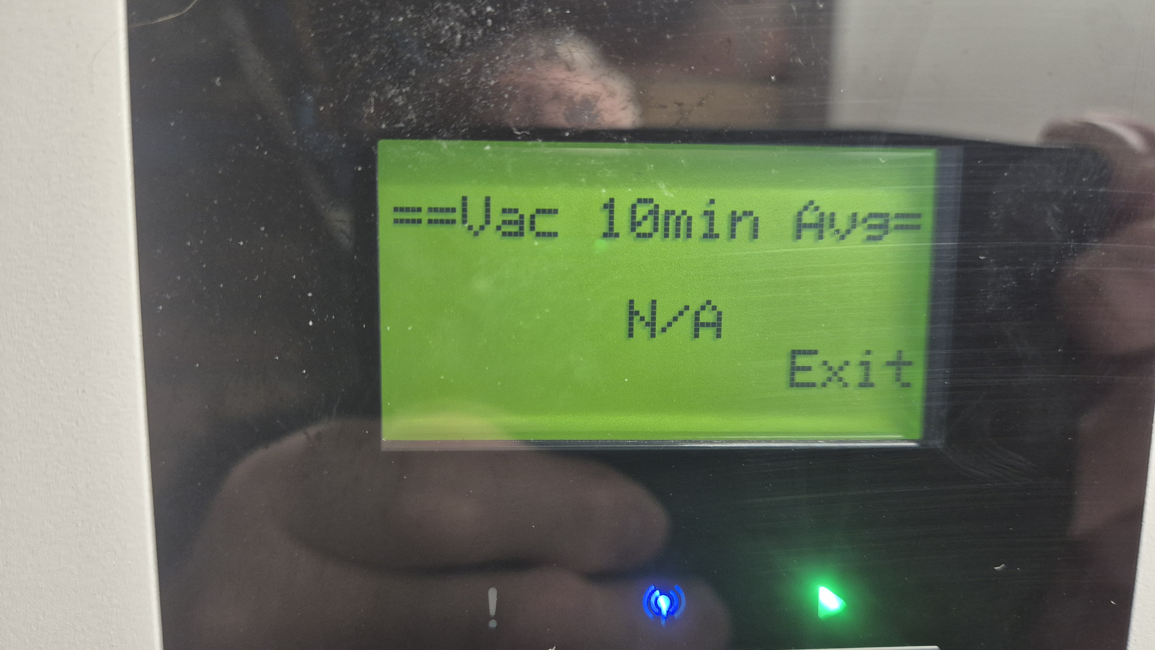

Your grid voltage is too high for the limit set in the 10 minute alarm setting - if you are in the UK you should be able to call your DNO and they will measure it and address it if necessary.
You can adjust the alarm limit, look at the max grid voltage your inverter is reporting and set this limit to be a few volts higher - see this post viewtopic.php?p=668#p668

- Posts: 1872
Don't forget it's a 10 minute average so your peak has to be sustained for it to generate the alarm, I usually advise to set it 1 volt higher than your highest reading which should cater for all conditions.Robgshanahan wrote: Sat May 04, 2024 9:32 pm Very useful thread.
My supplier attended and took a volt reading at 2100, it was 251. He explained that because I am close to the sub and further down the line there is a school the transformer is tapped fairly high to cater for the demand of the school that it can pull. This is why during non peak periods the voltage is running high and this my inverter is going into error 28.
I have upped my voltage on the inverter to 255. Earlier my Pv was running about 1.3kwh and the voltage was around 254.6 so still close!
My question is: what is the highest I can safely run my 10 minute average at and what are the potential implications of running it at a higher number. Say 257 for example.
I have a H1-5.0-E
Thanks in advance
This is becoming more and more of a problem as renewables power the grid, it was never designed for distributed systems putting so much power back into the system (which obviously isn't a bad thing) but it messes with what the DNO has previously set local transformers to. The DNO engineers I have spoken to suggest they are looking for the tolerances to be relaxed and accept that the local grid running at a slightly elevated level is better than running at a lower level.
Back to safety limits, if the inverter is measuring 257V when you are exporting, the grid will be lower when measured outside where the grid incomer terminates on the smart meter - possible up to 7V depending on your internal cable distribution, but more likely 3V lower so 257V is actually 254V at the incomer and only just over the allowable tolerance; if it only happens for a short while the DNO would accept it and likely change nothing.
I really wouldn't recommend going any higher than 260V without taking DNO advice and getting long term logger measurements from your incoming grid, they will do that if you are seeing such high voltages.

Try 3210
I've been having the same problem every day in April - multiple trip outs for code 28. RVolt parameters showed 255 - 259 volts at the inverter. Rang Northern Powergrid who were very helpful and got a man with a meter out within 2 hours! The metered voltage at the grid - isolated from the house - was 240v. The chap said he was seeeing more and more of there situations.
Having established the grid was OK I used the advice above to set the limit to 255v. I may still get trips above 255 but there should be fewer. If I continue to get too many I will set the limit to 259. Thanks to all those who have posted advice!
John
John
Update. Very sunny day today - but only 1 trip, at 255.5v. I may leave the limit at 255 or increase it to 256 if I get more trips. But eight minutes off line is much better than the several hundred minutes before I adjusted the limit. Once again, many thanks indeed to all who posted advice and how to.
John
John
