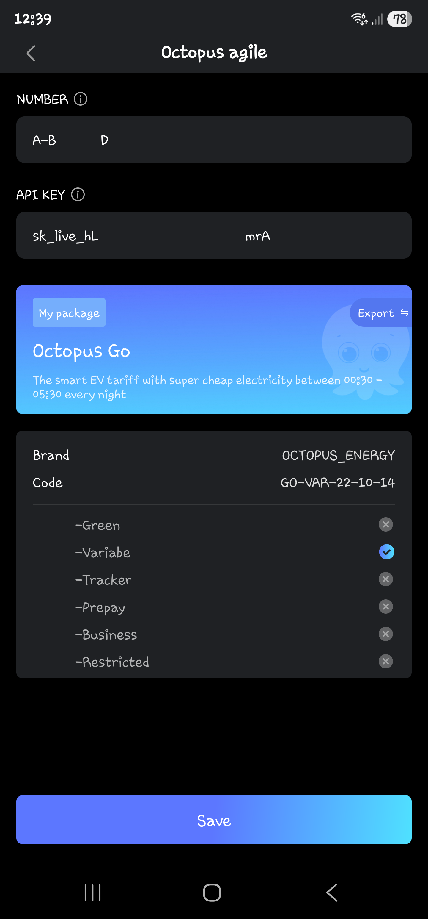

Here is an example image of how the two inputs should look (sorry if you have tried this and had no luck)
Octopus Account Number
Then API Key
I think it was adding an invisible space on end of API key, or account number.
Then API Key
