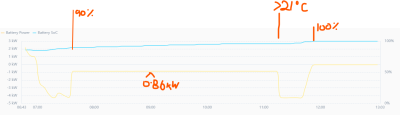

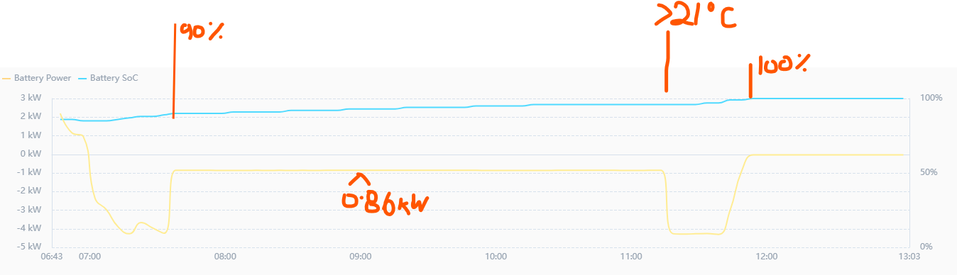

Hi rt1000
Not quite the same, but similar limits around 21 degrees.
Less than 21 degrees and less than 90% SOC - charge will limit to 4.25kW. (less than 15deg is ~2.25kW)
More than 21 degrees and less than 90% SOC - no limits. Full inverter load (up to 10kW).
Less than 21 degrees and more than 90% SOC - limited to ~0.86kW until 100% SOC.
More than 21 degrees and more than 90% SOC - limited to 4.25kW. Slight ramp down as normal approaching 99% SOC.
I've run a few deep discharge cycles to test out the range of charging at different SOC's and temperatures.
Excuse the crude mark up!
21 deg is fairly conservative to cut charge rates that hard and will limit the batteries benefits in cooler months - so hope FoxESS can adjust the BMS settings when they come out and "run some tests" soon!
