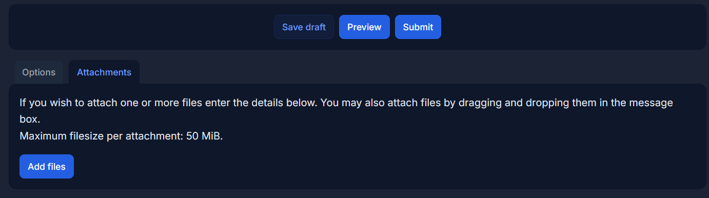

Clive01 wrote: Mon Mar 09, 2026 9:11 am I would have put a screenshot but cannot find how to do it on this forum.
When you begin writing your post, you can find the 'Attachments' tab just below the buttons for 'Save draft' 'Preview' 'Submit'

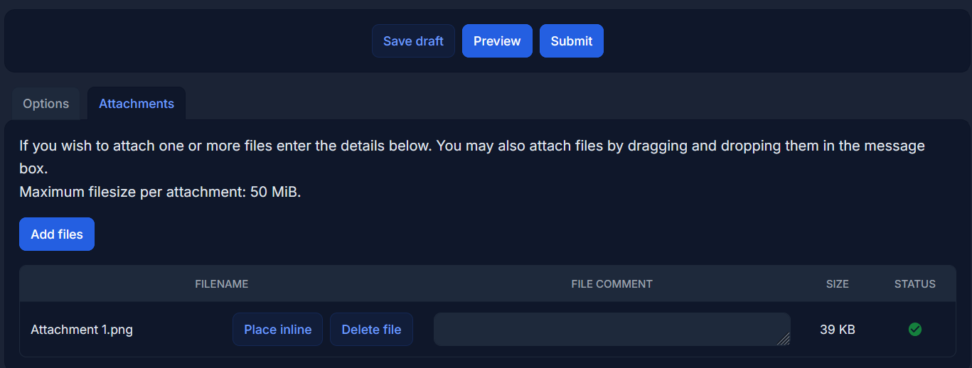

Once you have found the image on your device, you can press the 'Place inline' button and they appear in your text box above (where you are typing in your message)
Tip: You can press the Preview button as many times as needed to see what your post will look like, then Submit when happy.
Tip 2: If you post, and make a mistake, then you can press the cog wheel top right corner of your post, and select Edit to make adjustments.

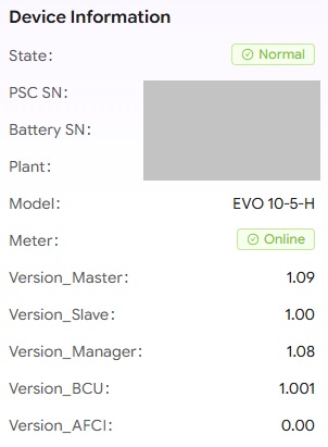

Can you both find out what firmware your systems are running on, and compare to the list Will has made?
viewtopic.php?p=8069#p8069
I am guessing it's the EVO (812) at the top?

MaterialBarracuda48 wrote: Mon Mar 09, 2026 10:09 am firmware
Mine says...
Re: New EVO 10-5-H only charging at 1.06kW
They look current versions then for you, it must be some back end configuration that needs looking into by Fox/Installer.

elljay wrote: Mon Mar 09, 2026 10:22 am
Mine says...
Mine is exactly the same as this!
