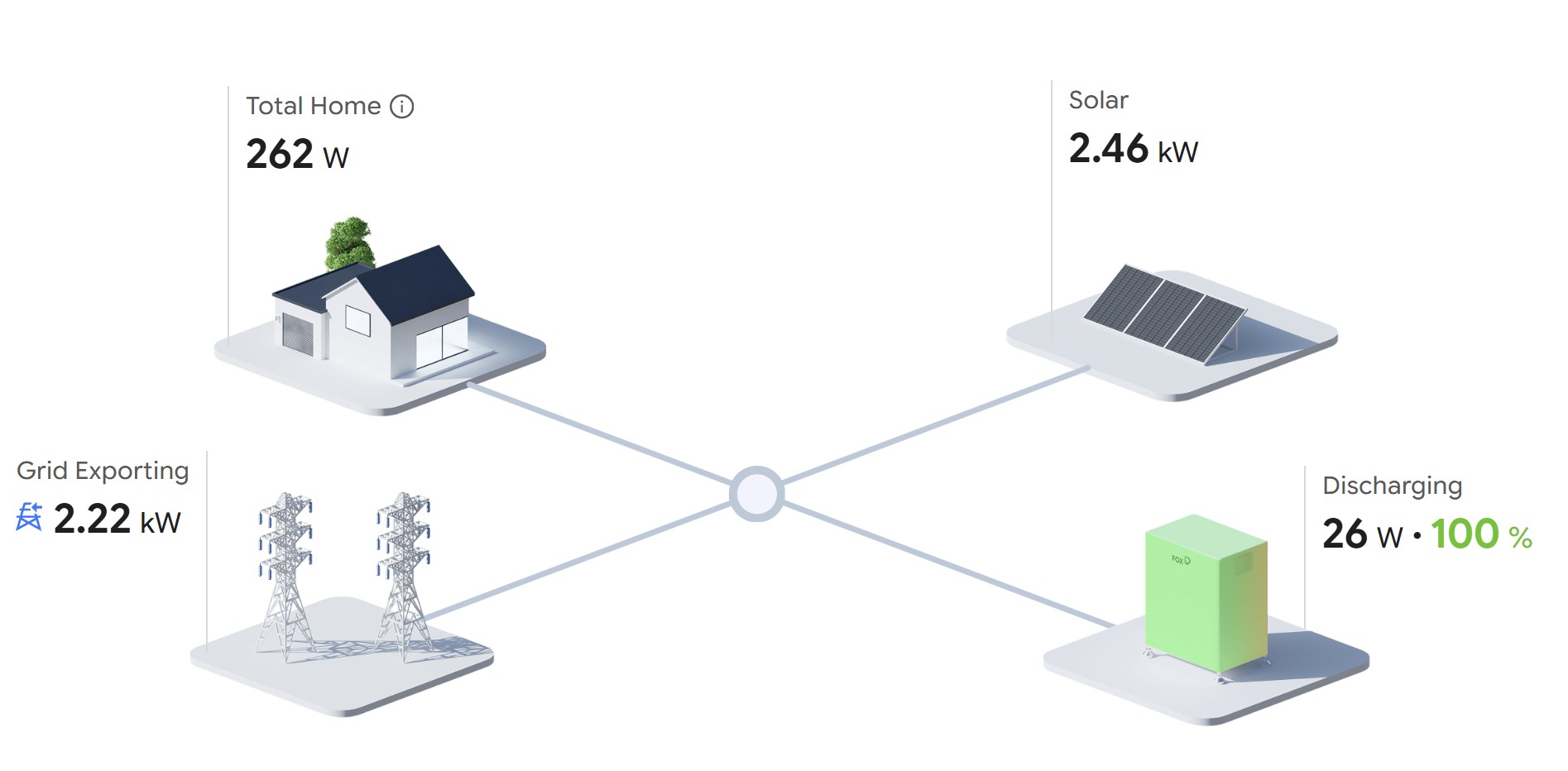

why is the battery discharging
another anomoly??
PV producing 2 1/2 kW
house using 260W
exporting 2.2kW
....so why is the battery discharging ?????
FOX KH7 7kw hybrid inverter
EN-EPS-BOX-SP gateway
Re: why is the battery discharging
The battery is full, so the PV energy has to go somewhere.
So it goes to the grid.
When the battery is at 100% SoC, depend on your program running, it will either HOLD at this value, or begin to slowly discharging. The battery doesn't like being at 100% for too long, so if it was in self-use mode it would drop down to around 95% and cycle back up to 100%
Ah right, that makes sense.....although the battery isn't really at 100% as its actual capacity is 11.6kWh with only 10.4 available at 90% of 11.6 to allow the user to think it is 100%
Yes, having dropped a bit it is now at 94% and charging again.
