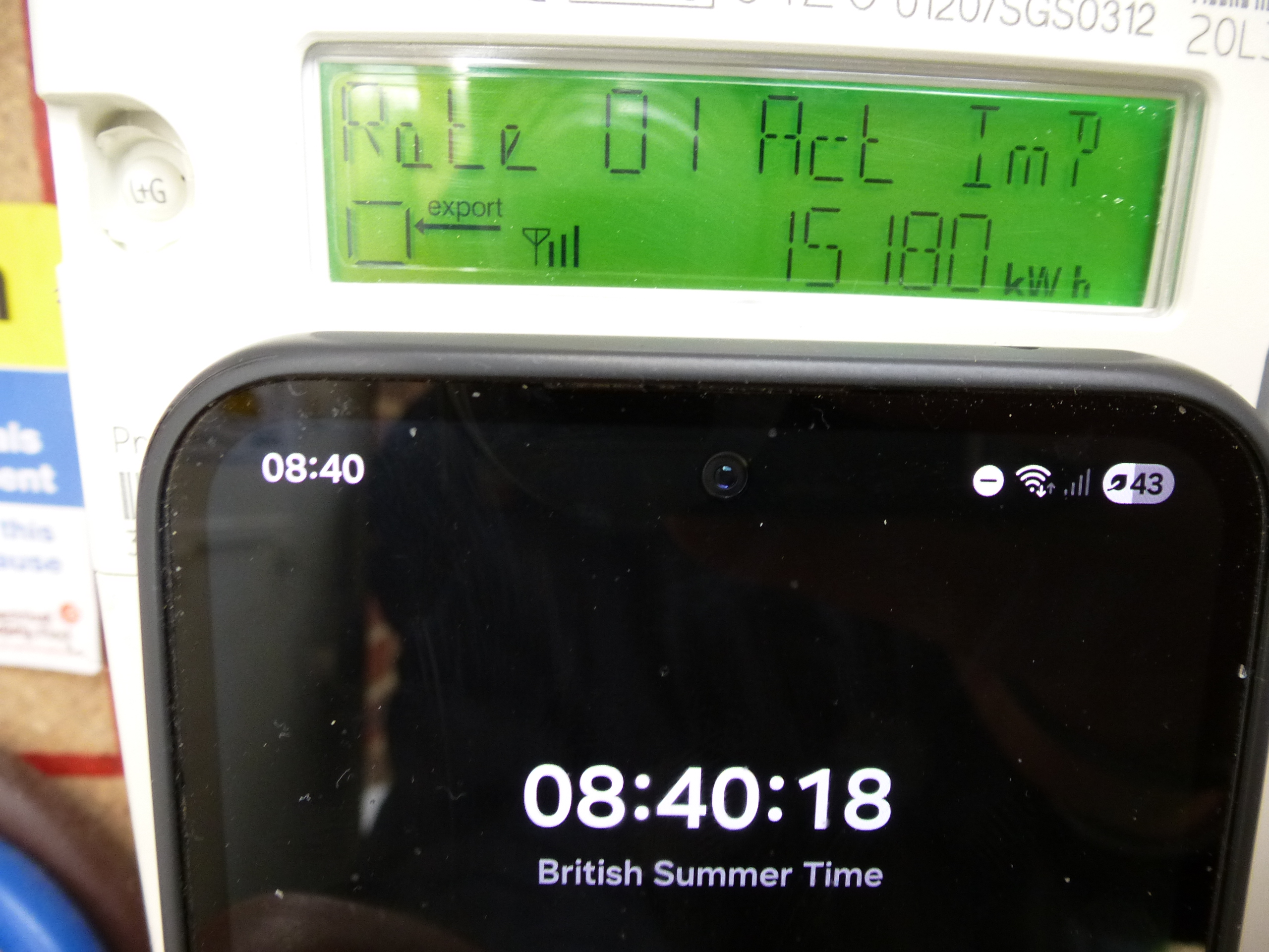

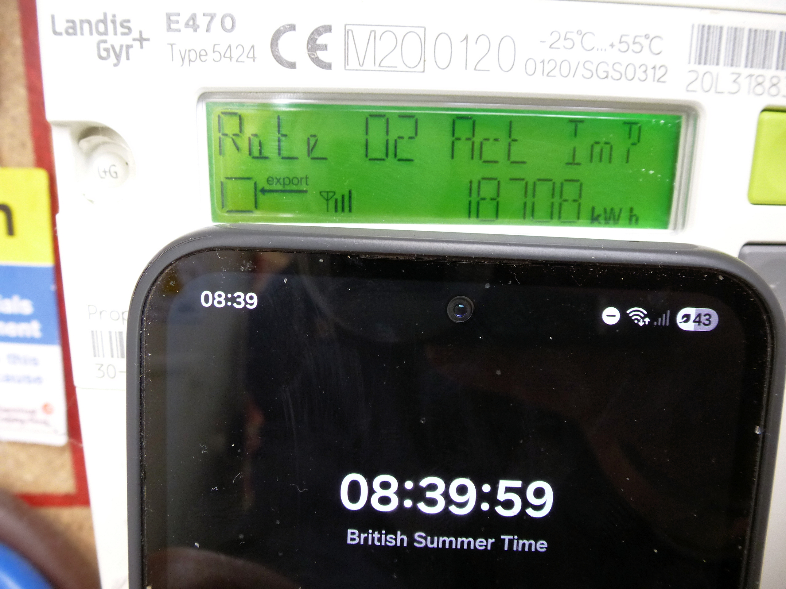

This I recorded this morning, showing the changeover from Off Peak to Peak rate at 0840. I am waiting to see if Octopus can explain why the offset is there. I am not sure if makes much difference to the billing?

From my understanding, the clock and tariff should have been updated by now. Suspect given your 10 min clock drift that they need to push this from their end.
Chase Octopus about doing this and see what they say.
