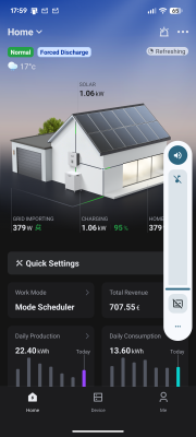

Manager 1.73 / Master 1.55 offered today and (gulp!) installed.
No issues as such (although oddly after install battery discharge ramped up slowly ). However the Forced Discharge SoC limit revert to grid import issue is still present .

When I updated, like before, when FDSoC was met on discharge, it switched to Home Use from Grid Import and Solar panels charging the batteries. I haven't done any restarts, just updated the two firmwares.

When I updated to Master v1.57 and Manager v1.76, like before, when FDSoC was met on discharge, it switched to Home Use from Grid Import and Solar panels charging the batteries. I haven't done any restarts, just updated the two firmwares. So, no improvement.
