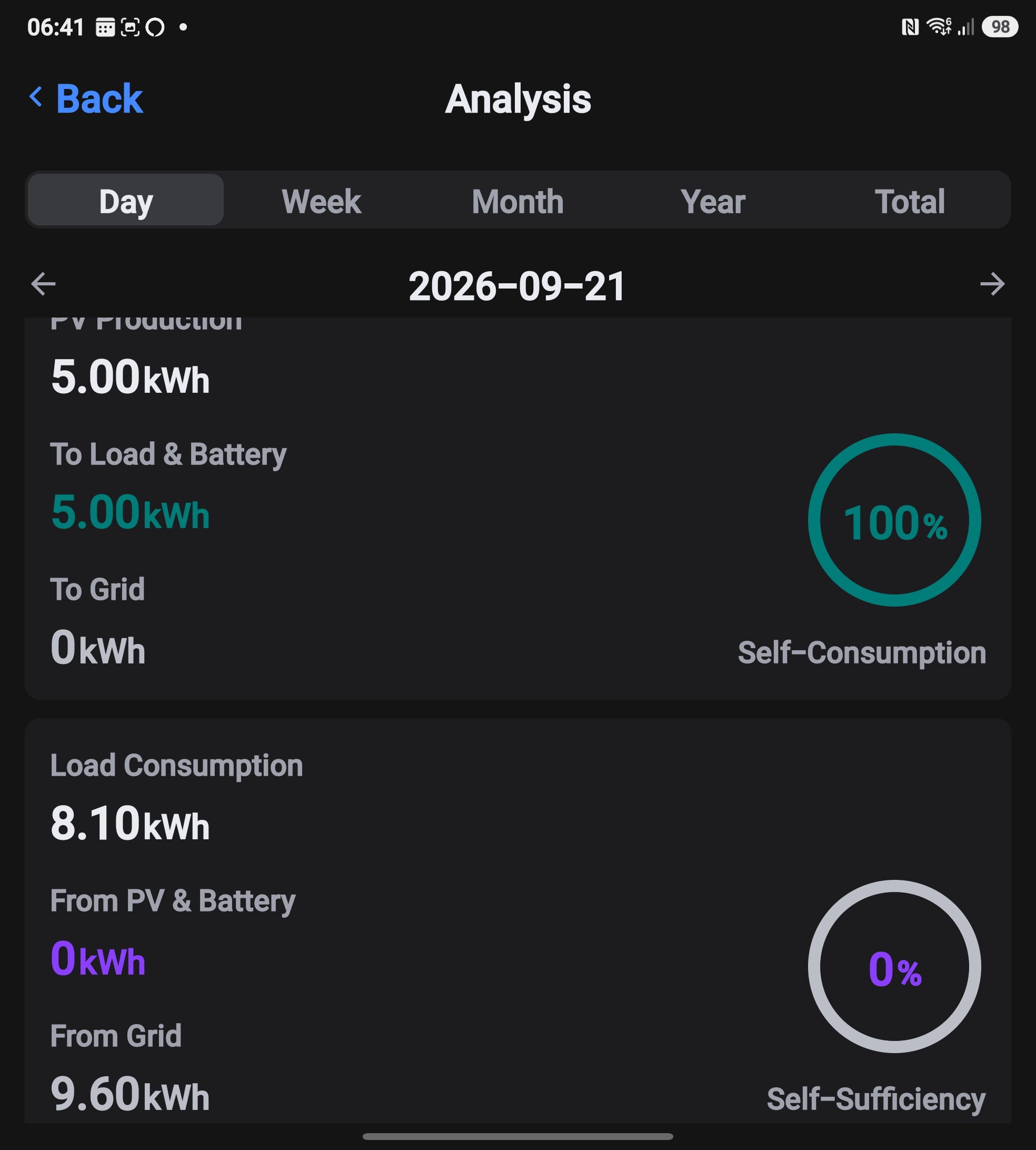

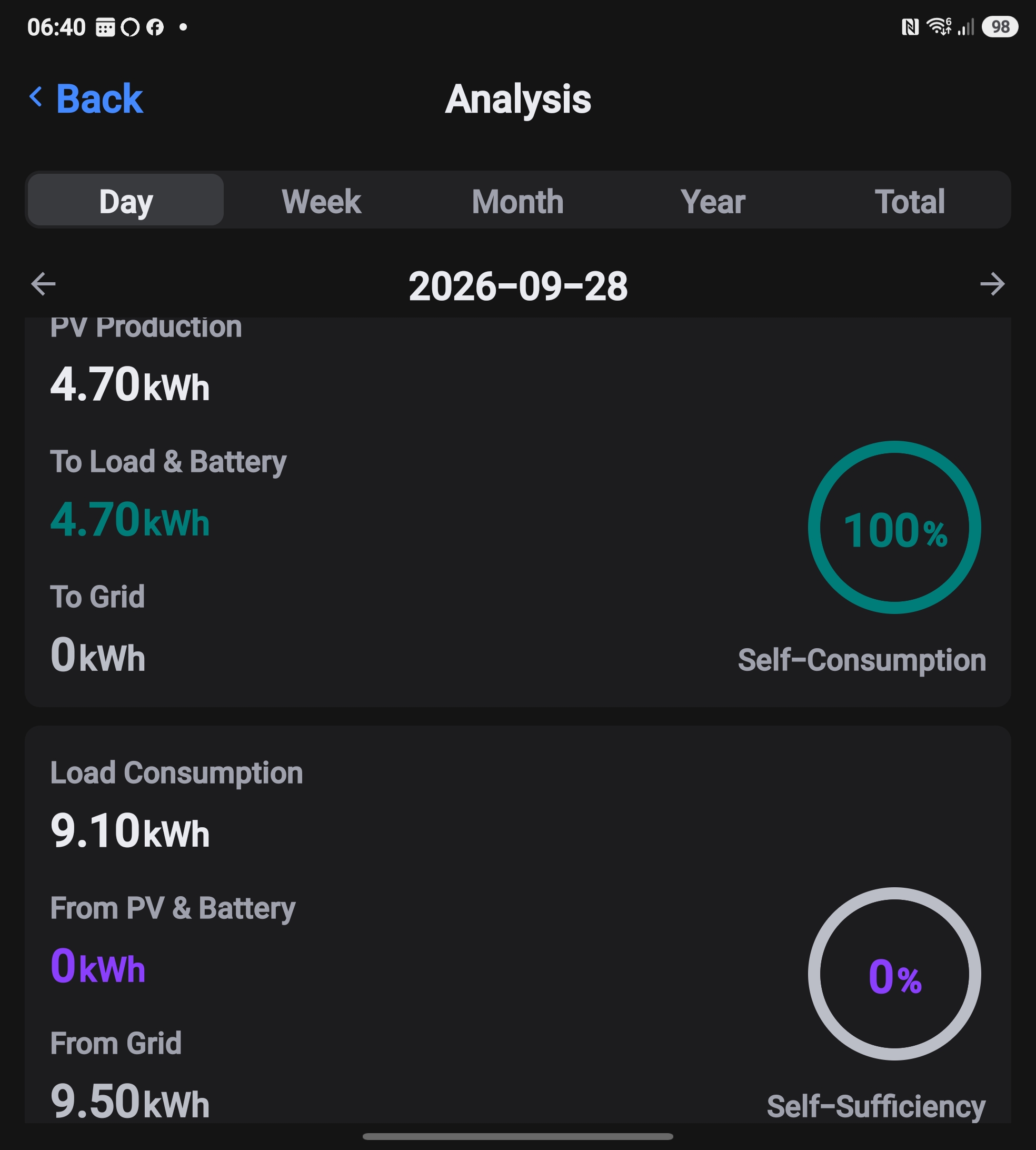

I am trying to take as little from the grid as possible so all configured around self use however yesterday according to the app I generated 4.7kwh and load consumption was 9.1kwh with supposedly 9.5kwh coming from the grid. It says I was 100% self use so shouldn't the 4.7kwh generated and 'self used' mean that I only consumed the difference from the grid.? This has shown twice now and I am worried there is a problem with the install.

Odds are your CT clamp is reversed, so it is taking readings wrong.

Is this only seen on days when 'From grid' exceeds 'Load consumption '?
I see that as well, but have always just blithely assured that it was an artefact of the app. I can see from the power graphs that load is being met by both PV and battery discharge once forced charge period ends.

@Daveg The one thing that seems to stick out is the battery supplied 0kWh during both days, you would think some would be used during the night.
Anyhow, a few graphs should show us where the power is coming and going from.
