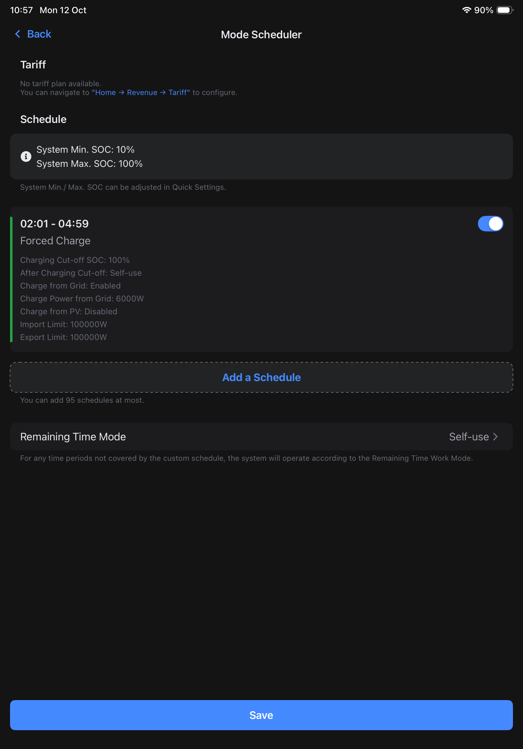

We have a Fox Ess EP12 11kWh battery and have just changed our tariff with Octopus to Flux. We have set up a schedule to take advantage of the cheap electricity between 2am and 5am. The problem I have is the charge power from grid value always defaults to 6000 no matter what value I put in and I don’t know why.
Can anyone help me please and put me out of my misery.
Thank you
It is likely your inverter firmware doesn’t support that feature - check your Master/ARM/Slave versions against the latest firmware table and upgrade it if it is old. https://foxesscommunity.com/viewtopic.php?t=1927
