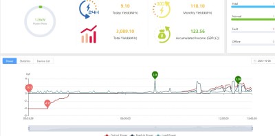

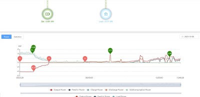

Until recently I could get full information on the status of my battery. This has now changed . Originally the graph showed output power, feed in power, charge and discharge power. Now it only has output, feed in and load? What is load?

Load is the amount of power being used by the home itself.
There are 2 ways to view graphs on the website, the first is shown when you log in and look at the 'overview page' and shows the house load

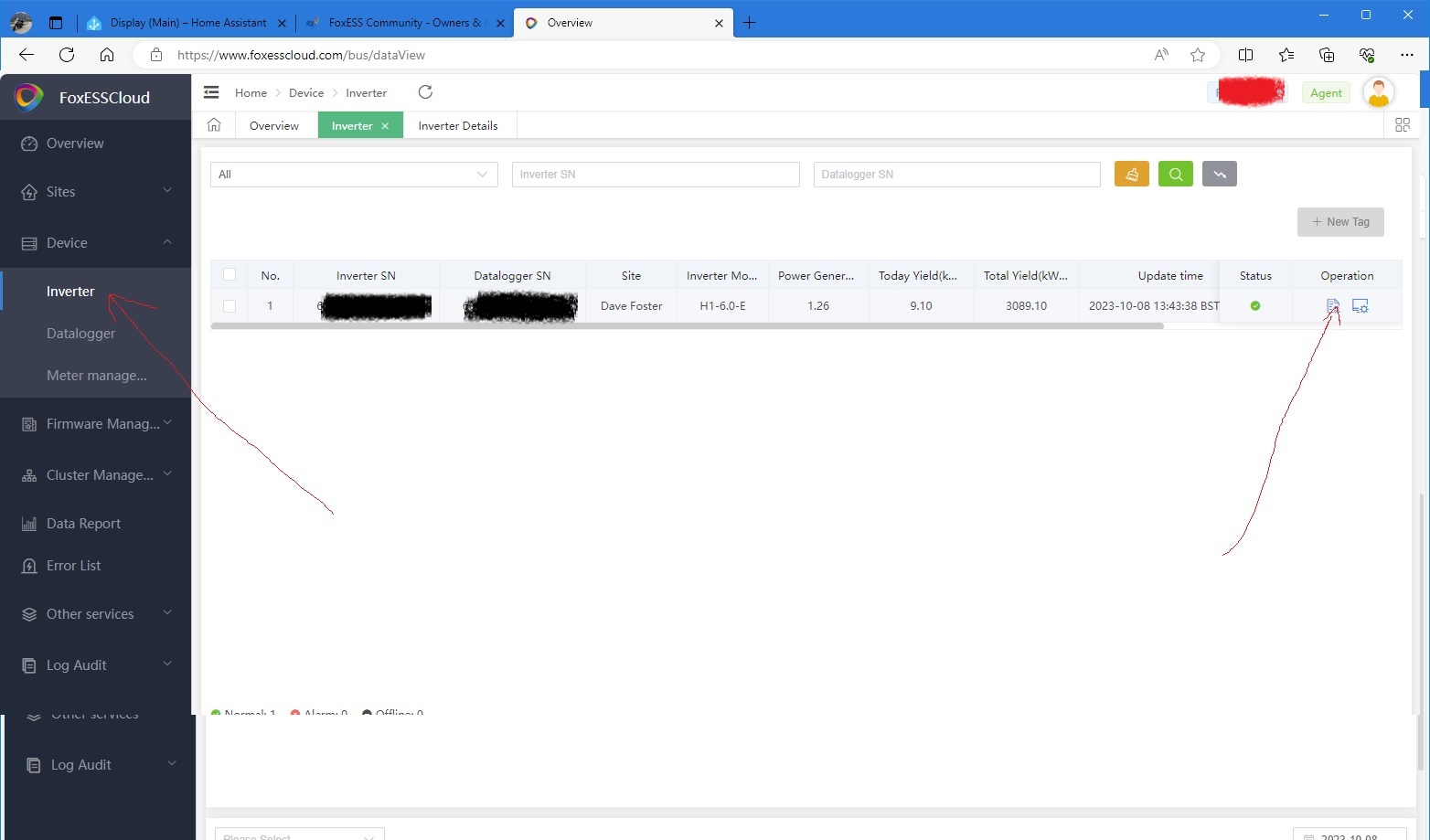

If you click on the 'Device' in the left hand menu column, select Inverter and click 'View' in the operation on the right hand side of the inverter information - it will show you the graph you originally describe
shows this graph
hope that helps
Re: Change of foxes cloud website information
Many thank, back to normal now.👍
