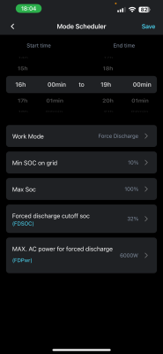

Hello, my installer set my battery to force discharge after I joined octopus flux. Battery discharges quickly within hour but after that it starts charging from solar rather than send it to grid during peak flux.

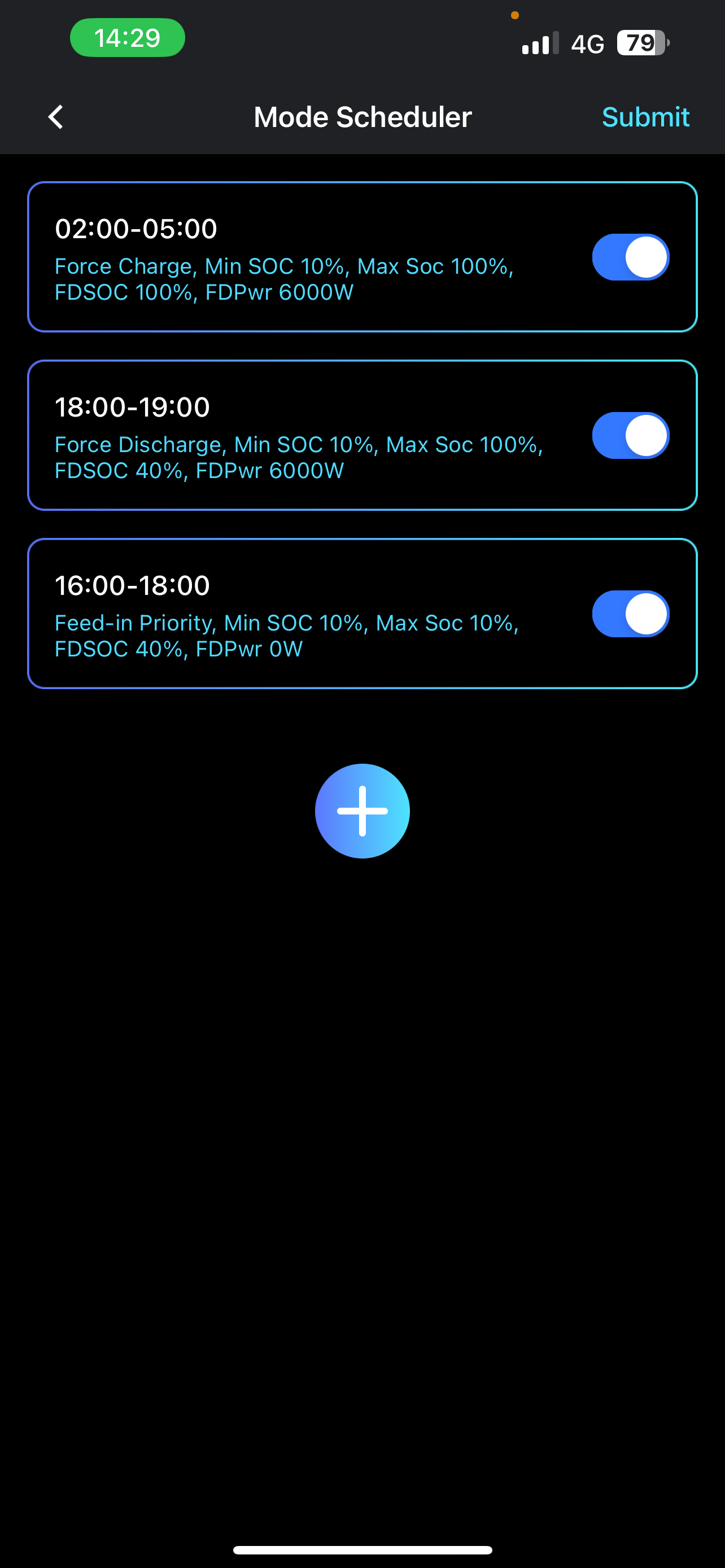

If your battery discharges quickly, you might be better from 4pm to 5:59pm setting 2 items in your schedule, the first one would be to set the inverters work mode to 'Feedin First' - that will export everything you are generating (after the house load is covered) and will only charge the battery if you generate more solar than your agreed export limit (G98) which is unlikely.
Then have the second schedule item as it is now with the start time set to 6pm to 7pm and force discharge your battery.

Thank you for your reply, I have set it up like this now. Will see how it goes.
