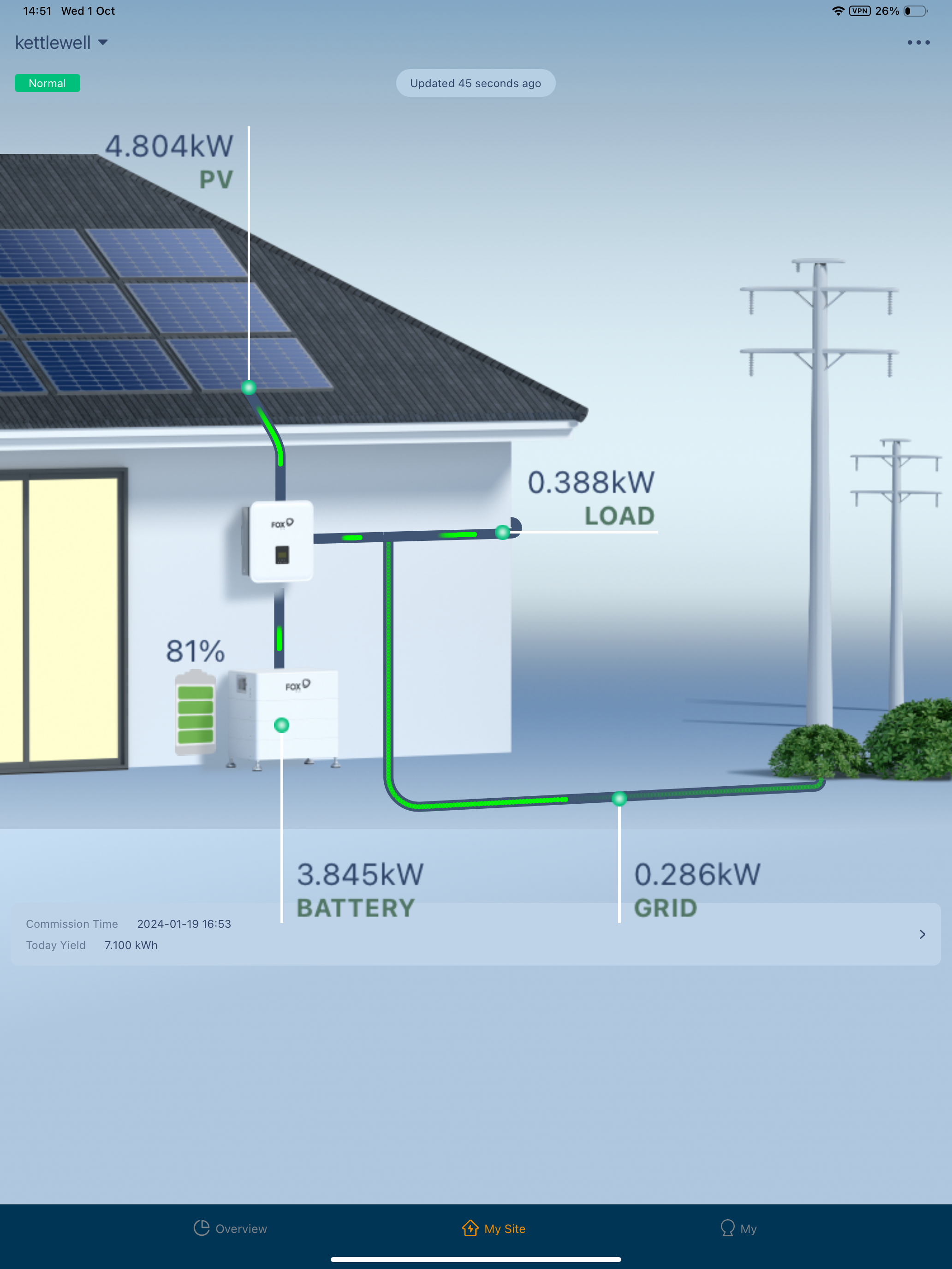

On the app, can you post the overview page when you have turned the heating element on (it takes 5 mins sometimes for the app to show it) and if you could swipe left from that page and screen shot the graph at the bottom of the page - just trying to work out what could cause that i.e. battery performance or similar.

The app screen changes between about 4500w and 400w load. But mostly stays at the lower figure. Even with heating element reporting full power - which should be 2900w. This is a replacement boiler, both had same issue hence why I’m checking the supply. Boiler has a pid controller but I’ve checked and it is requesting 100% power. Have joined FB group. Will try William

I can see you are using the old Foxcloud app, that app is no longer supported by Fox and the new one is a huge improvement - if you search for Foxcloud2.0 that is the new app and will give you a lot more information - not least the graphs show all the information together to see how load, battery, grid is being used .
