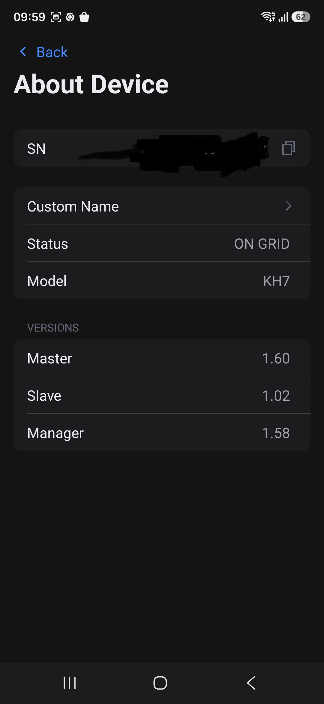

@spiral: What inverter model and what inverter firmware (master/manager) versions do you have? Its possible your inverter firmwares may need updating for these options to be functional.
Manager(ARM):1.78
Master:1.59
BMS:1.013
Re: Force discharge not working correctly
nrb501 wrote: Sat Jul 18, 2026 8:53 am @spiral: What inverter model and what inverter firmware (master/manager) versions do you have? Its possible your inverter firmwares may need updating for these options to be functional.
Cannot find anything in app that tells me either of this information. Could you please point me to where I'd see it.
Edit: Just found it on website, not sure why its not visible in app anyway its a KH7 with master version 1.60 slave version 1.02 arm version 1.58
To find the information in the app you need to go to the following;
Devices > Inverter > Click on the serial code of the Inverter > should show your details in there.
Same process for the battery and WiFi dongle.
spiral wrote: Sat Jul 18, 2026 9:50 am If I'm only running 1.60 of the master and you're running 1.69, there must've been 9 updates since my last one and I can't see any available. Where should you see them because even if 1.69 was pulled, presumably I should have 1.68 available.
Fox are a little bit like, "one, two miss a few" so FW versions do tend to jump. They might test/add features in between, and also can "upgrade" your FW during issues to 0.xy versions. Usually baked quickly to fix some error they have introduced.
If you follow Geekbytes directions, there is where you can find if you are running the latest, or if they have removed the upgrade possibility.
Click on your Inverter in the FoxCloud2.0 App and get up version information, and post screenshot here if you can please.
It looks like they have turned off FW upgrades for a bit.
When working properly, you should see (Latest) or a (1.70) next to it.
In the forum, we have seen these versions posted.
Master 1.64, and latest is 1.70
Check once a week in the App for upgrades, or email service.uk@fox-ess.com with your Inverter serial number and tell them you are missing the feature to revert work modes once the desired SoC has been reached.
For the KH series, the latest versions available to agents/installers for download are:
Master - 1.70
Manager (ARM) - 1.66
Slave - 1.03
As suggested above, your best bet is to email FoxESS to get upgraded.
It does seem that the user's ability to perform inverter firmware upgrades has been pulled at the moment, datalogger updates still seem available.
