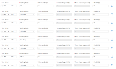

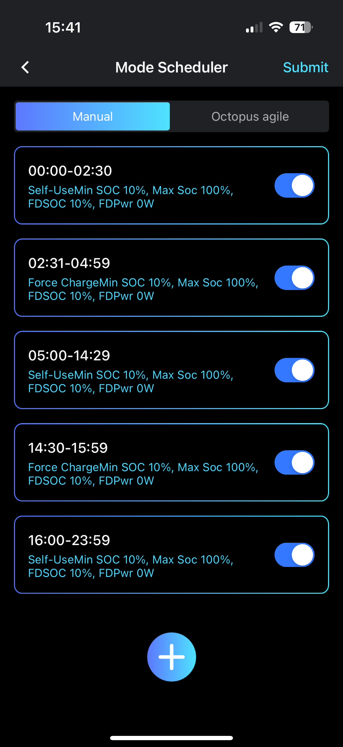

The issue I'm still seeing is this :
PV output is clipped to 0kWh issue when Battery SoC reaches 100% DURING a force charge period (only matters in daytime - when there is PV output of course!)
Battery remains at 100% SoC (as it should) but house load is then taken from the grid and available PV output isn’t used either for house load or export.
This remains so until the mode scheduler changes again back to self use from Forced Charge.
However - If the battery is ALREADY at 100% SoC before a force charge period starts then PV output isn’t clipped to 0kWh but battery is maintained at 100% SoC during the Force Charge period by PV output and/or draw from grid.
If I switch off the force charge period manually in FoxESS App V2 the PV output immediately reverts to normal (I can see this in real time via ModBus/HA) - house load first and then export to grid of any surplus. If I switch it back on the bug/issue is there again - i.e. PV output is clipped to 0kWh again.
Surely I should be able to "set and forget" an afternoon topup - especially at this time of year when PV output is so variable without losing a couple of hours of export if the battery has already charged through earlier self-use on sunny days, or only needs a small topup at the start of a Force Charge period??
My system was only installed in February so I don't have much history data to fall back on but as far as I can recall this issue didn't occur prior to the updated firmware release with Octopus Agile integration...
This is how I believe a Force Charge period should work :
When Force Charge period starts:
Battery charges using any available PV output plus draw from grid until it reaches 100% SoC - house load also maintained from this mix of supply by the inverter
When Battery reaches 100% SoC it's held there there until the Force Charge period ends - and any available PV output is used first for house load and any extra is exported to the grid - if there is insufficient PV output (night time or bad weather days) house load is taken from or topped up from the grid.
Am I correct in thinking this is a bug/unexpected behaviour or have I misinterpreted what should happen please?

Thanks Dave - that matches my experiences at least.
I use Force Charge windows as above to load shift, as my PV and battery aren't big enough to meet all of my demand on low PV days.
The afternoon force charge window is there (on Octopus Agile) to ensure that my battery is at 100% SoC before the "premium prices" start at 16:00 and to cover me through the later afternoon and evening. The intention is that this is only needed when self-use before 16:00 hasn't topped up the battery to 100% SoC. Grid rates from 14:30 to 16:00 tend to be the lower for day rates on Agile. It's largely redundant on good PV days and there's no issue if 100% SoC is reached before the Force Charge window starts - only if it is reached during the Force Charge window so I lose any export until 16:00.
Inconsistent behaviour at least - which leads me to believe it's a bug/lazy coding issue.
I have HA set up for monitoring and may just have to bite the bullet for control too......

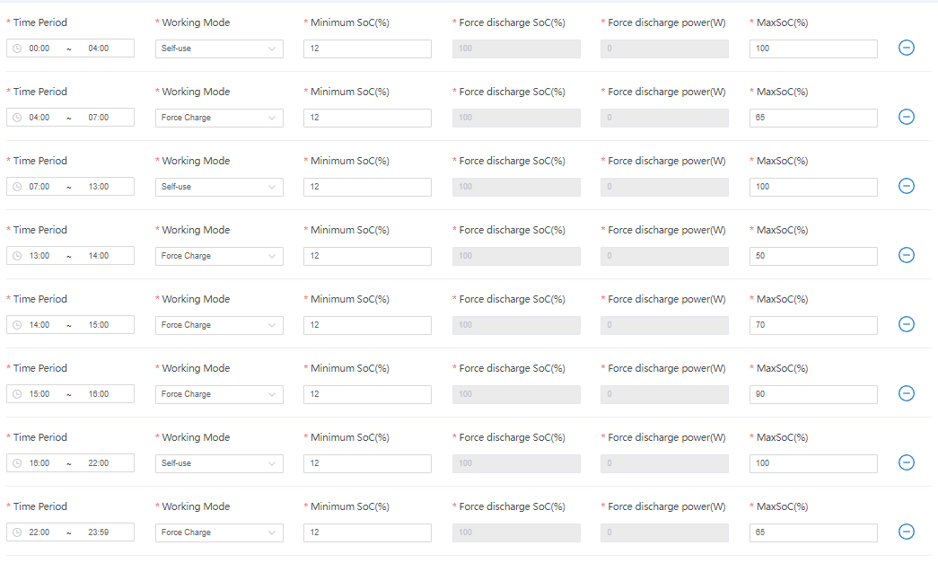

Fox UK updated the Inverter for me and I've now got new column MaxSoC(%). (Previously I was trying to make it work with just the Minimum SoC(%) column.)
I wanted to use the mode scheduler to better use the Octopus Cosy cheep tariff (UK )(04:00-07:00, 13:00->16:00 and 22:00->24:00, with the expensive time 16:00->19:00)
But also still use the solar if it was a sunny day (i.e. Autumn and Spring). - 04:00-07:00 - Force to 65% (65% should see me through to 13:00 if the sun does not come out)
- 13:00-14:00 - Force to 50% and let the sun charge more if available
- 14:00->15:00 - Force to 70% and let the sun charge more if available
- 15:00->16:00 - Force to 90% and let the sun charge more if available. (90% should see me through the expensive 16:00 to 19:00 period)
- 22:00->24:00 - Force to 65%

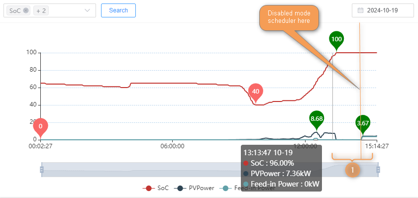

I could see the solar clipping while it was charging. See (1) bottom right. I disabled the mode scheduler, clipping stopped and exporting started! This is a screen shot that should highlight this.
I assumed a gentle ramp up of the battery charge would best get me ready for the expensive period but I might time how long it takes to go from 12% -> 100% and set a mode for that to minimise the period that exporting is stopped.
Fingers cross they fix it soon!
