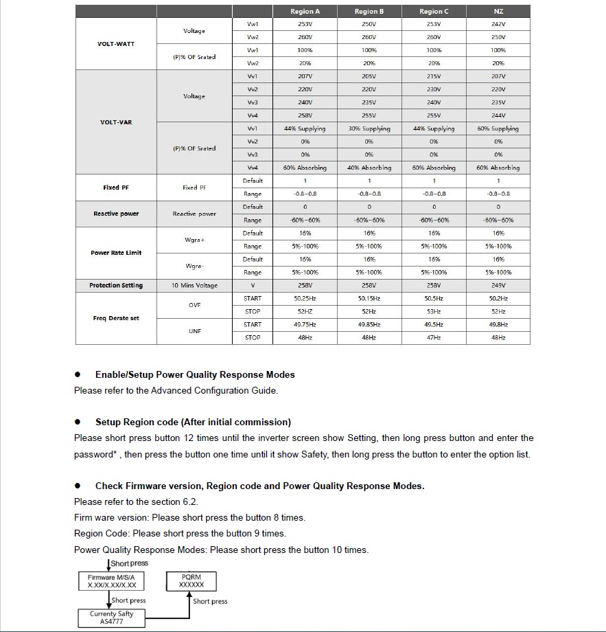

Well my unit keeps dropping out due to high volts so I'm wanting to lift it from presuminly 252v to 255v
Now I go into settings and looks like I can only choose from a bunch of national standards. Mines set on AU
Wondering if NZ or another country has a slightly voltage set point.

NZ wouldn't help, but check the settings for Region code as region A would be best.
If you have a datalogger attached, contact your Fox service they may be able to lift the upper limit for you.

Ive seen that in the menu.
But I can't see that option I have as, NZ, Vietnam and a few other standards it mentions.
