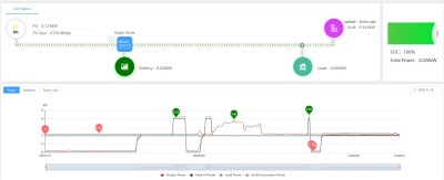

From the V2 app can you swipe left on the main house screen and post the graph at the bottom that shows load and battery soc.

If you screen shot the phone screen you can then add it as an image here, the app shows the key relationships on one graph (load, grid, battery charge, discharge and solar) you can't see all of those on a single web page graph.
But looking at the trace you posted it is showing a negative load and I wouldn't expect to see that - do you have anything else that is taking load like an EV?
