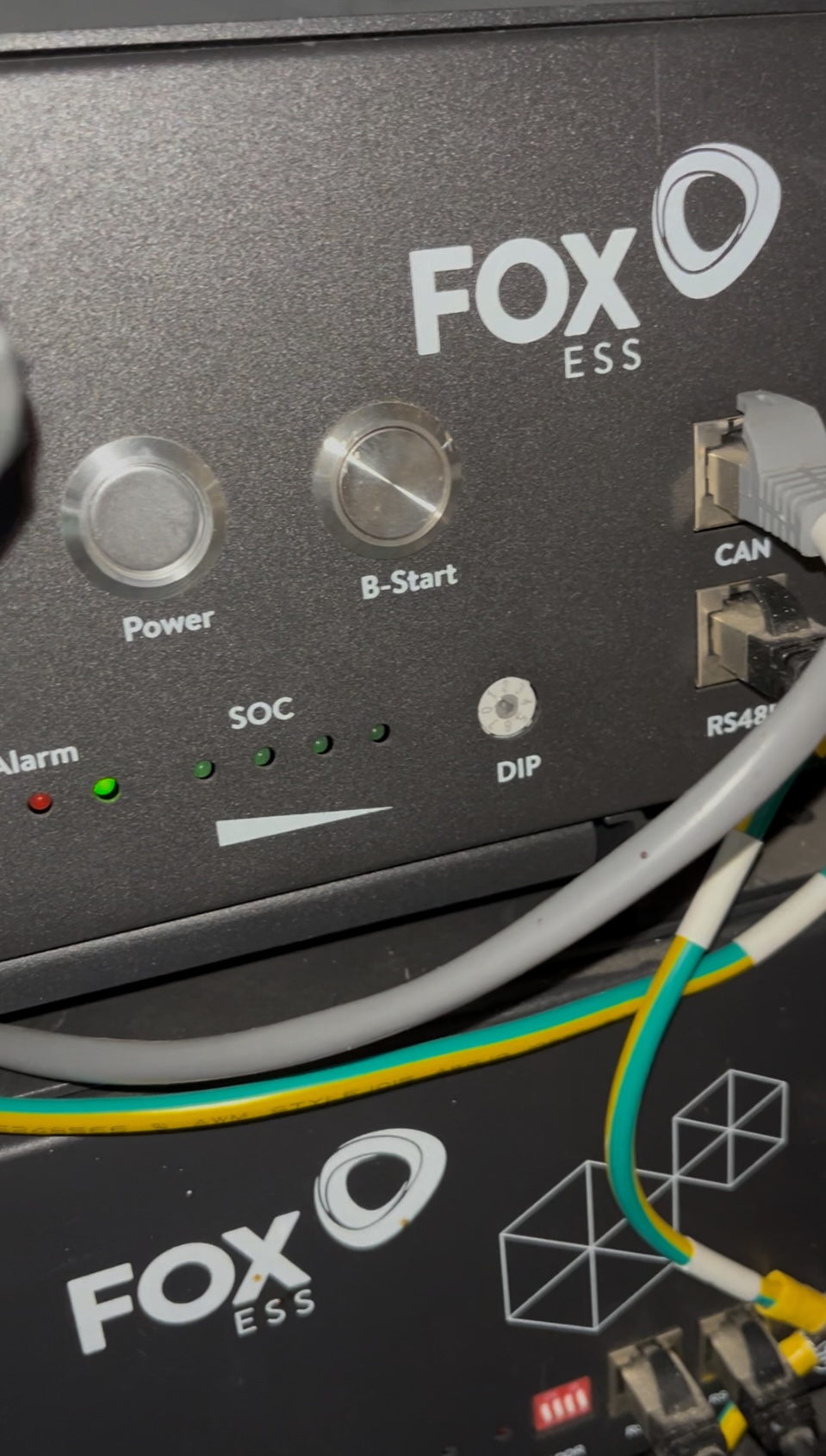

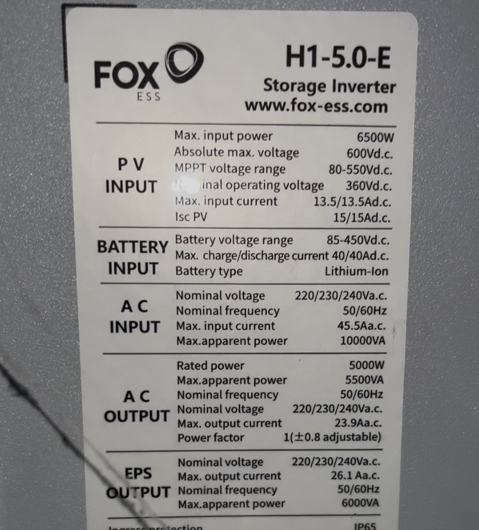

I’ve been under the assumption that my set up was 6kw, apparently the solar panels are but by the look of these pics I have a H1 5.0 E which I gather isn’t a G2 version
And my batteries look like they’re v1 too
Looks like I’ll have to sell these to upgrade

No it's not a G2 you can tell from the max battery volts (450V) - the G2 is 480V
The batteries I can see are V1 which show as Ver C or DC - if you are going to sell them, put them on eBay and post over on the facebook group https://www.facebook.com/groups/foxessownersgroup with a link to them I don't think you'll have much trouble moving them on.

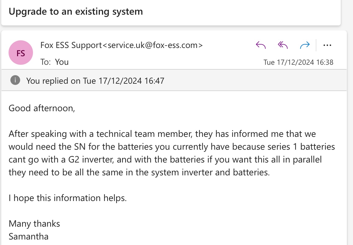

Just had reply from FoxESS, they’re saying hv2600 v1 version D won’t work with G2?Dave Foster wrote: Tue Dec 17, 2024 1:15 pm Yes that would work, the batteries just have to be similar in total capacity
- Posts: 1850
Oh boy you can’t make it up, the HV V1’s absolutely do work with the G2 inverter - there are hundreds of systems out there with V1’s and mixed V1/V2 packs.

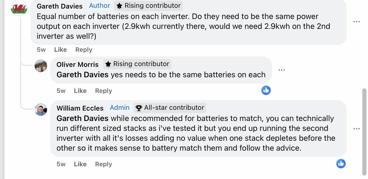

On running in parallel that sounds like a lazy answer - if both inverters have similarly spec’d battery stacks it will work, it will work even if they are slightly different i’ve seen that working on a system in South Africa (also see attached from Will) - It’s possible Fox have changed guidance because of issues in the field - obviously you don’t want to breach warranty but I would definitely get that confirmed in writing.
