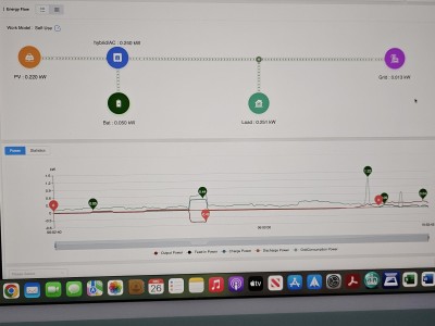

I attach a screenshot of the Fox Cloud system details that shows very minor discharge (0.05kw) from the battery which seems to be the maximum that it will discharge at the moment.

Yes, the charge periods are both set at 00.00.
Just to be absolutely clear about your comments on the battery reserve and system minSOC are you saying that both the min SOC AND min SOC (on grid) should both be at 10%? I had the min SOC (on grid) at 100% which mirrored the settings in a video showing how to set up force charge periods etc..
I have just checked the lights on the BMS and batteries. The BMS is showing Power "ON" as constant green light. The four other green lights flash on every 4/5 seconds as do the single green lights on the batteries.
For the record I had a major issue with the batteries not discharging shortly after my system was installed in the spring of 2022. Indeed, after a great deal of pressure on my part Fox eventually agreed to replace the BMS and batteries. Since then the system has been working well until earlier this month. During the period in 2022 when I was experiencing discharge issues I was told by the supplier of my system that a temporary "fix" was to simply reboot the BMS by turning off the Power switch and moving the BMS DC switch to the off position and then turning it back on again in reverse order. Is it worth trying this before a full whole system restart (which I am a bit wary of doing)?
Thanks,
Leedslad
- Posts: 1850
Yes minSoc on Grid should be set the same as minSoC unless you have an EPS system installed (i.e. backup in the case of grid failure).
