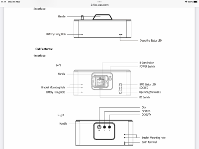

2) You haven't said which battery packs you have (HV, LV, Mira, Cube) but yes if you don't rely on the grid to charge your batteries on a low tariff you can turn off the batteries (Foxess recommend you do this in cold weather), there is no software option you will physically have to turn them off by pressing the power switch and opening the DC breaker on the battery/BMS packs.
Can you please explain item 2 above. I have cube battery and cannot see a power switch
