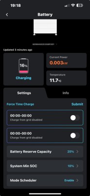

(1) set a forced charge from 0200-0500. I cannot set a Force Time Charge on the battery screen. It tells me "Unsupported Function Code". I think I have successfully used "Mode Scheduler" to Force Charge during this time - I will have to see if it works tonight. I've got Min SOC on grid and Max SOC and Forced discharge cutoff SOC all set to 10% and Max AC power for forced discharge set to 0W.

Can you attach a screenshot of your settings you've setup?

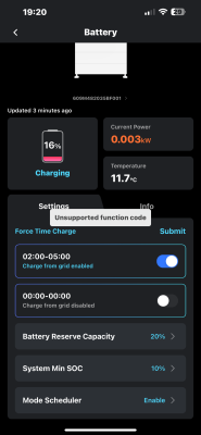

Here's the error message I get from the force charge function:
You can’t use the normal charge periods and scheduler together (they are mutually exclusive) which is what that less than helpfull error means.
You’ll either have to do what you want with the standard charge periods, or use the scheduler force charge option instead.

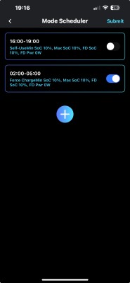

Thanks. That's good to know. So last night, with the mode scheduler set to charge between 0200-0500, it did not charge (AGAIN). That is the third night that it has not worked...

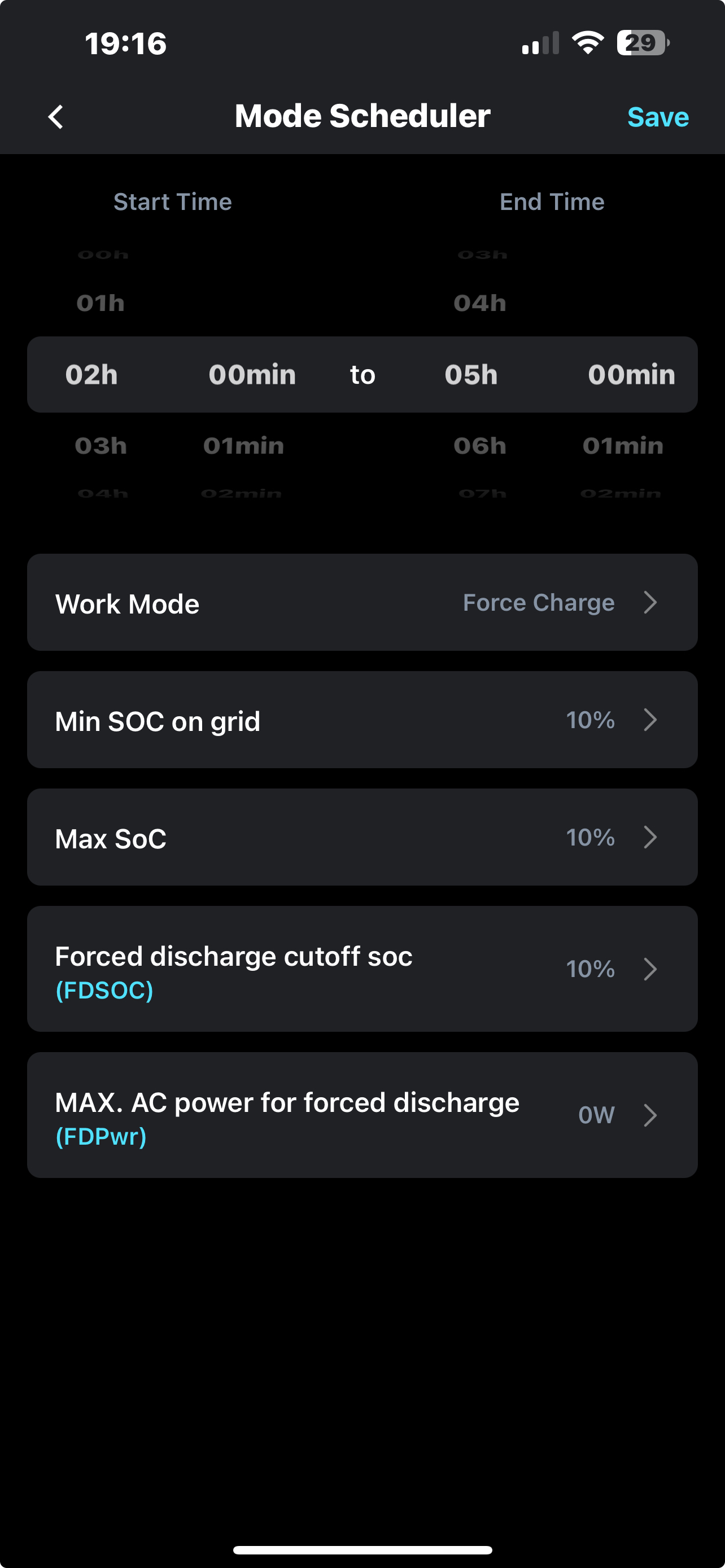

Looking at that top photo, and the lower schedule your force charge schedule is being set with a MaxSoC of 10% - it should be 100% - this setting tells the inverter when to stop charging and at 10% it will never start (the rest of the settings are correct).

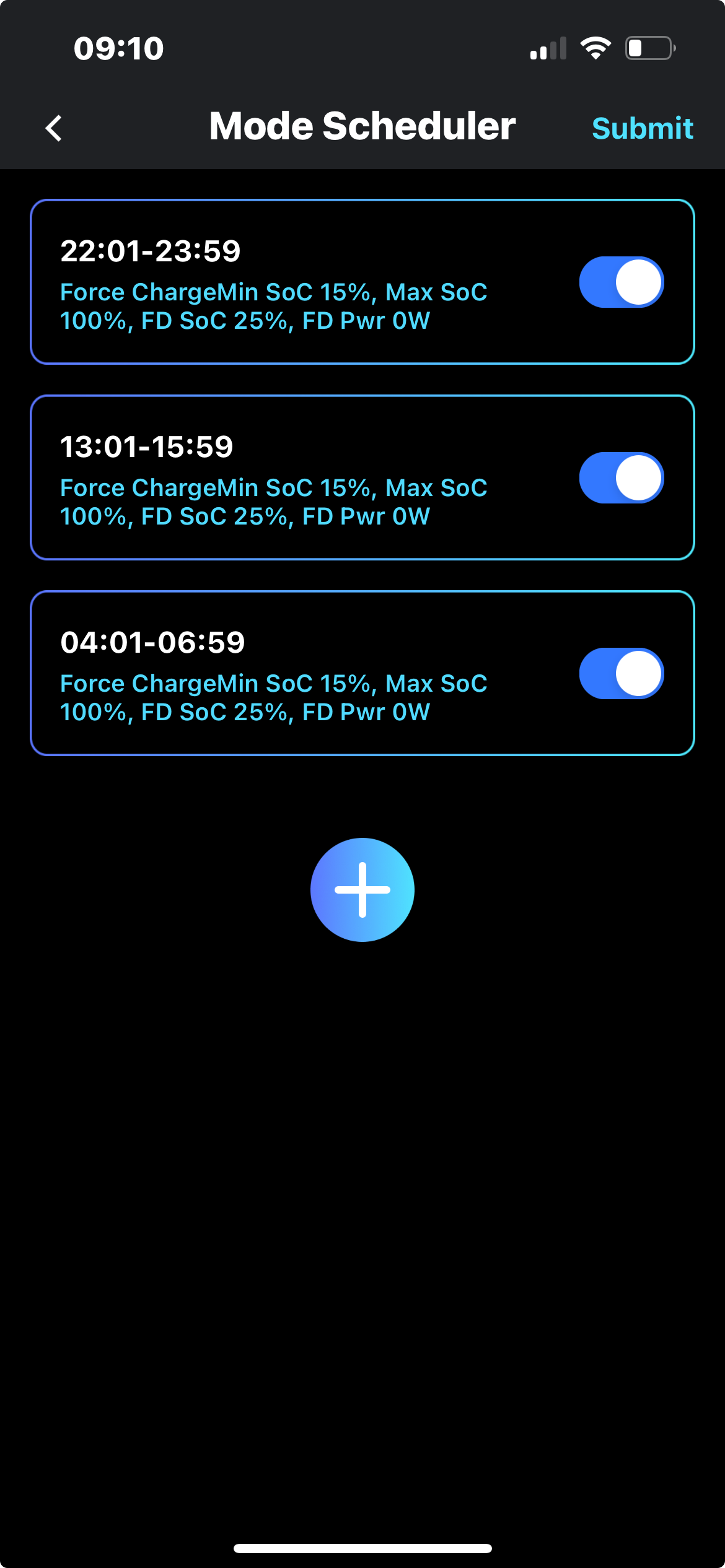

No we don't use the integrated agile function as our 15kwh battery needs topping up during the day so we schedule charging at lower rates (see attached)

Ok, they are definitely set correctly.
Couple of things to check - if you look at your inverter screen is the time showing correctly.
Just to check the inverter is running - on the Inverter front panel, press and hold the check button (2nd from right) - if it says 'Stop' then it is running in which case press the right hand 'exit' button, if it says 'Start', release and press the check button again and the inverter will start.
Failing that it does sound as if the inverter manager has crashed (not following timed events) - and the remedy to that is usually a restart. When they asked you to turn it off and back on again, did the screen go totally blank before you restarted it (i.e. you have to also turn off your batteries).
