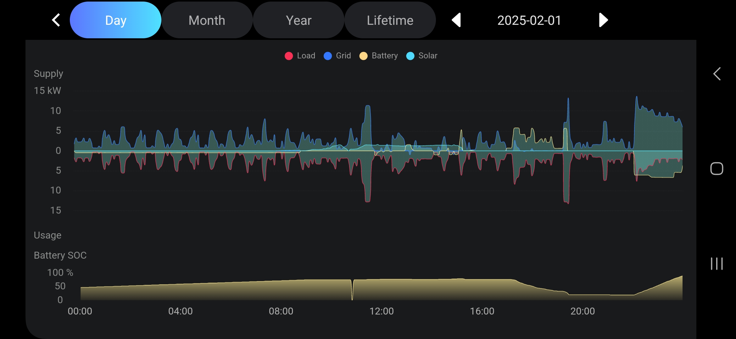

The notch in the SoC is where I rebooted the system, no altering of settings at all after that

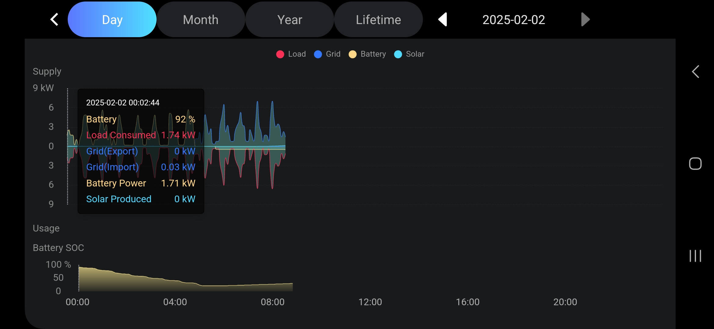

Passing midnight it was up just shy over 90% SoC, but instead of continue force charge it went into self-use

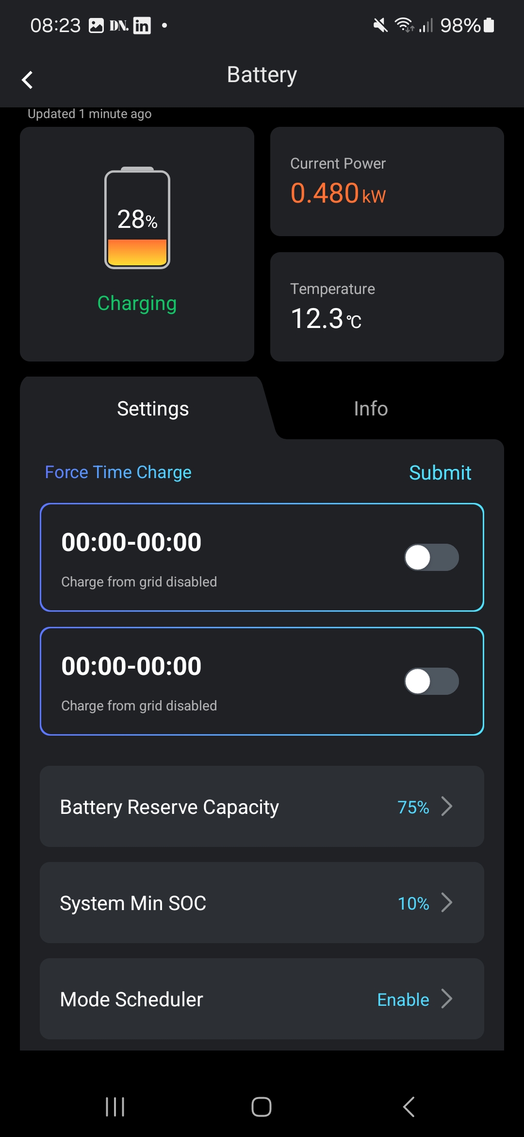

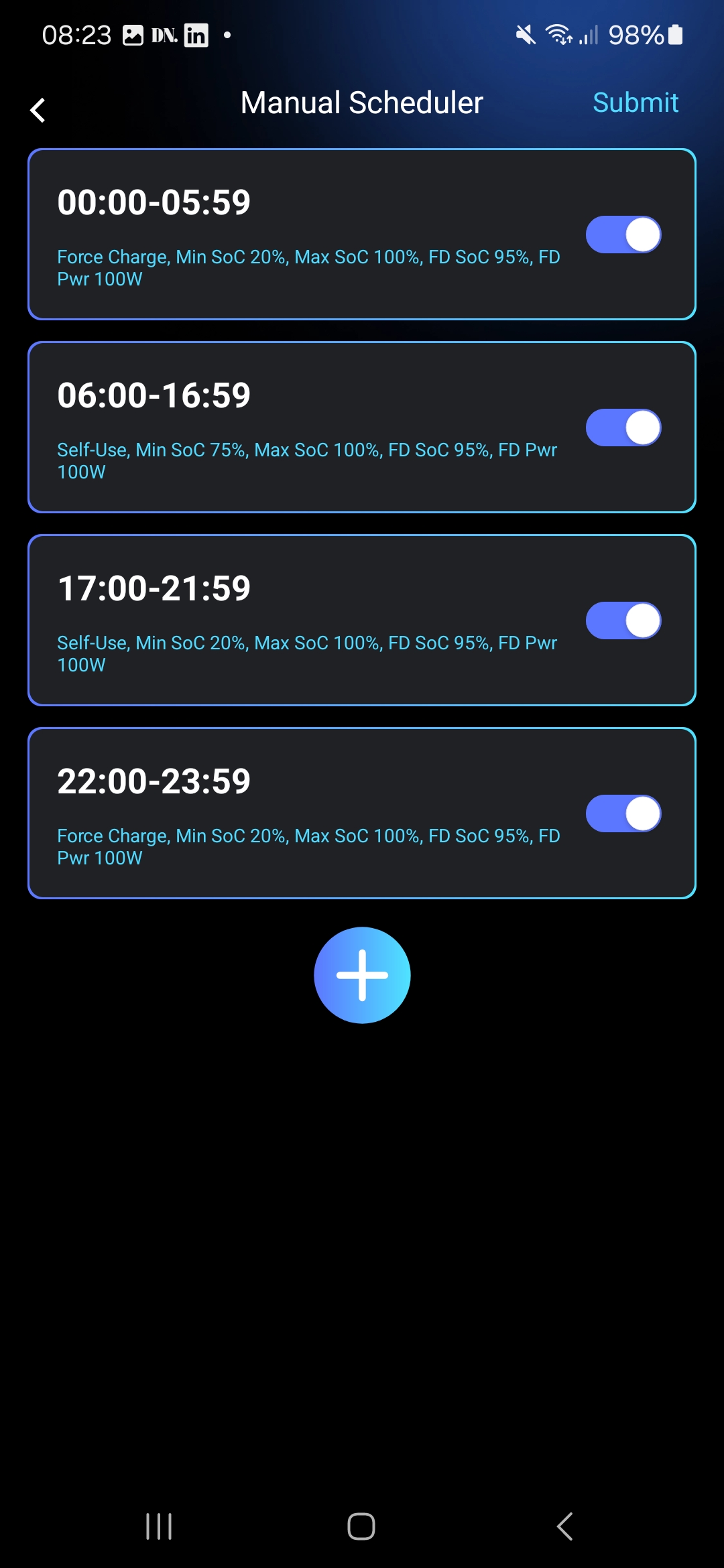

Been careful not to overlap. The min SoC value of 75% in self-use is not my end game, just during testing
Standard scheduler is and were disabled
Mode Schedule Force Charge only works once

Thanks for posting, the scheduler functions have only recently been released on the H3 series - i've checked your firmware versions and they are current.
Schedule timings and settings look fine, although I have found it is best to set FDSoC the same as your battery reserve level (not 95%), i've seen a few issues with that from time to time.
Your battery reserve capacity is very high at 75% - is that intentional ?, normally it is set the same or a little bit higher for use on EPS

The 75% battery reserve capacity is only an artifact from previous test runs where I didn't want a period of self-use drain down batteries to 10. Also, the minSoC 20% will go to 10% once I get things to work.
