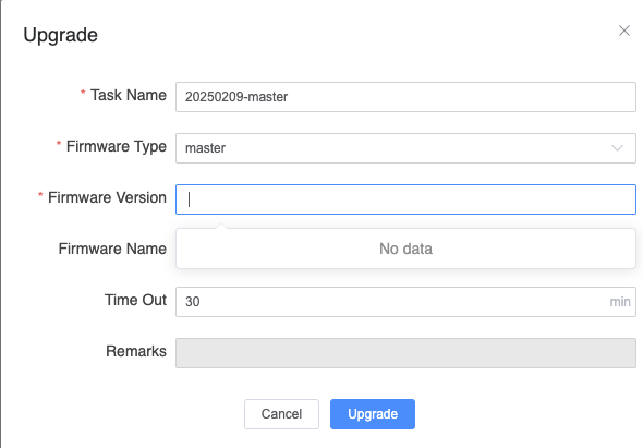

As I wanted to upgrade my inverter from master 1.25 to 2.05, I got the problem, that I could not select the firmware version in the upgrade-form. It does not give me any option.
When I search for inv serial I can see my inverter:
But in upgrade screen it doesn't give me any firmware:
Is it because my current firmware is too old?

Hello, sorry for the delay in adding your post for some reason it didn’t notify me - did you manage to get any further with this?.
The reason that is usually does this is if there is a lock between firmware versions, I can’t see multiple versions of the H3 Master showing only the latest and you should always do Master first them Manager, but there is a slave 1.03 which might be a pre-requisite before you can have the latest Master.
If it is because the firmware is old, it will mean that Fox will have to do the update for you as their support and dev have access to more versions than you can see.

The issue still persist - or due to too much work I had no time to do more checks.
But neither I was able to upgrade master nor slave.
So I will get in contact with Fox support.

I was able to solve the Problem.
I tried once again to upgrade and this time it showed me Slave version for upgrade. After that master and manger could be upgraded, too.
Now everything is on latest version and Home Assistant is getting all data.
