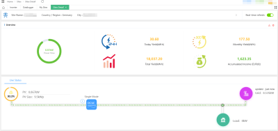

Here is a screenshot of our system from the cloud.
-> PV: 8.867KW
<- GRID: 8,535 KW
So, current yield 8,867KW, feed-in 8,535 KW Is this interpreted correctly
Posts: 1850
That shows your PV generating 8.867kW and of that you are exporting 8.535kW to the grid.
It looks like a solar only inverter (S/T/G series) which isn't capable of showing the house load (unless you fit an optional meter)
