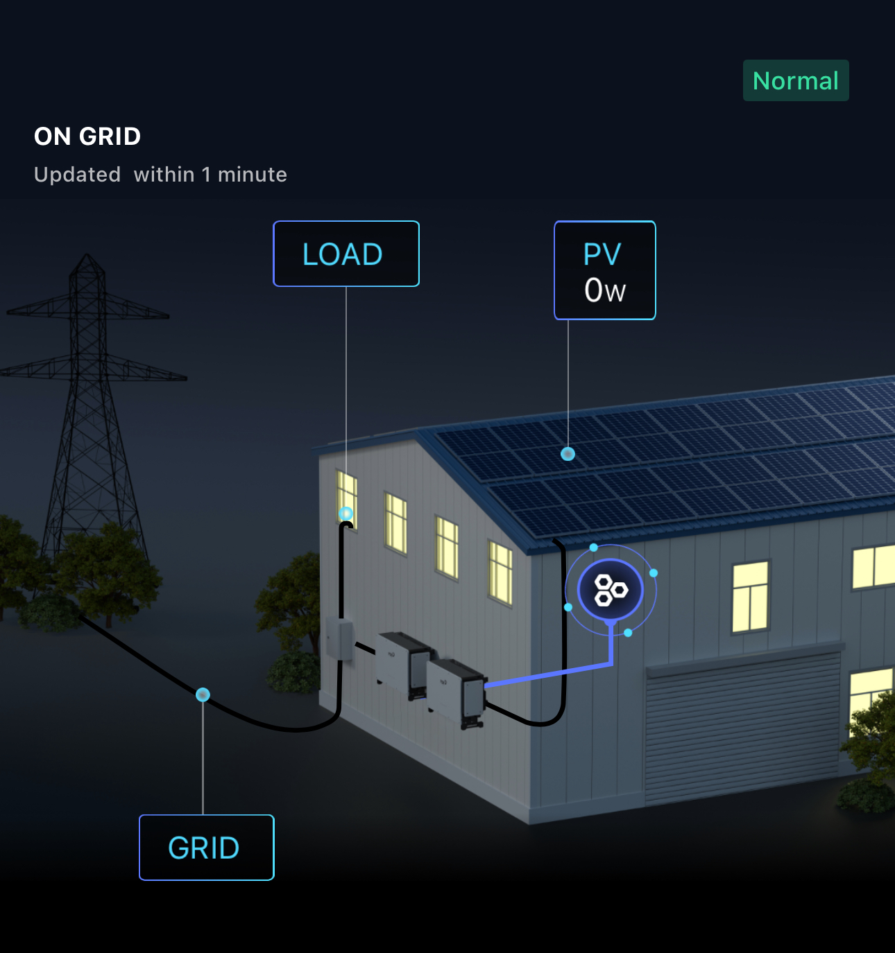

System diagram that shows load

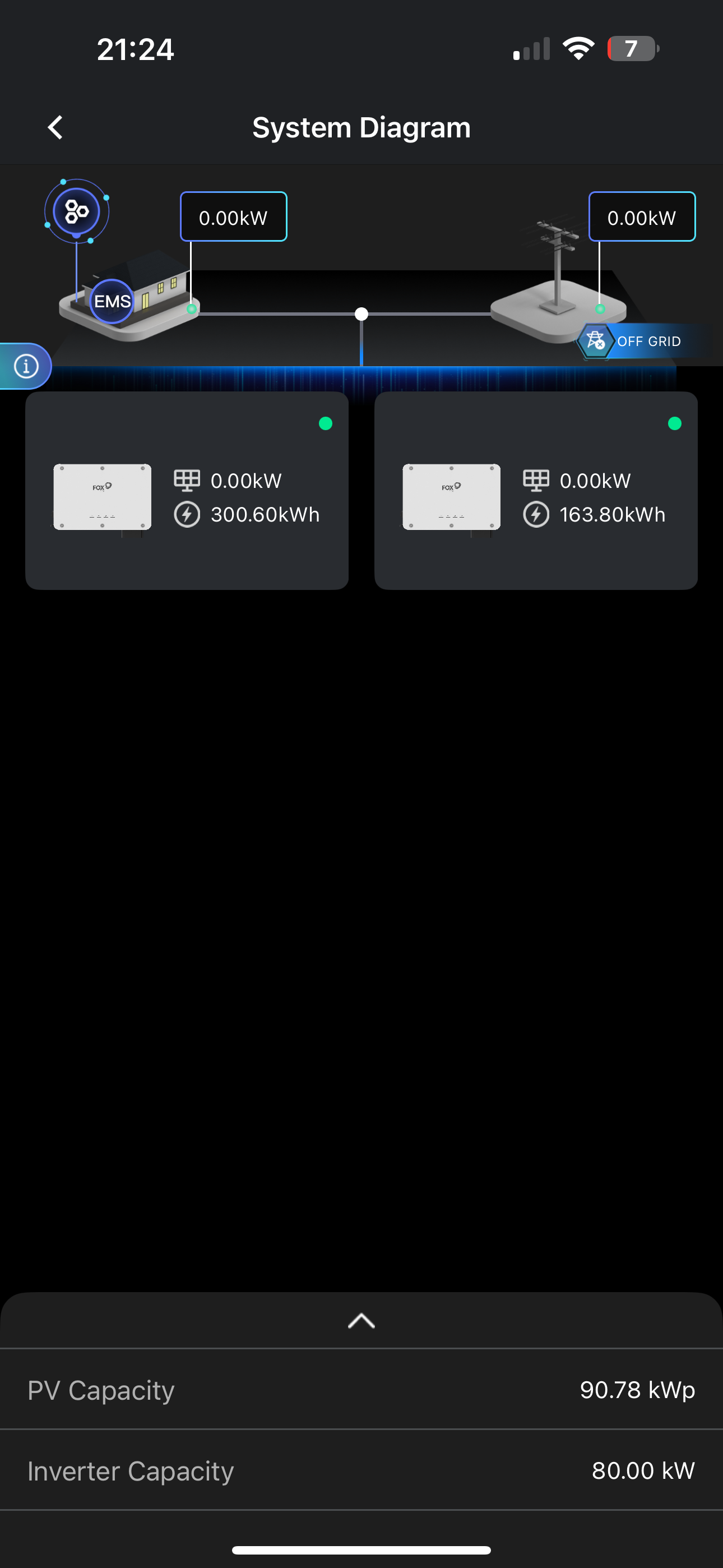

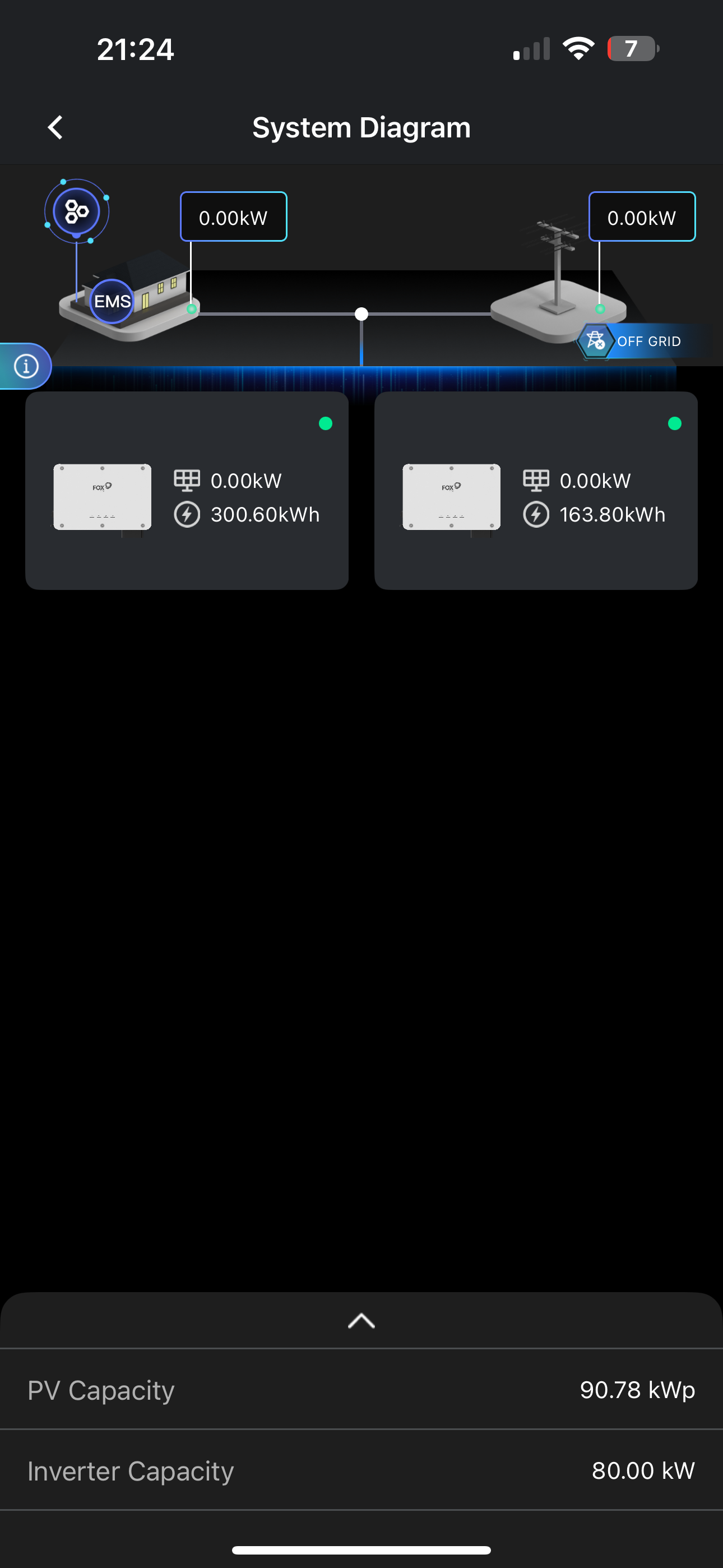

The grid and load show nothing
