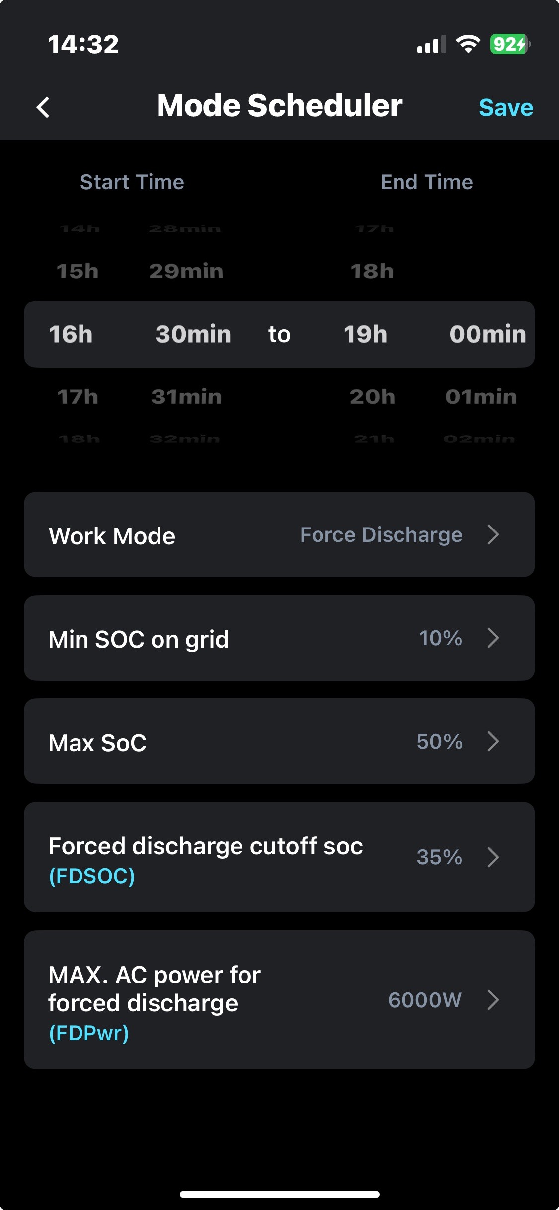

The picture is is our set up for a 15 panel with a Fox EP11 battery. Basically, we can get by on all the solar that the panels generate from about 10am until 4.30pm, it runs the house, including dishwasher & washing machine tops up the battery and a small EV and exports the rest to the grid. I've set it to force discharge to the grid between 4.30pm and 7.00pm, but stop when the battery reaches 35% so we have enough for the evening and early morning.
Seems to work really well for us, with minimal reliance on the grid and a good level of export to the grid. This is good whilst the sun is shining, but I imagine come the autumn we'll be topping the battery up during the cheap nighttime rate and using it to supply the house with no export.
