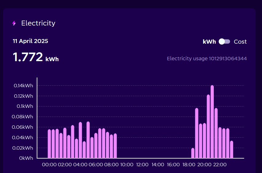

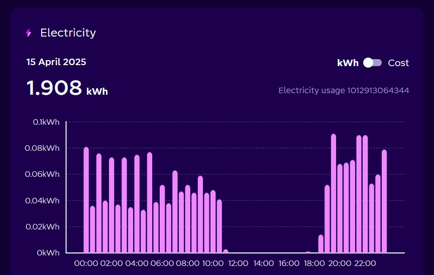

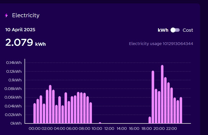

Sorry to ask a possibly repeated question, I did a quick look and didn't see anything relating to this issue. My solar setup is as follows:
Fox ESS EC2900 - 14.4kW Li-ion Battery (1 x Master + 4 Slaves @2.88kWh each)
3-Phase Export
The system was setup by the installer to run the house first, charge the batteries 2nd and then export anything else to the grid with the 100% priority for house consumption during the day. In essence my understanding on a good solar day , there would be ZERO draw from the grid other than the negligible Grid SYNC required of a few watts each hour or whatever the timeframe is.
As the sun drops and the solar produces less power, my understanding was that the batteries begin to pick up any short fall the house needs first and will discharge all night before charging as the sun comes up in the morning (providing sufficient power is in the batteries to not need grid import). The cycle then should just repeat. But.....

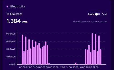

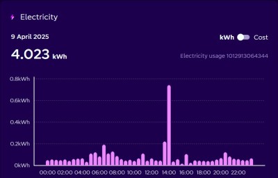

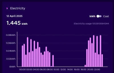

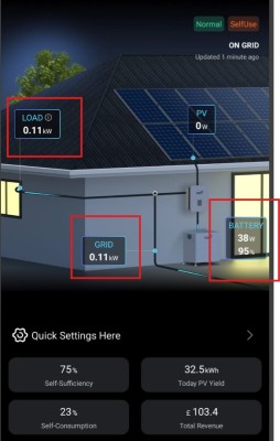

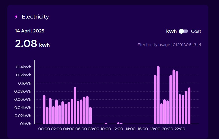

I'm seeing a nightly IMPORT from the grid the moment the sun drops to the moment the sun rises, not a full whack of usage but I was under the apparent naïve understanding that the batteries would cover 100% of the house usage at night so there is little to no Grid import.
But I'm pulling between 1.5kWh - 2Kwh per over night as seen on the octopus account usage. That doesn't seem right at all and the app even shows grid import. Is something not set correctly here, why would the batteries not cover the full load as they never drop below 88% for the following morning so there is no demand for the grid at all.
The screen shots are EXCLUDING the standing charge, this is over night usage showing before solar and then afterwards (Before solar starts at the bottom). Any help on this would be great please as if its a simple settings issue ion the inverter can I do this myself?
Thank in advance for any help.

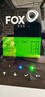

I'm waiting on the installer to come back to me but I took a photo of the inverter software versions. Are these up to date?

Ok, latest versions are -
Master 1.58
Slave 1.06
Comm(Manager/ARM) 1.33

I'm still waiting for the installer to get back to me on these recommendations but where can I see the latest software / firmware version of the inverter etc from the mobile phone app or the FOX web login? IS that possible? Can't seem to see it as wanted to check the 3 versions of software you said were the latest?

In the V2 app click on Device and then Inverter, then click the serial number under the inverter picture and it will provide all that information
