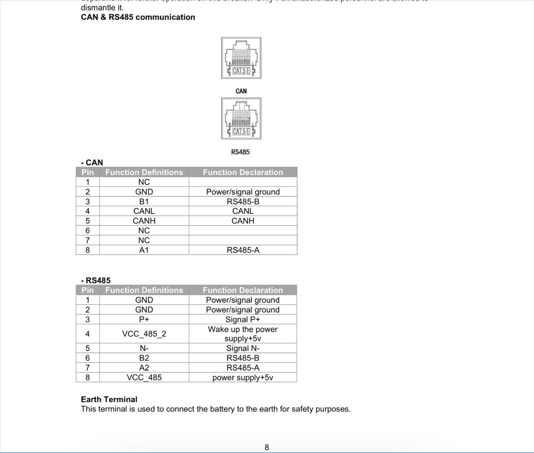

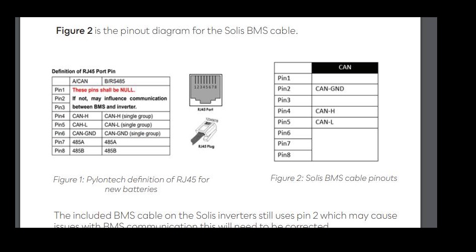

I came across something similar with a Solis inverter and FoxESS batteries and it was the cable that was the problem.
The first diagram is the pinout for a Solis to Pylontech battery (standard cable is straight through).
The second is the pinout for the HV2600 BMS and as you can see the CAN H & L pins are reversed
I.e. the Solis > Fox battery cable needs pins 4 & 5 crossing over in the cable.
