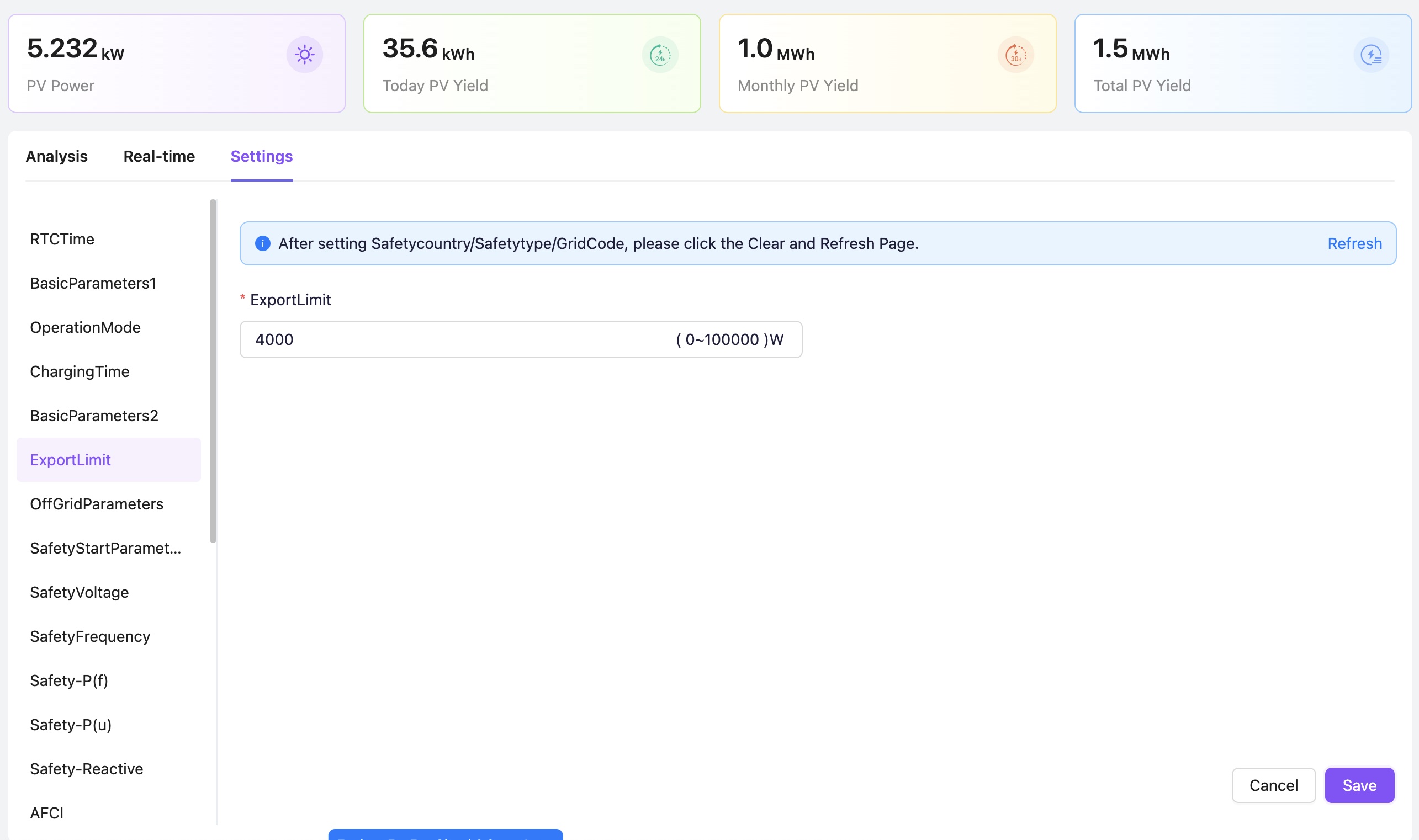

My installer is highly unreliable and not very pro-active. It would take several days to organise this, but in the mean-time I found in the new Cloud platform, that I can manually adjust it via the device settings.

Will wrote: Thu May 29, 2025 11:28 am What is this new cloud platform?
Via https://www.foxesscloud.com/v2/plants/plant you can configure settings on the inverter:
