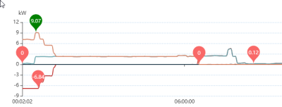

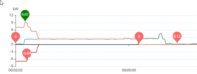

The problem is, I haven't been able to properly replicate it (I don't think), as last night when charging my EV, the power draw from the grid was <3kW (see image)

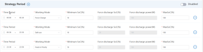

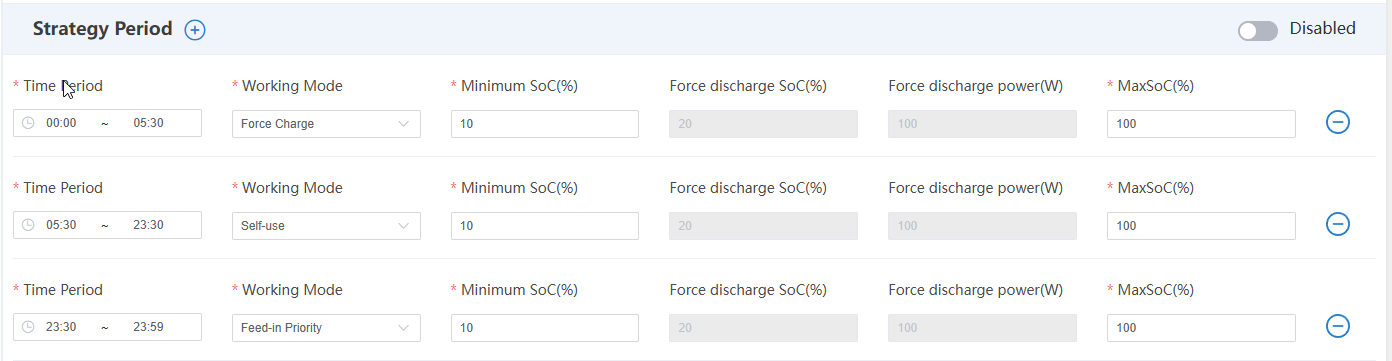

I've set the schedule up as per this image
but I'm not sure if what I've set up is the same as the "Charging time"/"Grid Charge Setting", or if it's not possible to replicate, and I should just stick with the old way of doing it.

The old charge periods are probably the easiest to use, but scheduler should work just fine but is a bit trickier - I think you’ll are nearly there with it - your first entry should be set to finish at 05:29 which will end at 05:29:59 (it’s over lapping with the next self use setting at the moment), and likewise the self use entry should end at 23:29 (:59).
The only other thing I can see is that your schedule has not been enabled (top right of your screen), that needs to say ‘Enabled’ and you should be good to go.

Any idea why the power draw was so low? Usually when charging an EV and batteries together my power draw from the grid gets up to nearly 12kW, then once the batteries are charged stays around 6.8kW while charging the EV.

If your EV charger is wired so the KH sees the load from it you’ll have 2 problems - the first i’m sure you already know is it will flatten your batteries if you don’t have a charge period set, the second issue is that out of the box the KH has a grid import current limit of 50A (11.5kW).
So if you’ve got 7.2kW going to your EV, and (say) 1 kW to the house load you’ll only be able to charge your home batteries at 3.3kW before you hit the 50A limit and the KH throttles.
The easiest way to deal with it is for an electrician to re-wire the EV so that it splits off at the meter (by installing a Henley block) before the house and inverter connection, that way you’ll never have the problem again.
The quick way to fix it now, is to change the setting ImportLimitCurrent to (say) 80A so that you’ll be able to utilise the full performance of the KH when charging batteries etc..
