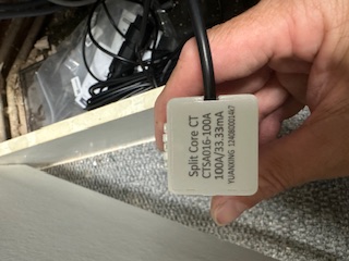

Usual problems are due to location of the CT clamp, has it been fitted to the live feed of the smart meter, also it is the correct Fox CT clamp ratio (100A/33mA).
Re: Ct clamp on f5000
This is the CT clamp i have. Red wire in pin1 and black pin2

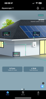

This is with the CT clamp connected the correct way onto the live feed. It appears to show everything going to the grid and after a few minutes the PV shows 0W. The draw from the grid of 4.46kw is probably correct although the green lines show it all going to the grid and should the load show as a negative figure? After a few minutes though the PV drops to 0W. I don't have any batteries as we will always use all the load supplied as we use between 3500-8000kwH continually

Yes it’s the right clamp.
You shouldn't be seeing negative load, thats usually a sign the CT clamp is facing the wrong way (or is in the wrong place), but to check you don’t have any other generation on site as this won’t work with multiple generators.

There is two live feeds coming in, one from the grid and one from the solar which connect back together in a junction box, I've then connected the CT clamp past this connector where it is back to one live cable. CT clamp is definately the correct way round, fitted between the meter and the consumer unit.

I’m not sure why the installer says the CT clamp will not work but does on a Hybrid - with the Hybrid it comes as standard the only difference is if you have more solar generation sources on site, the Hybrid can have a second clamp fitted to monitor external generation whereas the F series cannot.. so as long as you don’t have any more solar generation it should work (it is in the manual as supported, and documented to work).
Just going back to where the CT clamp is fitted, you said there are 2 live feeds coming together into a splitter - the CT clamp should always be on the live feeds coming together as close to the incoming meter / fuse as possible, try moving the CT clamp so it is there - it is measuring current flow and needs to be as near the grid connection to capture everything.

It should be on the feed from the grid not the consumer.
