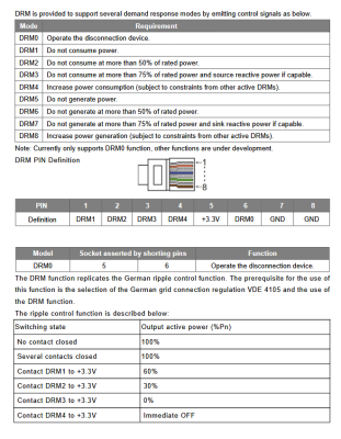

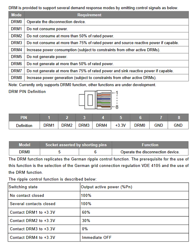

According to the manual (EN-H3AC3-User-Manual-V1.0.4-20250107.pdf, p.37), this is NOT an Ethernet protocol. Although it uses RJ45 plug.
Also, it seems only DRM0 (disconnect) mode is currently implemented. Just by shortcutting pins 5+6.
So, nope. This is not Ethernet, and I would not suggest to plug it into your router/switch!
