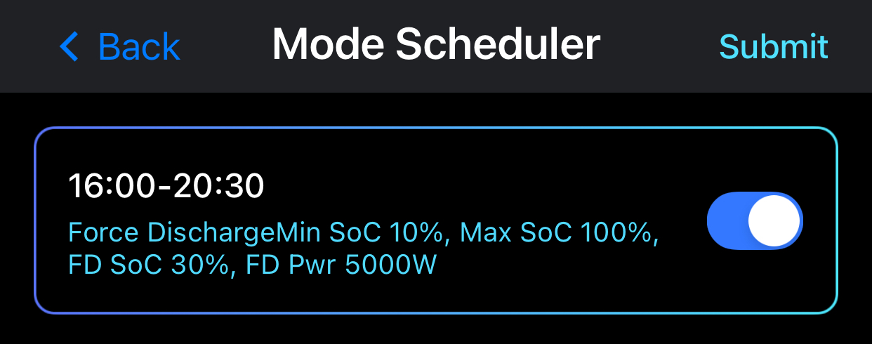

Heres my settings.

But on a really sunny day (three days ago), where the solar system is running full tilt at FD start time, the solar panels go straight to the grid for over 90 minutes until the sun drops a bit, the FD time seems to be recognised and so discharge starts to happen even though the solar is available to provide all the FD power ?
That tends to suggest that even though the solar can continue to provide export to the grid, the batteries tsrat doing it and power is effectively lost as the solar panels cant charge the batteries and cant send to the grid ?
Surely the most efficient way would be for the panels power to always go to the grid during discharge time and only do the batteries as a topup when the panels cant produce enough ?
