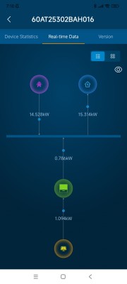

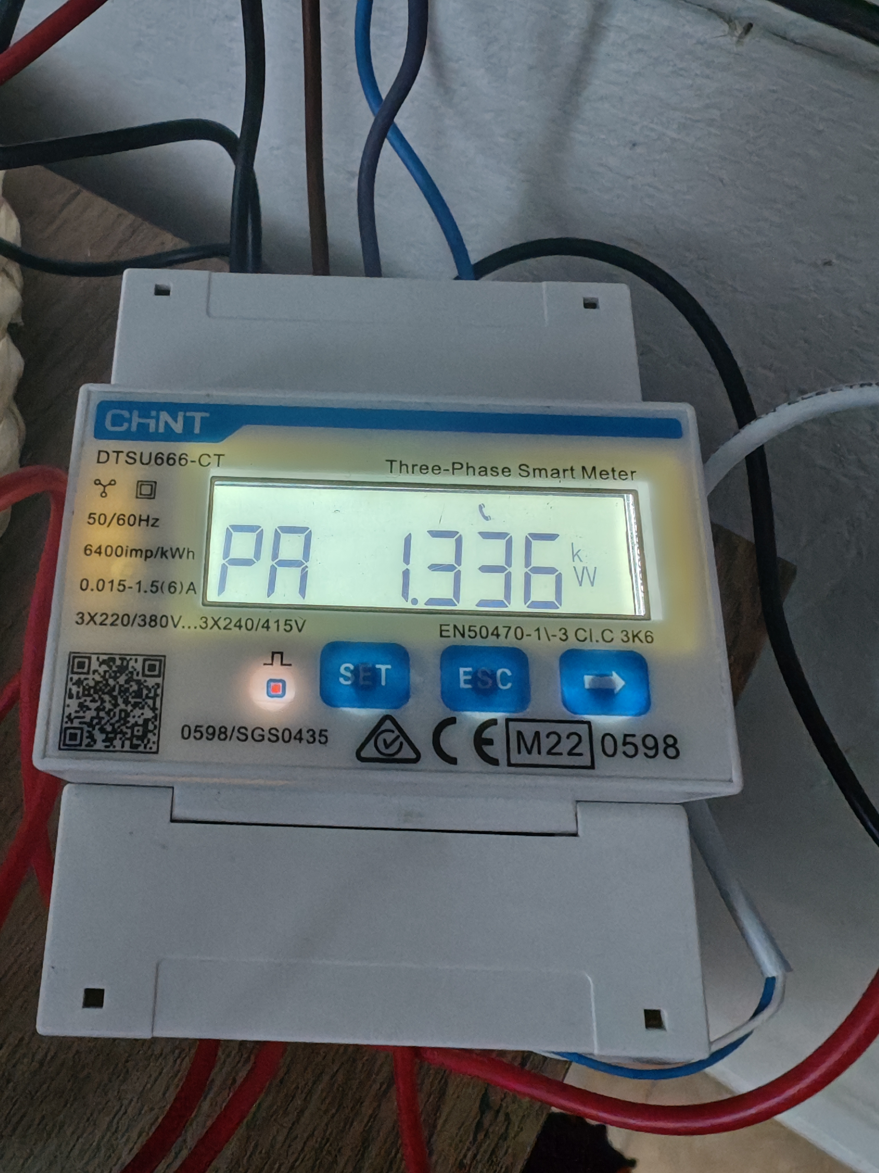

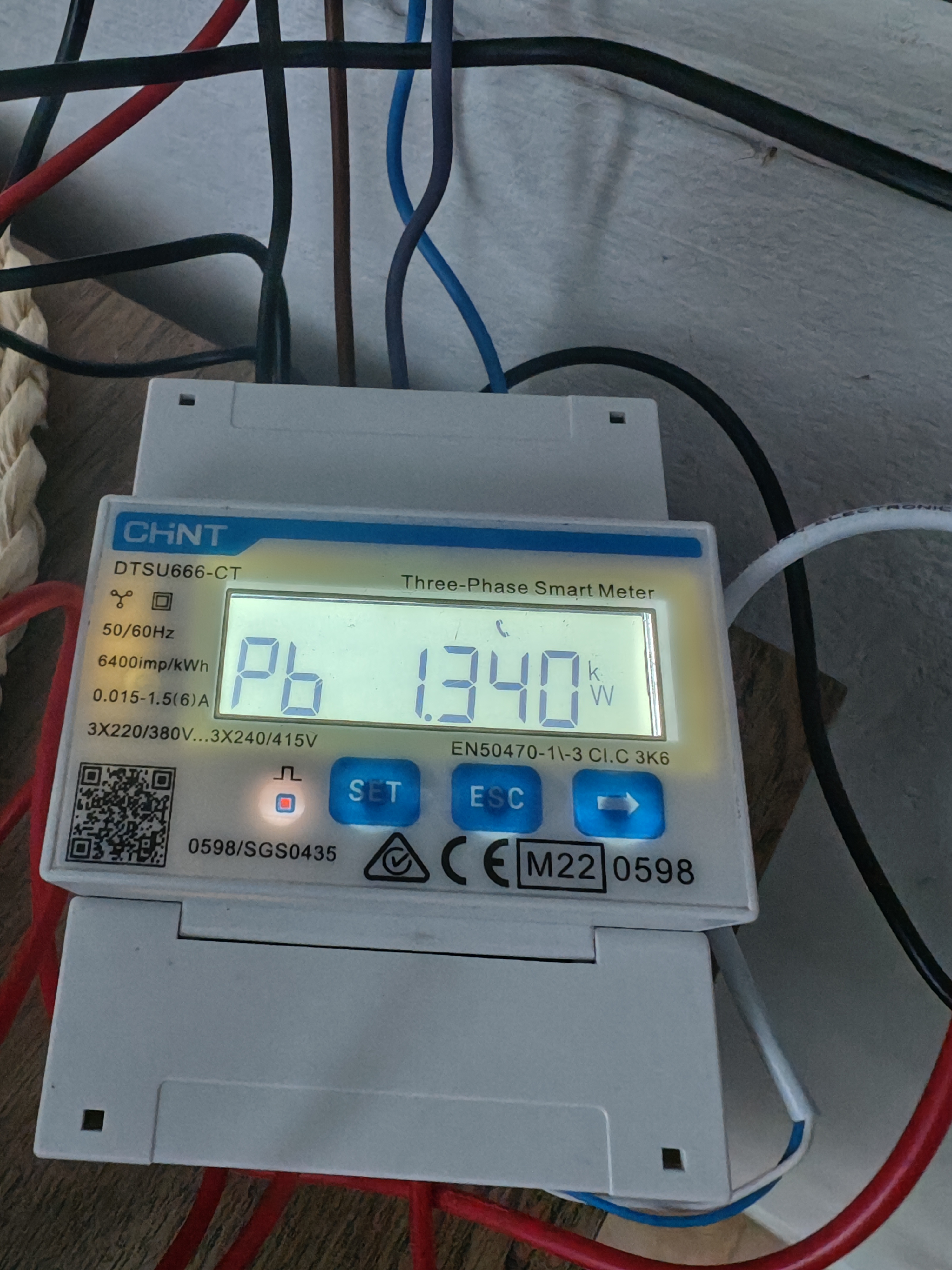

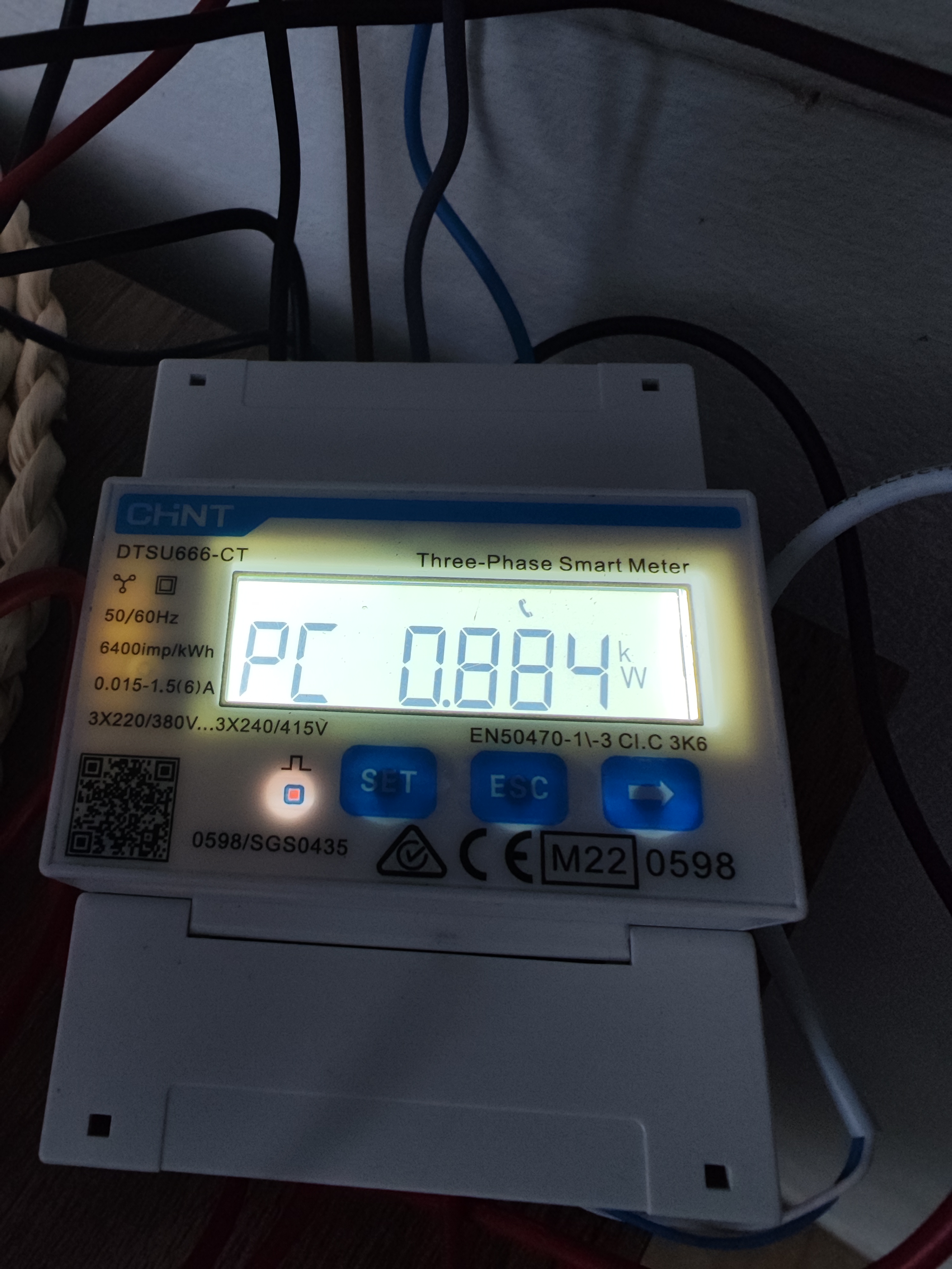

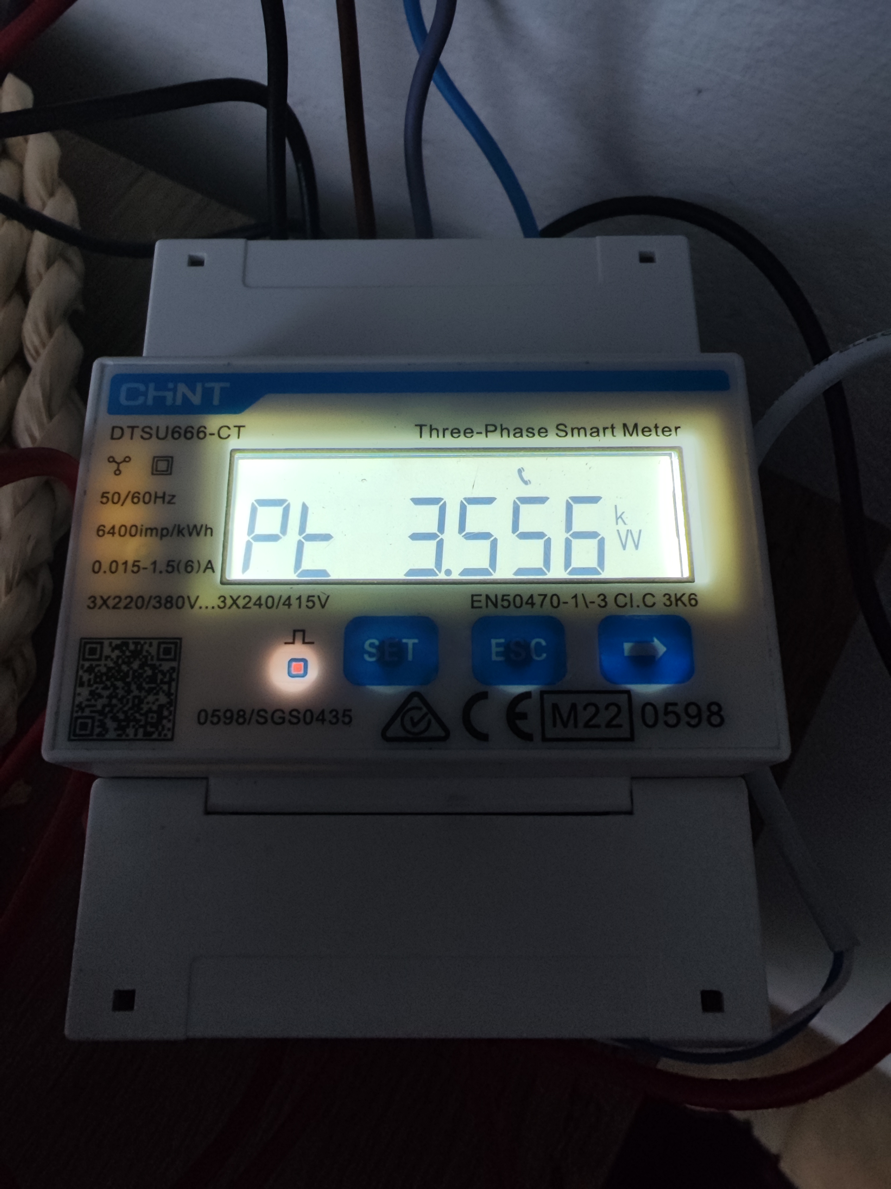

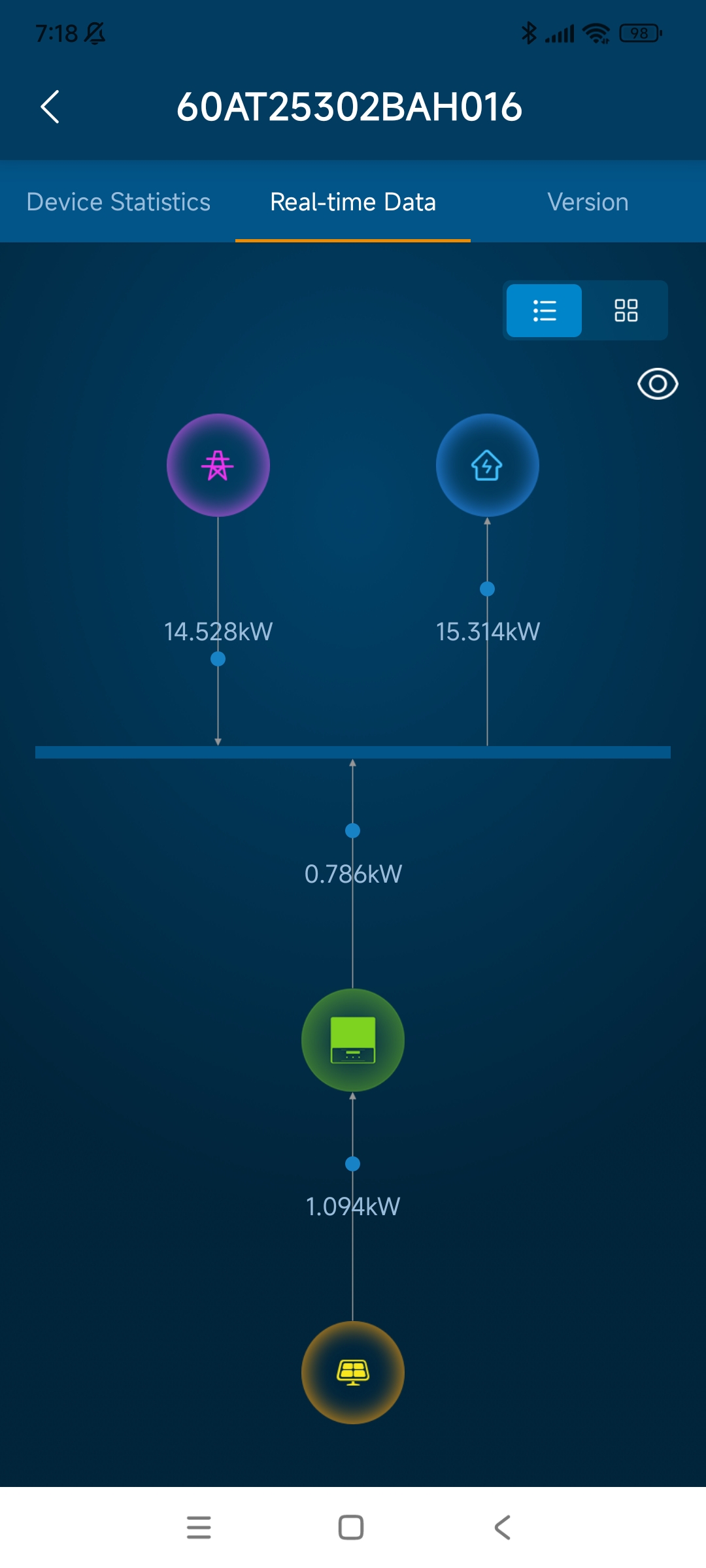

Here is new info
On smart meter, the readings are fine
On inverter is abnormal....
Any sugesstion ?
