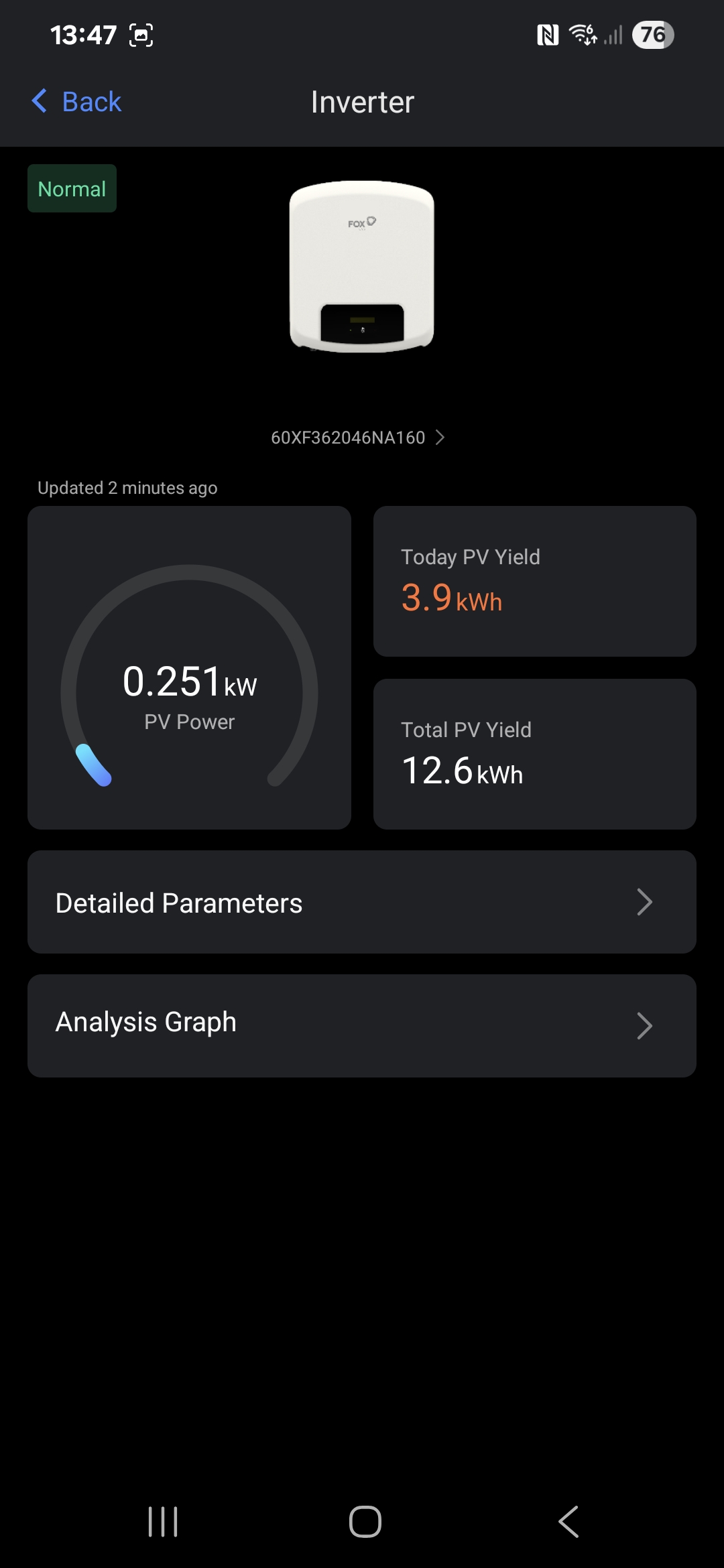

Q1. What does the dongle on the F3600 do and what is it talking to?

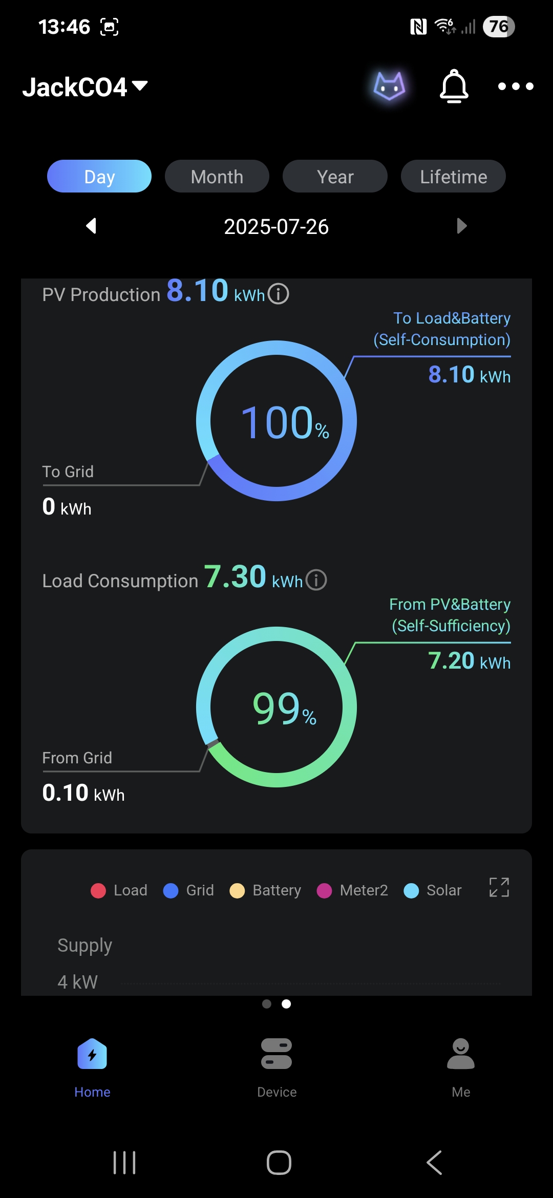

Q2. See the 2 screenshots. The Home display says my PV Production so far today is 8.1 kWh but the inverter controlling the 7 panels says it is 3.9 kWh. I tend to believe the 3.9 kWh as what I have actually produced from my panels alone. However, if this display is the right one, how do I get monthly totals of what I ACTUALLY produced from the panels alone?
The Month tab on the home screen I assume is totalling the PV Production numbers which look high and I cannot see a way to extract the monthly totals for the F3600 inverter only?

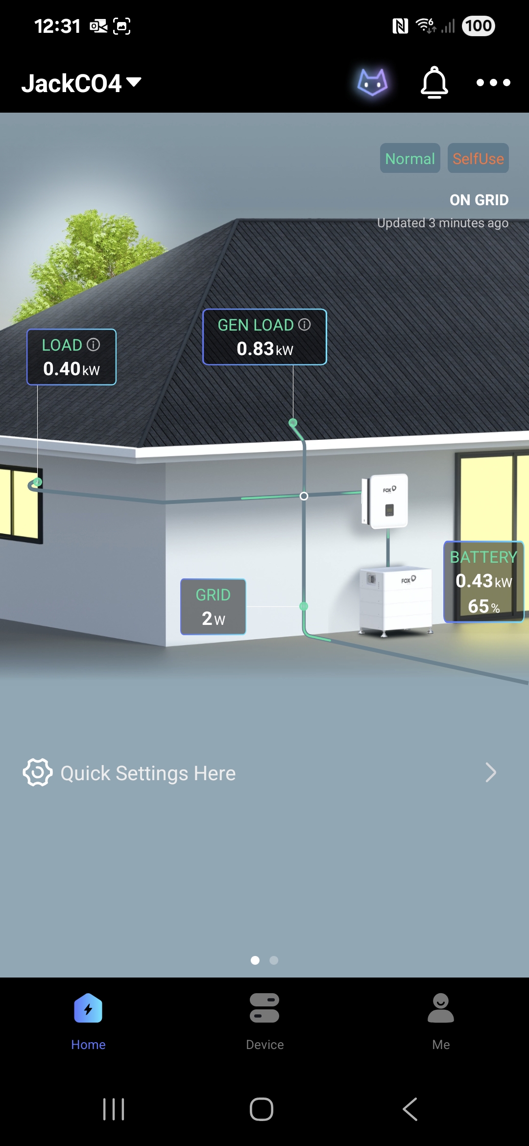

I think I know what is going on, can you check on the plant graph view with the image of the house and post a screenshot of the graphic with the power flow chart.
Thank you for the reply, hope this is the one you need.
Many Thanks David
Many Thanks David
Just as i suspected, you'll need your installer to add a second ct known as ct2 to the AC1-5.0-E-G2 which will be clipped around the ac output of the F series string inverter. Once installed and configured, you'll then see a generation figure. Currently, your ac charger is counting the solar generation twice as without the second ct, generation is just appearing.
Thank you for this. I have emailed the installer to request the change you requested.
Can I ask one final question, sorry if it is a silly question.... but is the lower production number showing on Inverter2/F3600(3.9 kWh in the screenshot below) wrong too? That is, it is not my actual PV generation?
Will the addition of the second ct just make the numbers consistent between the main display and the Inverter2 display or will they actually correct/change the numbers as well?

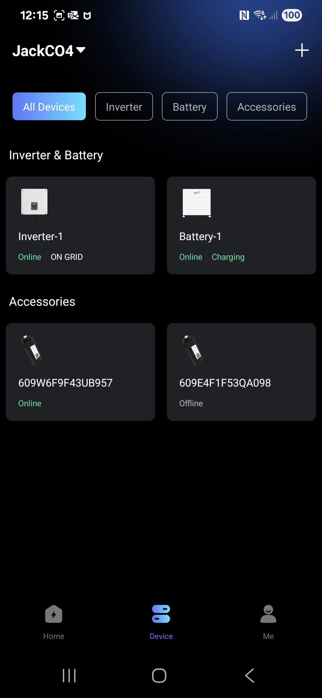

HI, I could use a follow up on this one. I had the installer make the cabling changes requested above. However, a lot of data seems to have disappeared and I am not sure that I can answer my original question... What is my PV Generation today ... or yesterday etc..
See the changes below, they are the Old and New screenshots (New=following the wiring changes). The device screen now shows the F3600 inverter as having disappeared and the Home screen has also disappeared.
Any guidance on where I can find my PV generation numbers would be really appreciated. Or whether I need to contact the installer again, but I would need some guidance on what to ask him to do he has been really helpful so far.
Looks like the F series datalogger has been removed or disconnected?
