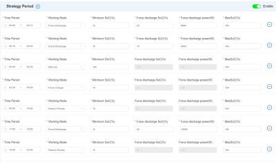

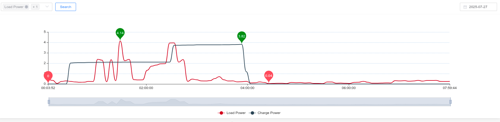

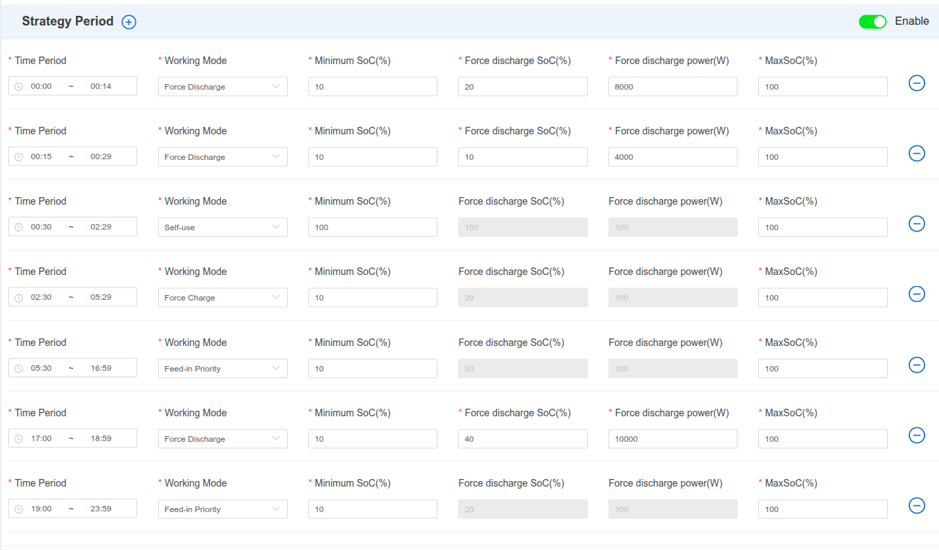

I've tried to setup the scheduler for octopus go, seems to be mostly working, but my intention was to try to keep the 00:30 - 02:30 period as run from grid but don't charge by setting the min soc to 100 on self use mode. but as per the profile last night it seems to have charged, albeit at half the charge rate it seems (Bat charge current limited to 9 amp via front panel)
My setup is KH9 with EP11 battery.
Any ideas whats going on there?

When you set the minsoc to 100% if the battery is lower than 100% it will start a maintenance charge (5A) until the minSoC is met - your charge power will be your battery voltage * 5A in watts.
If you have the 'backup' work mode available try using that instead, it will hold the battery soc and run from grid.

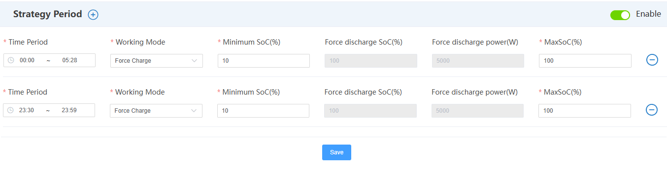

You need to set the mode scheduler to Force charge for the entire 23:30 to 05:30 period. That way it will charge the battery and keep it at 100% until 05:30.
You need two force charge periods as shown:
