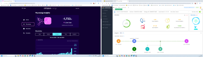

We have noticed a few mismatches on what out octopus mini shows us is happening grid side, with what the inverter says is happening.
for instance this morning, the battery was full, the inverter said we were generating 2.274Kw, using 1.975Kw and exporting 0.299Kw, at the same time our smart meter was recording that we were exporting 1.733Kw, and as none was at home there would just be our base load of a bout 350w'ish

What we have noticed watching the app and our meter is that as soon as the battery is full, the app shows our house load shoot up at the same time the meter shows we are exporting, as this is showing as load, not surplus, the car charge will not turn on.

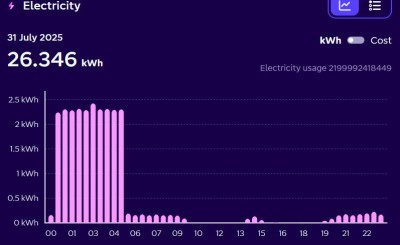

I have included 2 graphs of the same day, one from our inverter and one from our meter.
