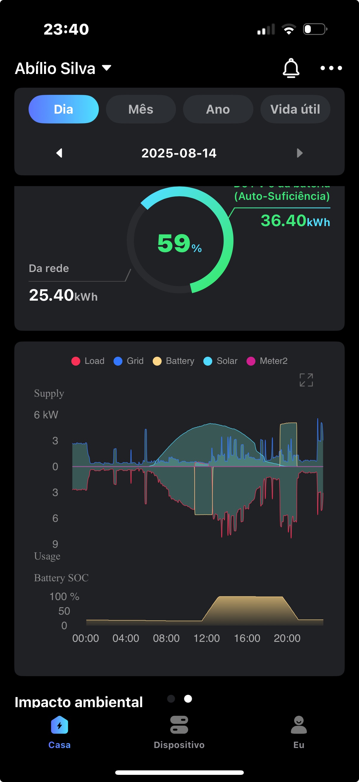

While reviewing the data in the FOX Cloud app, I noticed that the Total Load is shown as the sum of the Solar Production and the House Load. As a result, the battery is rarely charged.
To address this, I set a charging schedule from 11:30 to 19:30. However, as soon as the schedule ends at 19:30, the battery discharges completely, regardless of the current house load.
I have also observed that Meter2 shows no readings (see attached picture).
From my understanding, the Fox H1 inverter should be able to manage house load needs by balancing solar production and available battery charge. My installer has visited and checked the system, but I’m not certain the issue was fully understood.
Could you please review my setup and advise on the correct configuration to resolve this issue?

Unless you have a secondary generation source (such as another solar inverter), Meter2 will always be zero. If you do have a secondary inverter fitted with panels attached then Meter2 is either not fitted / working and that needs correcting.
Yes I agree your load is reading very high and there is no excess so your batteries will not charge naturally - i’m assuming that is not correct ?
As you have said the load reading should only show the amount of power consumed within the home and your grid would show import or export if there is any surplus - assuming there is surplus and the inverter is set to Self Use workmode your battery should charge.
If the load reading is not correct, it is likely that the primary meter (or CT) is fitted to the wrong point in your system or is not working correctly - it would normally be fitted on the live feeding from your incoming suppiy meter - you should call your installer back this is clearly not working correctly.
Hi thanks for the prompt reply.
Yes the inverter is set to self use, since the first day of instalation that the load graphic sums all energy sources available. In my understanding only shows a normal behaviour during night when i have the battery depleted and no solar power.
