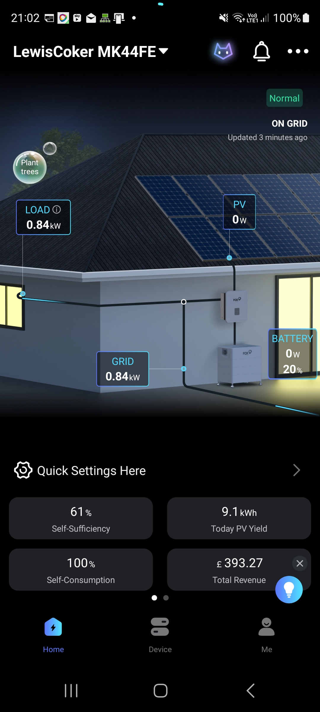

I taken a screenshot of my Foxcloud 2.0 app when I open it up; it's night at the moment, so it's obviously not going to be charging, but during the day, I don't believe I've been particularly aware of the system charging. I also don't know what the Self-Sufficiency/Self-Consumption and Total Revenue values represent.
I've no idea if any of this will give you any clues or not as to what's going on, but right now, I'm feeling like I've been taken advantage of...🤬
