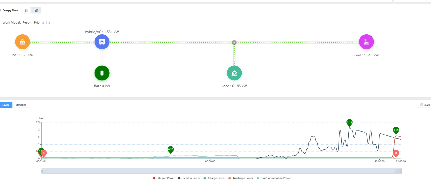

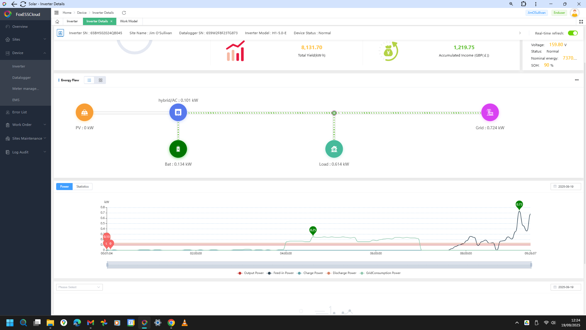

I think I have included a link to a screenshot, but I'm new at this, so let me know if I've not done it correctly.
https://1drv.ms/i/c/6544f32b9cc1426b/IQ ... height=731
Ok thanks, I can’t see the image - if you click below the post on ‘Attachments’ then ‘Add files’ it will give you the option to take from photos (if you are on mobile) or a location if it’s a laptop/desktop - select the photo and add it and it will be shown at the bottom of your post.
I suspect from what you have said that a firmware upgrade may have disabled your CT clamp in the settings but could do with that image to be sure (you can also check at your inverter panel in Settings, Feature, Meter/CT it should show ‘CT’)
I have looked at the inverter paneal and I think I have reconnected the CT clamp. The power flows seem to be back to normal
