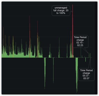

true, but this is what my stats gave:
A full charge from 20% to 100% is absolutely not done. It would kill my bill. (At the moment I can test at will because I've still got an old analogue meter and not the newer digital one. It's with the new ones they charge the so called capacity tariff)
During off peak times I need to spread the charging load from the grid or limit the charging bandwidth. Two Time Periods are just not enough to charge the battery enough in winter time. The RS485 integration should give me some more options.
I know we have to spread our load and so far we're managing it pretty well. There were some difficult situations, but now with the ECS pack, we did not peak above 2 kW/15' (except that one overnight charge).
I don't really understand why this would be such a problem - as I mentioned previously, if you were charging the battery at the maximum rate allowed by the inverter, you'd be pulling approximately 7kW from your grid connection. From 20% to 100% SoC is just under 7kWh, so your charge time would be around one hour. During that hour, you'd pull approx 1.7kWh from the grid each 15 minutes, a long way below your lower limit. The red line you're highlighting on the graph doesn't really clarify as there are no axes or units.
Long story short - I don't think you have a problem based on what you've told us, unless you're running at least another 2.5kW of electrical loads at the same time as charging your battery.
