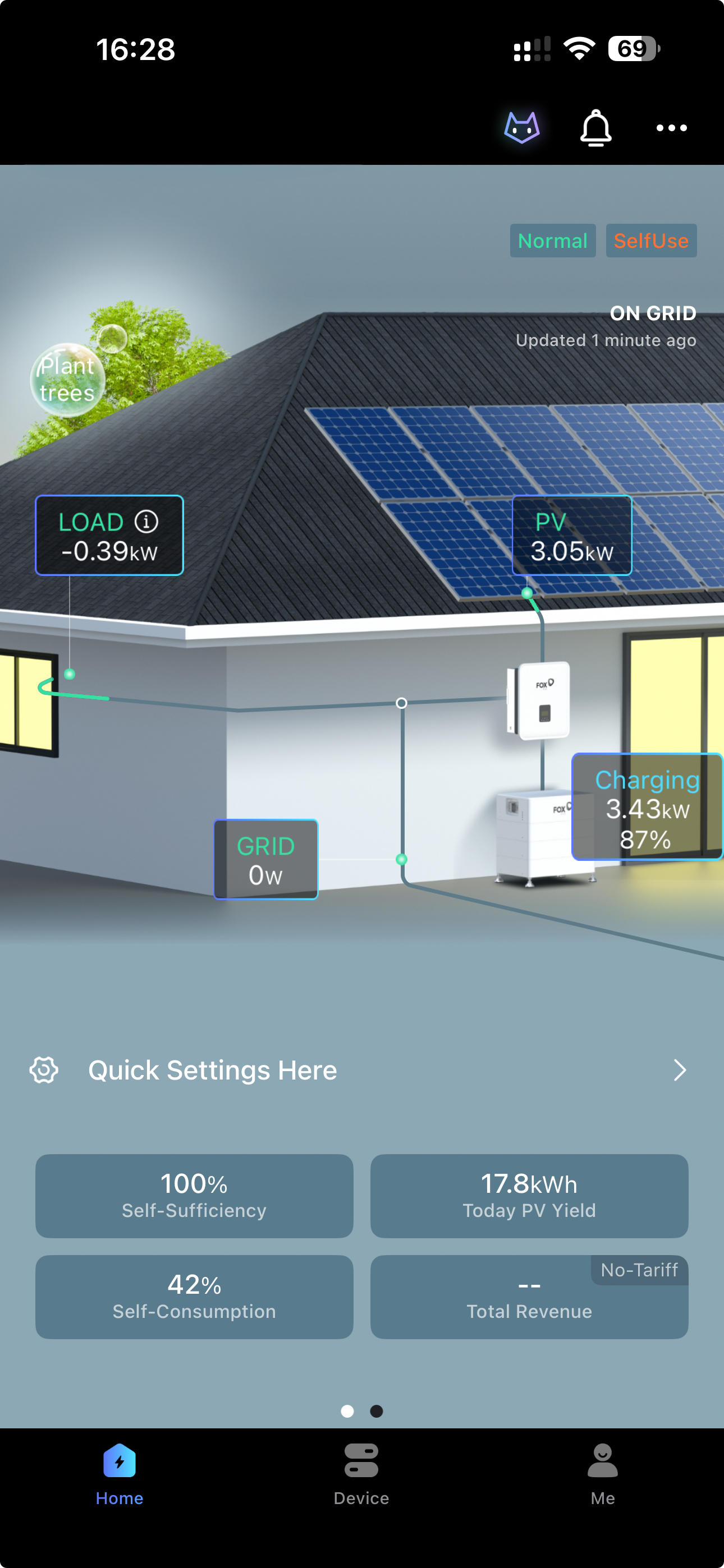

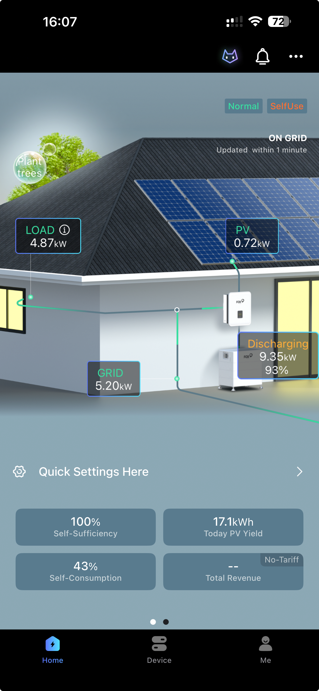

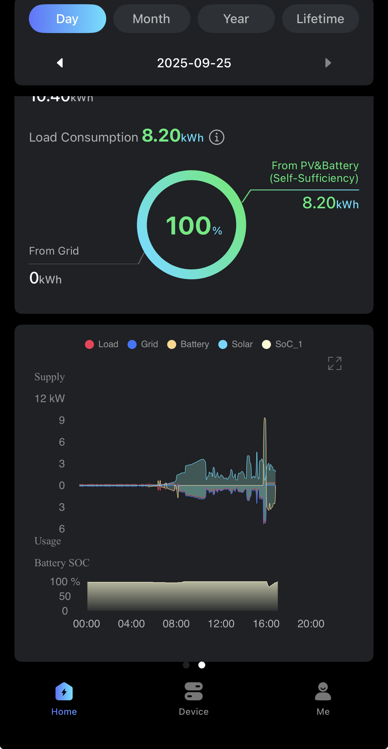

Is this a clue, look at the load and grid while it's discharging. My home is using barely any power right now, just fridge, wifi etc.
After the discharge, the system is using 500w to charge the battery plus solar which equates to the negative load_.png
An recharging seems to make load negative, and octopus says we are pulling constant 500w from the grid, which equates to the difference between the PV and negative grid....

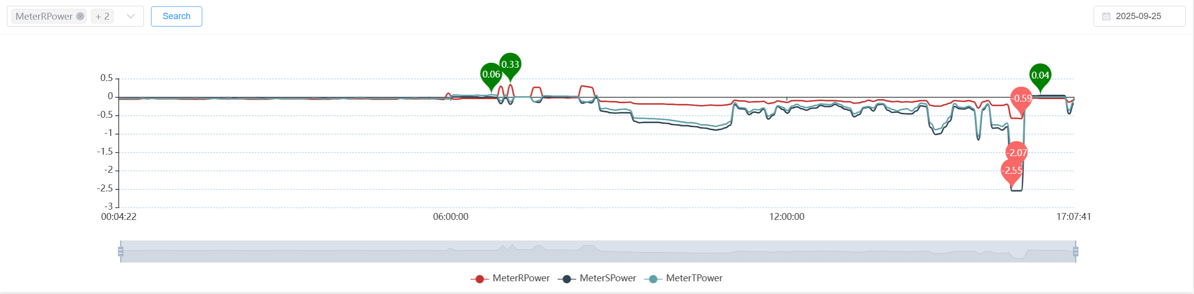

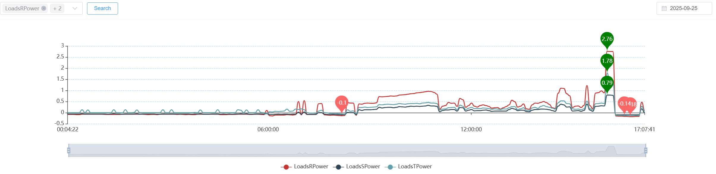

If you swipe left on that screen can you screen shot the graph and battery soc towards the bottom of that page.
Also need you to log into the www.foxesscloud.com website, click on Device on the left Menu and choose Inverter, then click the icon on the right hand side underneath ‘operation’
Scroll to the bottom of that page and you will find a blank graph, in the drop down select these items RPower,SPower,TPower and search - can you screen shot that graph.
Then clear those 3 selections and select LoadRPower, LoadSPower, LoadTPower and search - screen shot that graph
Finally clear those 3 selections and select MeterRPower, MeterSPower, MeterTPower and search - screen shot that graph.
If you can post those screen shots it might help work out what is happening and on which phases.

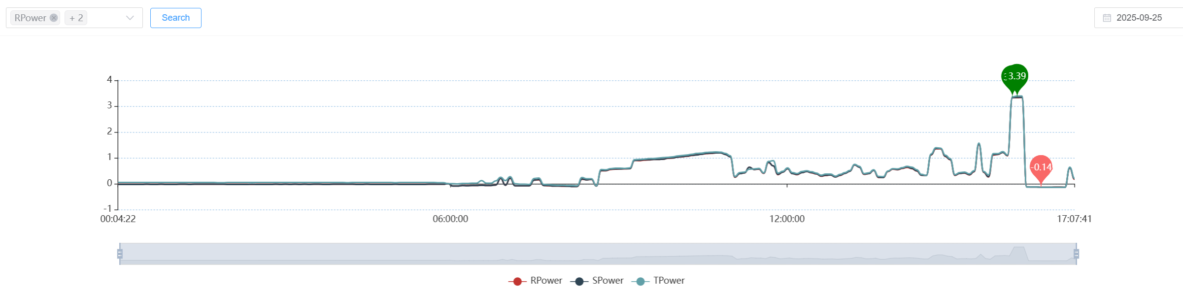

Re: Am I doing something wrong?

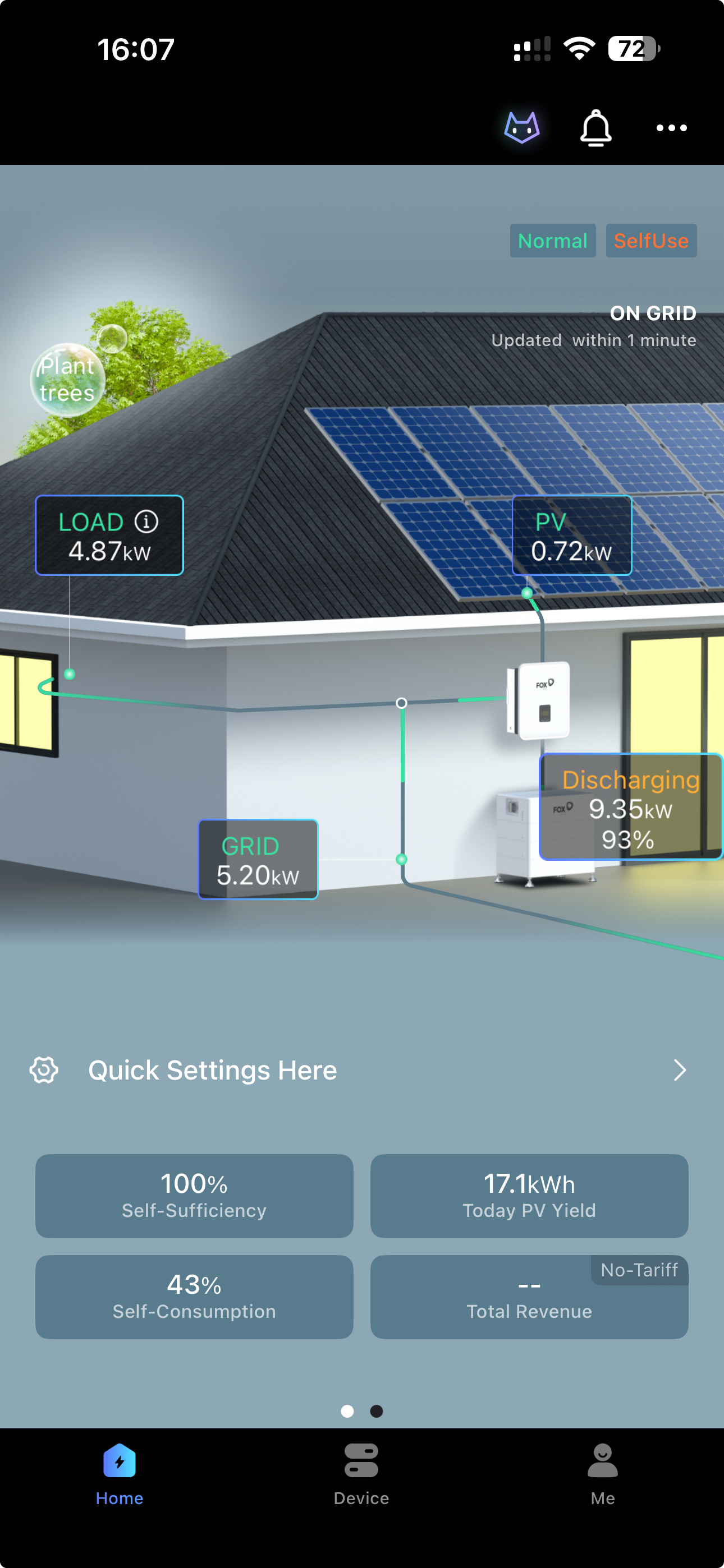

Just to clarify for me, it looks like you set the inverter to Force Discharge at full power and you can see the R/S/TPower shows that each phase is outputting 3.39kW which is what you would expect.
The problem then is that the power measured by the meter for each phase is lower on 2 phases and much lower on the RPower - that suggests a load is taking the difference so that would be approx 1.3kW on T phase, 0.8kW on S phase and 2.7kW on R phase - which would show a combined load of around 4.8kW, but there was no load on in the house ?

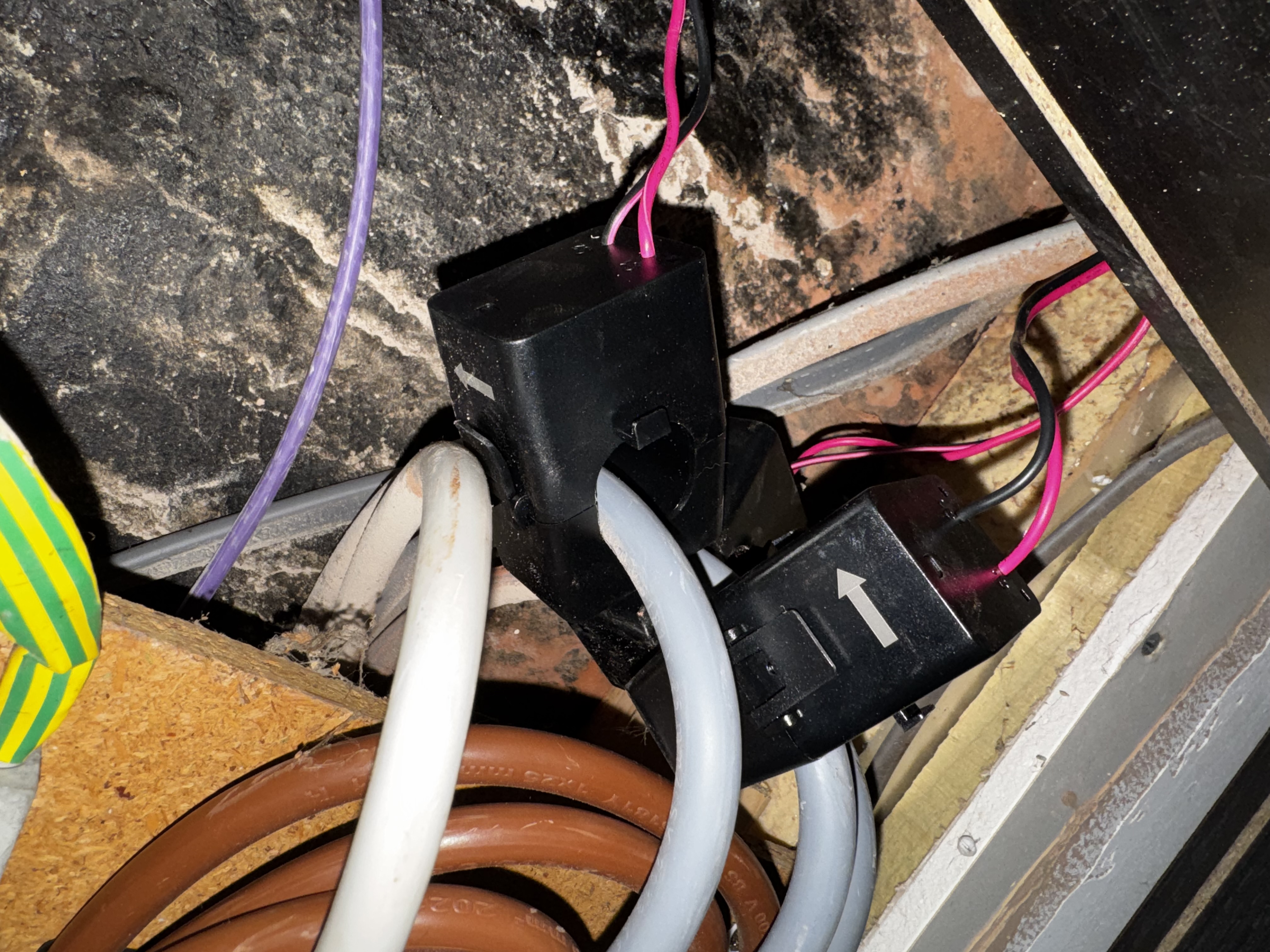

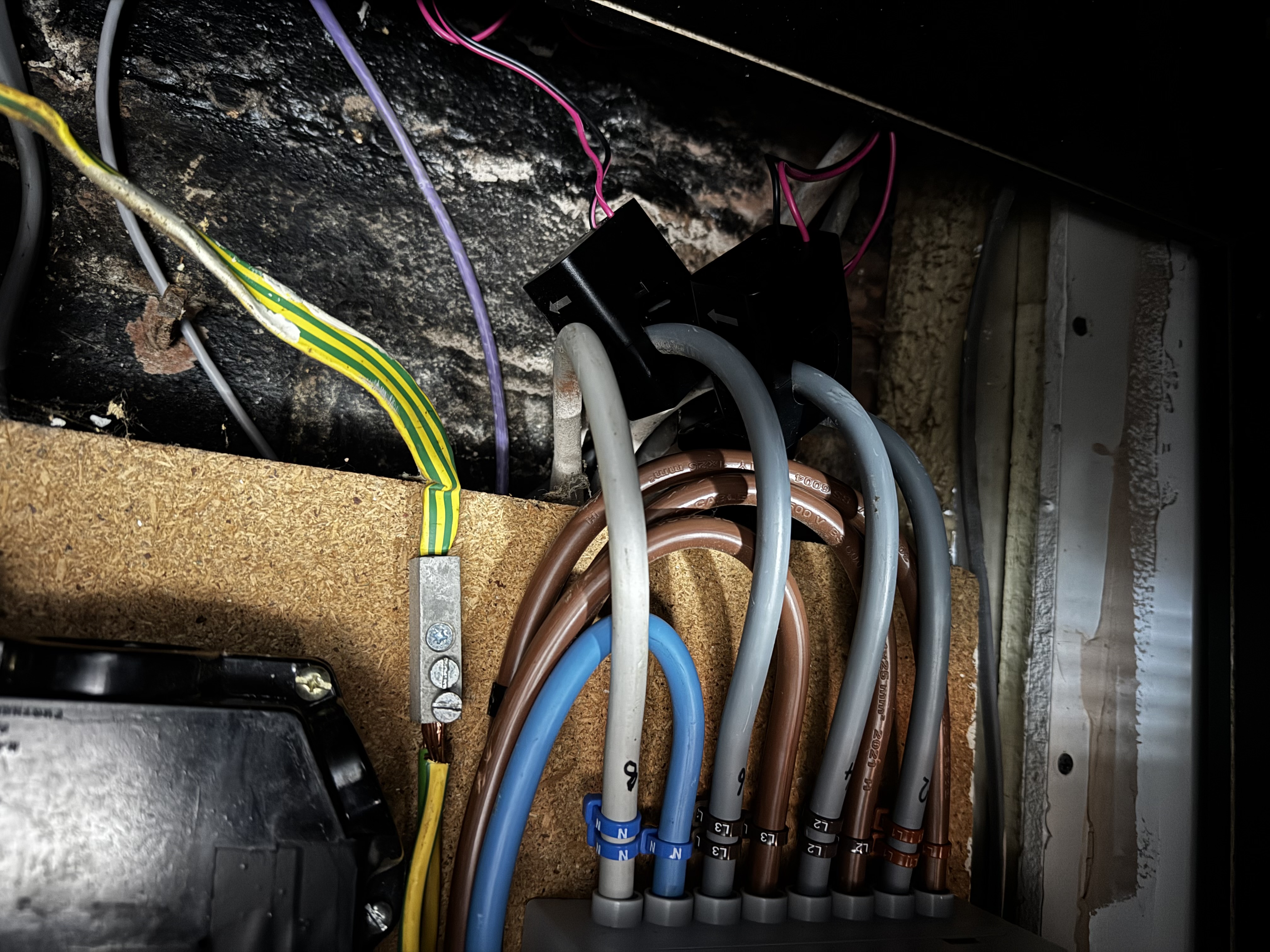

Could you grab a couple of pictures of your meter cupboard, if there are any CT clamps could you get close ups - I may need a few but i’m now sure what i’m looking at yet, probably know more when I see them.

Correct about the force discharge at 4pm. Just a trial to test it worked.
We have no iboost or device that soaks up any spare pv.
Right now we have no export as tariff still being set up, but grid meter shows 208 vs 143 that fox app reckons. Unfortunately I cannot tell per phase.

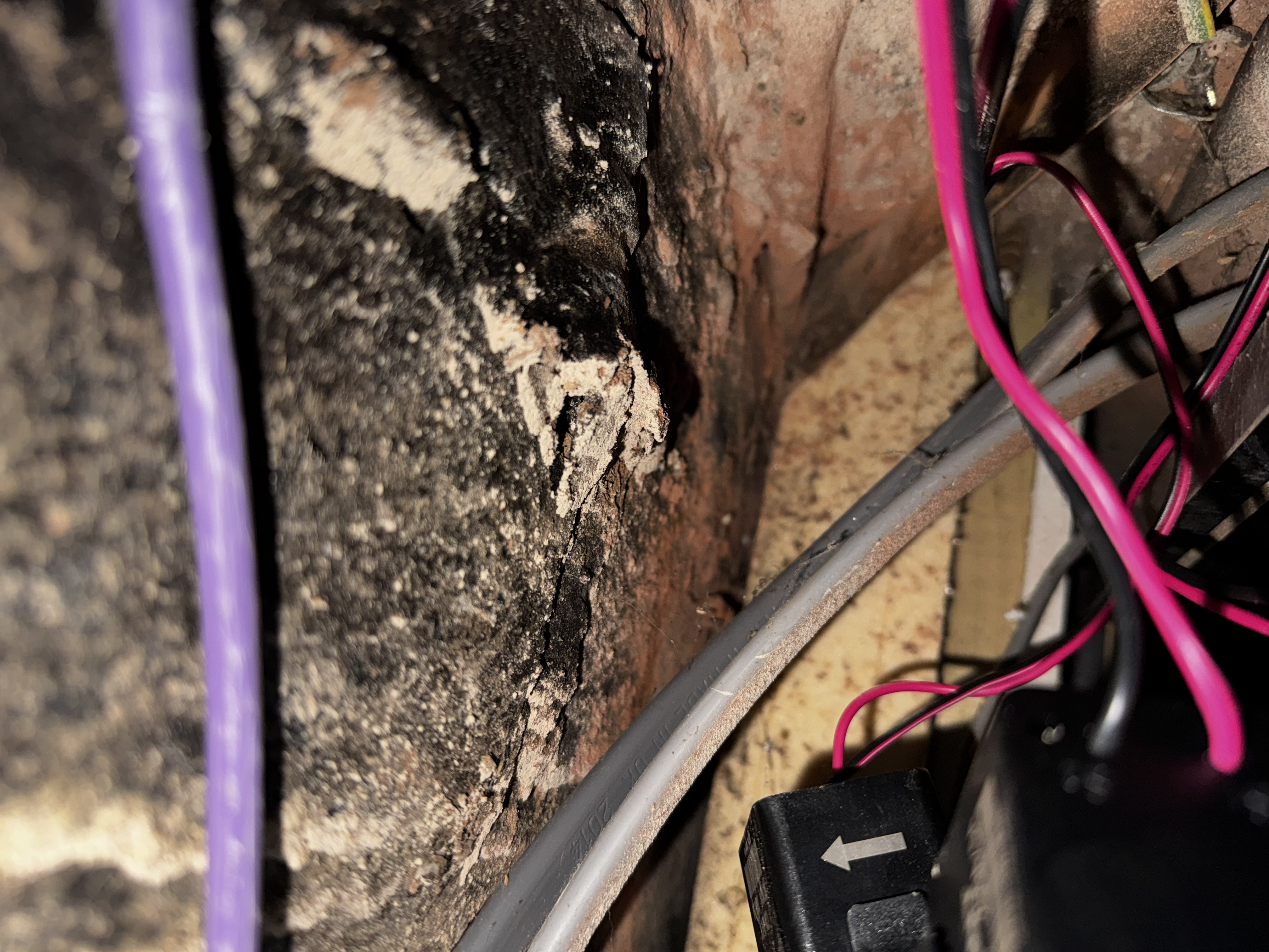

Couple pics here. Hard to get a decent angle as buried in a cupboard! The arrows point at the consumer unit.
Ok it looks to me like there is a problem, without measurements it’s difficult to identify it and i’m guessing you will need to do some testing to see explain to your installer what it is.
Do you know what appliances you have on each of the phases - really need to get methodical and trigger a good sized load (pref 1-2kW) like a full kettle or an oven, electric radiator etc.. ideally on each phase and leave it for 5 minutes to allow the data sample to be taken and see what the effect is on the Loads & meter R/S/T phases.
As this install is using CT clamps it is possible they have entered the wrong transformer ratio in the meter so when you are taking 3kW, the CT’s / meter is only measuring 2kW (you can see that above) - that could be why it’s only showing a 2kW export per phase when it knows it is delivering 3.39kW per phase and so it calculates the rest is being taken by a load.
In an ideal world what you need is to identify when a fixed load is presented on a phase, how that phase measures the load and what the effect is on other inverter phases. - the measurement will show that the transformer ratio is correct in the Chint meter, the effect on the other inverter phases will show whether they are being measured correctly i.e. L1=R, L2=S, L3=T - I would say your installer should be doing these checks, but if you can at least demonstrate a problem to them it’s easier to solve.
