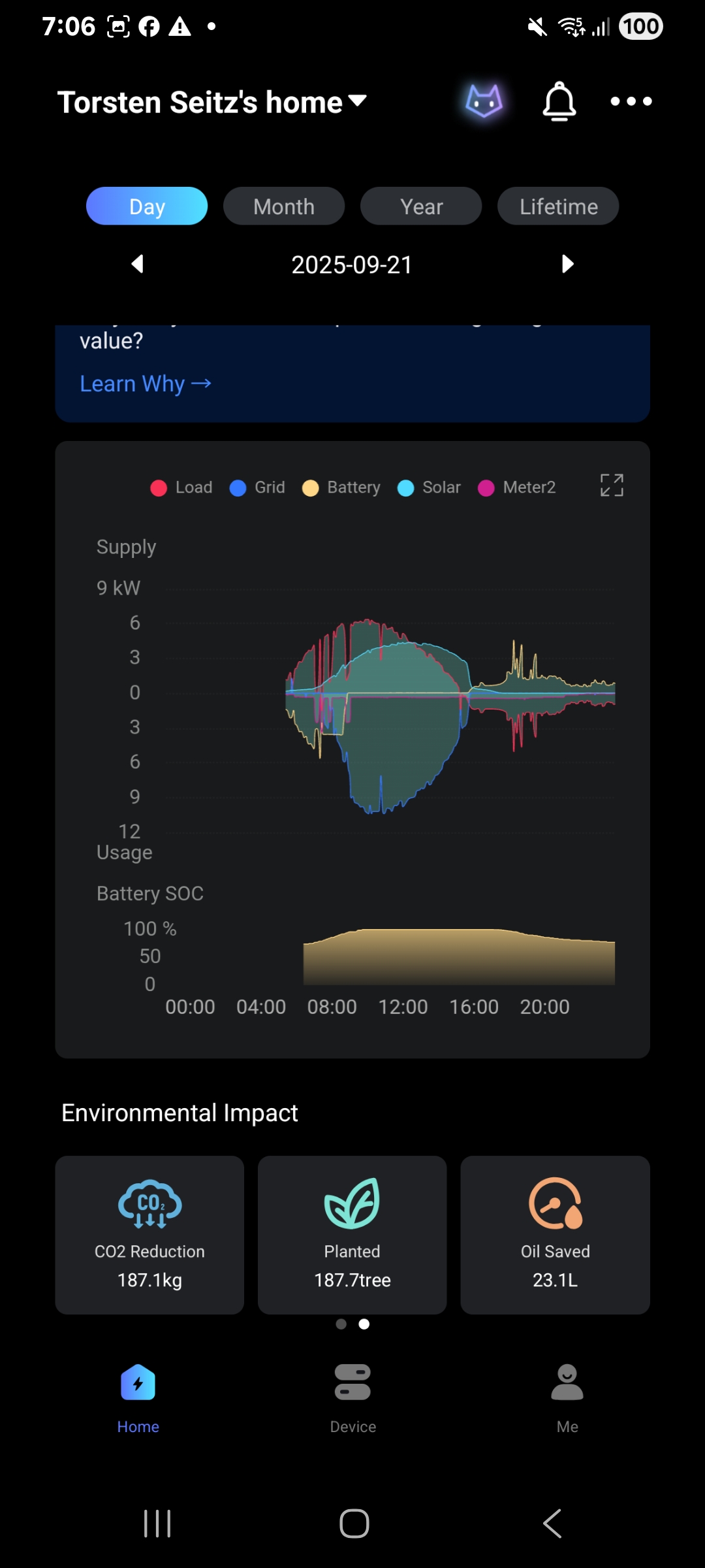

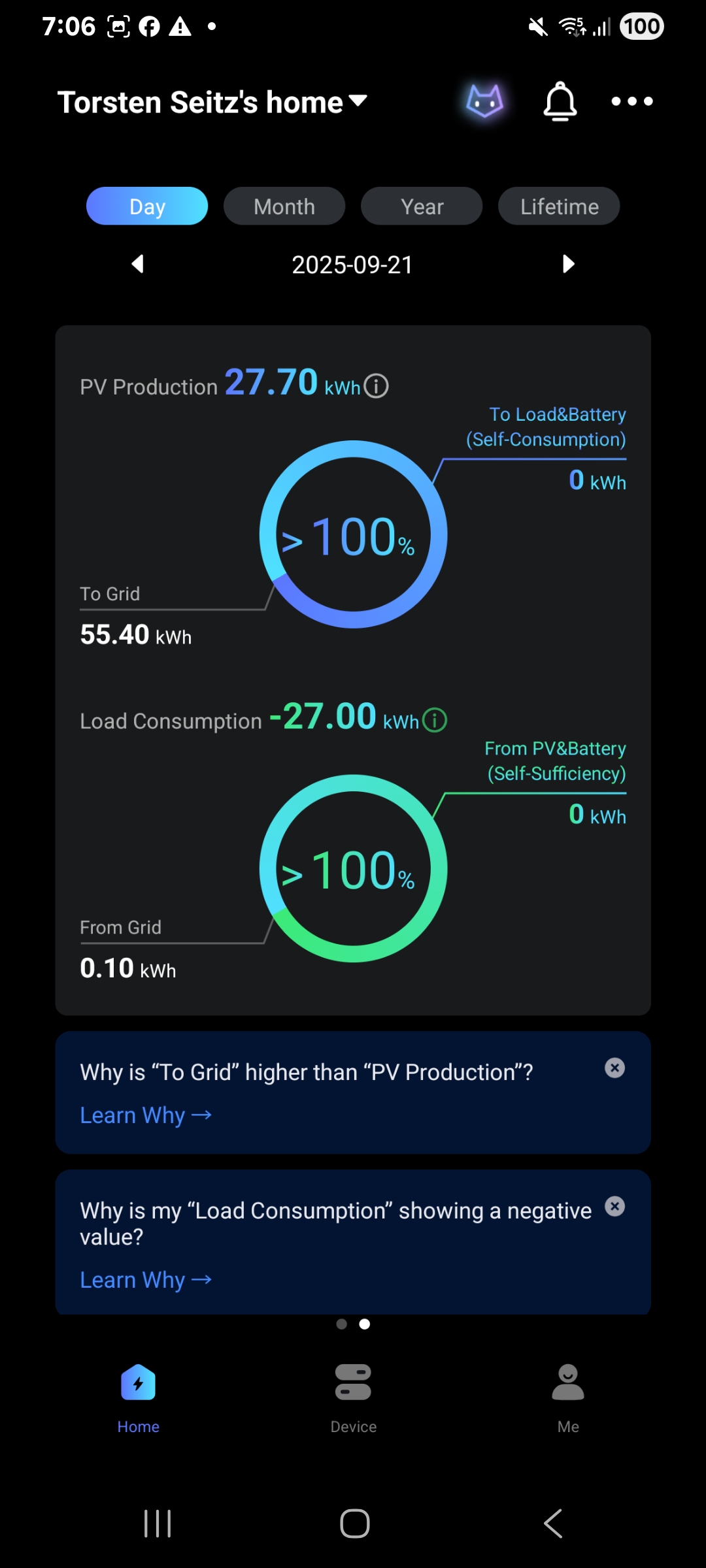

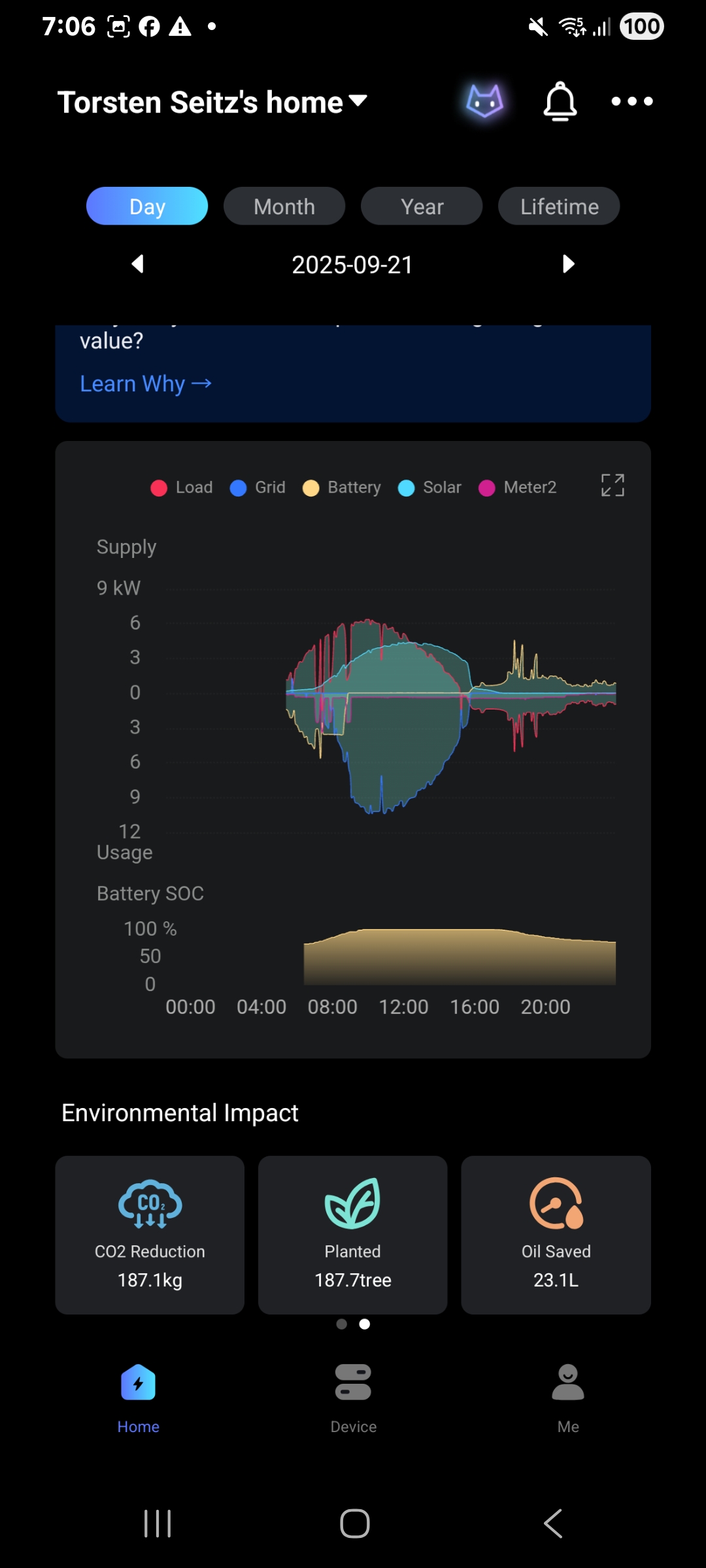

Really need to see your data, can you post the graph from the app, swipe left on the home page and screen shot the graph at the bottom of the page that shows the load, grid, battery and underneath it the battery soc.
Hi mate thanks for your reply.
I hope that these photos help.
Thanks mate
Torsten
Thanks mate
Torsten

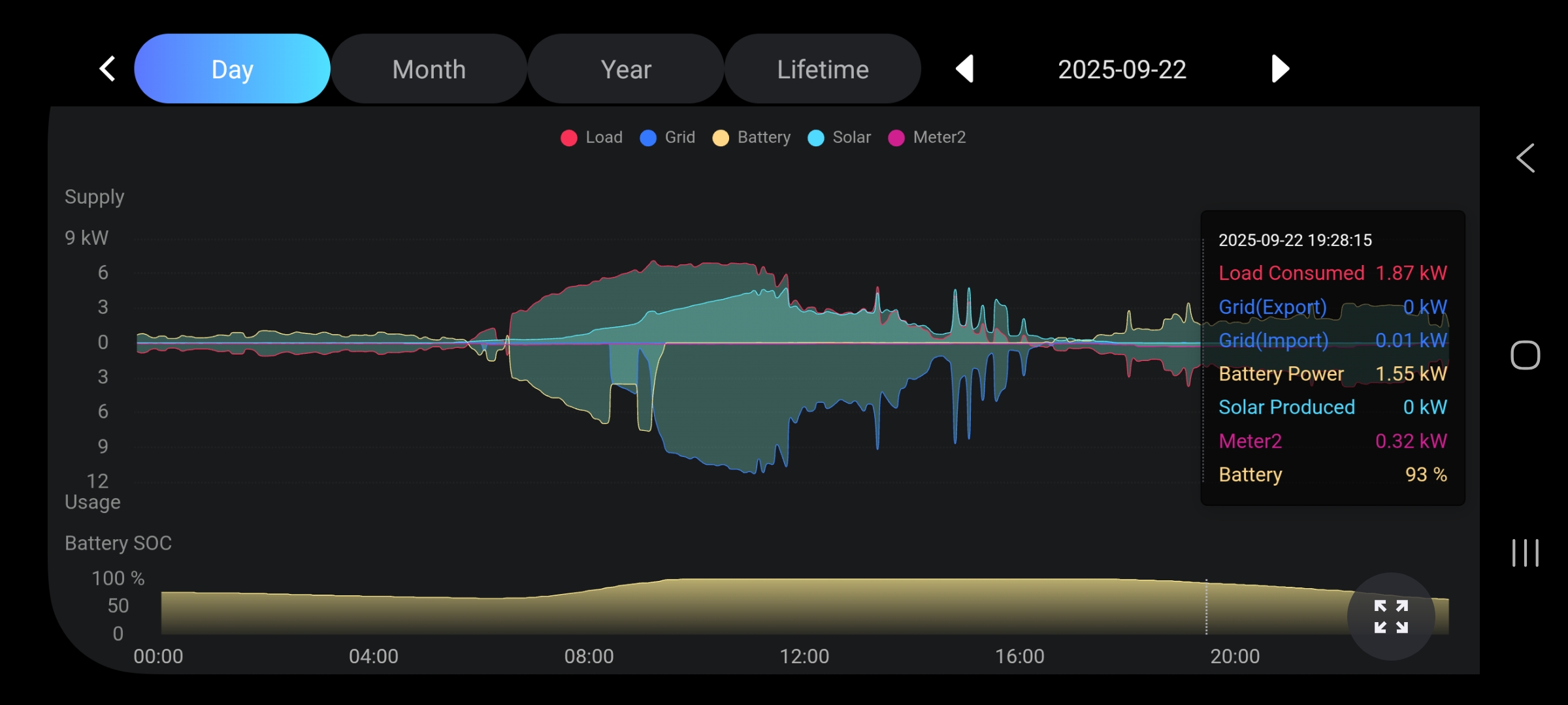

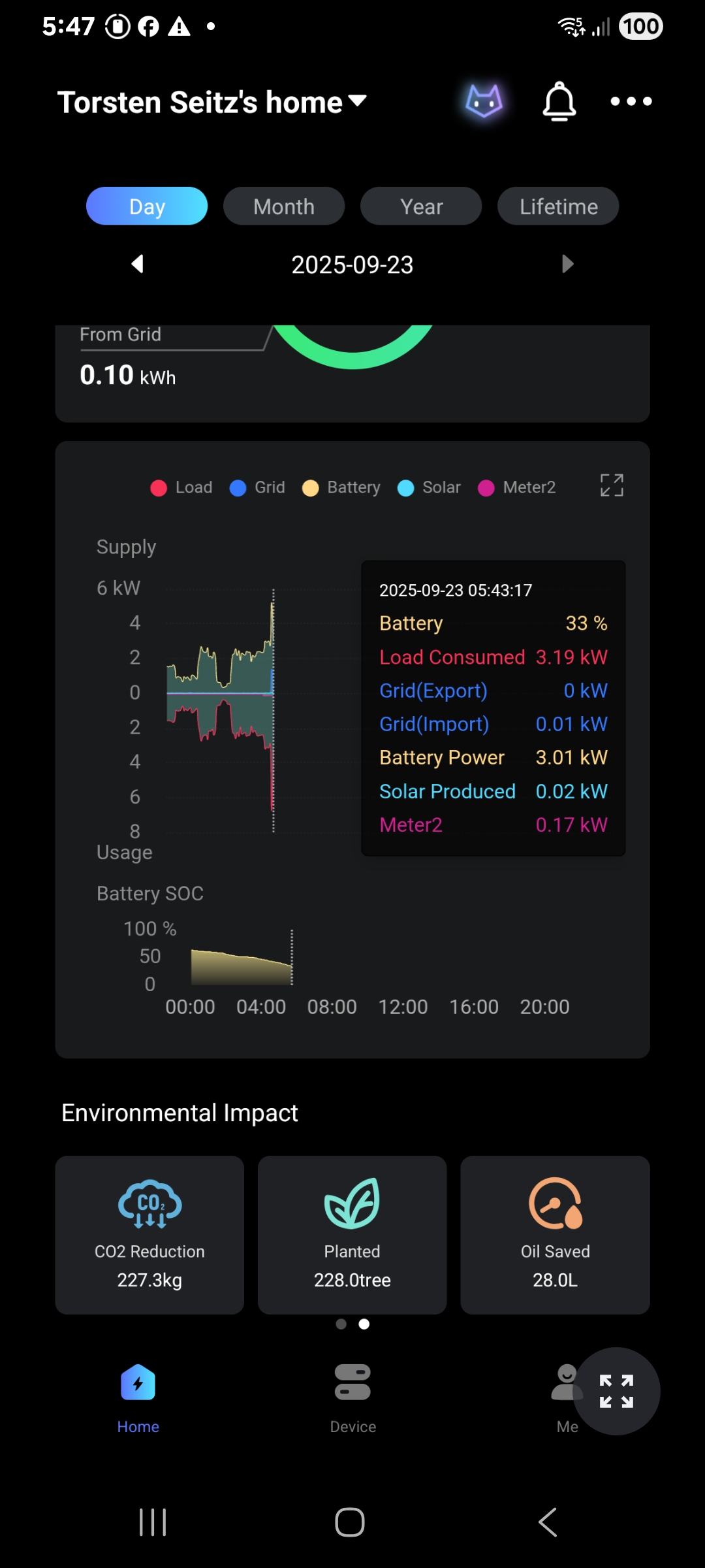

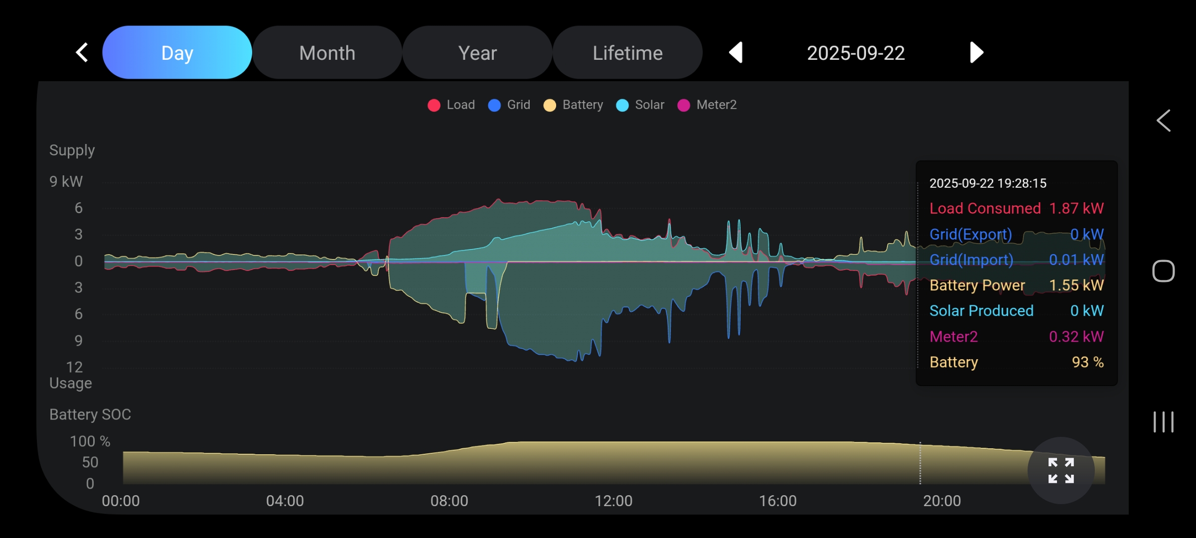

Your screenshots do not show what you're saying above. the battery is not empty by morning from what I can see.

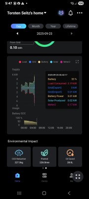

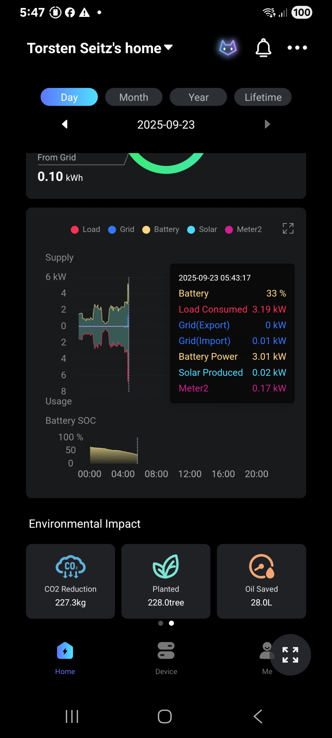

Hi Will, The first screenshot is a full 24hrs snapshot of yesterday.
The second screenshot is at 5:49 am before sunrise today.
The battery has a USABLE capacity of 33.54 kwh. On an average day at this time of year our Energy provider says we average 17kwh per day.
Is the battery capacity not as purchased, the programming incorrect or the setup incorrect?
Dave Foster wrote: ↑Sun Sep 21, 2025 3:28 pm Really need to see your data, can you post the graph from the app, swipe left on the home page and screen shot the graph at the bottom of the page that shows the load, grid, battery and underneath it the battery soc.
It’s not the easiest to tell, but that suggests your average load consumption from midnight to 05:43 appears to be just under 2kWh - so around 10kWh consumed.
Your battery has dropped from approx 65% to 33% ~ 32%, if your battery stack is 33.54 then without taking any losses into account that would suggest 10.7kW - I think you need to look at your meters and statistics and work out your average load per hour / day as that snapshot stacks up perfectly in that your battery is being used to power your load.
