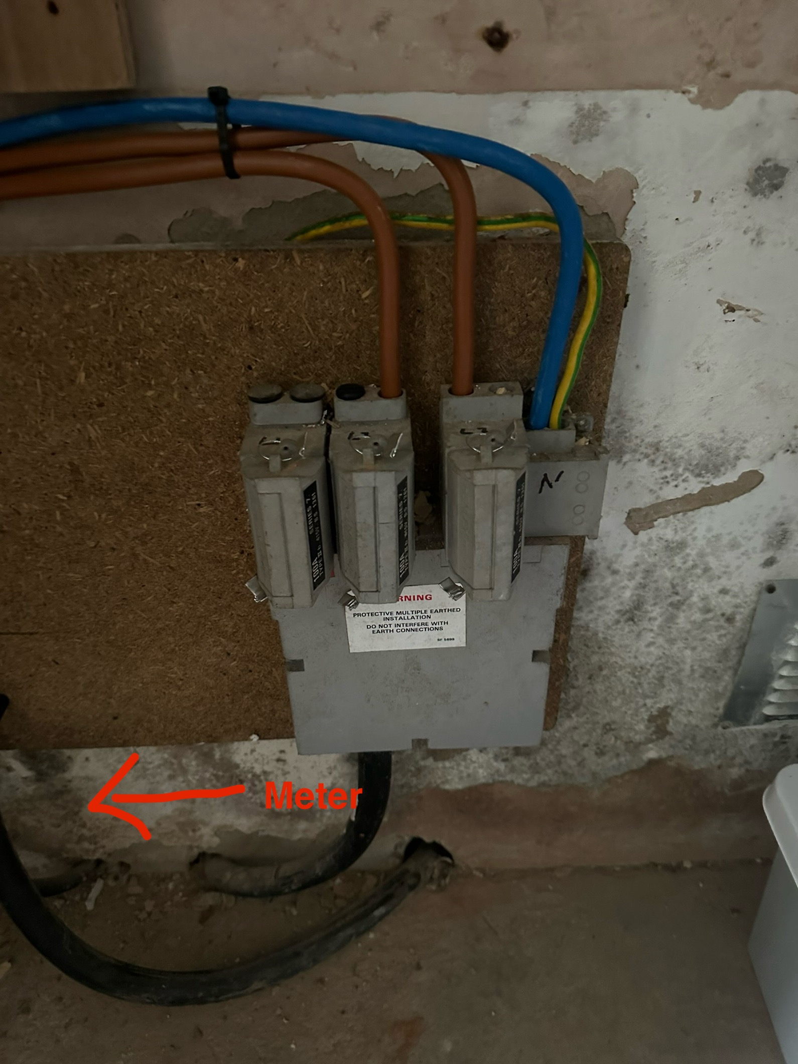

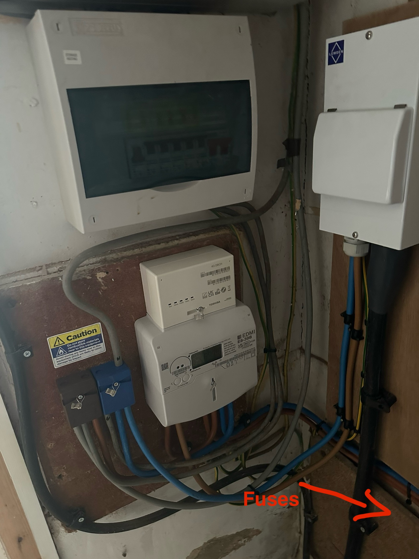

Can you upload a photo of your meter area and supply fuses and I can confirm if you are or are not 3-phase.
Your understanding of the 3-phase inverter limitations with unbalanced loads is correct, and I would push for a larger inverter if you are indeed a 3-phase consumer.

Here are the photos:
Re: Inverter power
Update: heard back from the surveyor from our DNO and we apparently have split phase. Looking into 3 phase but may be too expensive for us to upgrade!
