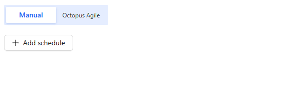

I've read some posts that suggest the Mode Scheduler should be deleted first before Grid Charging Time is used. I don't have any evidence of a Mode Schedule being set anywhere. The Mode Scheduler page simply displays 3 buttons: Manual, Octopus Agile and + Add schedule (Attachment Ess-1)

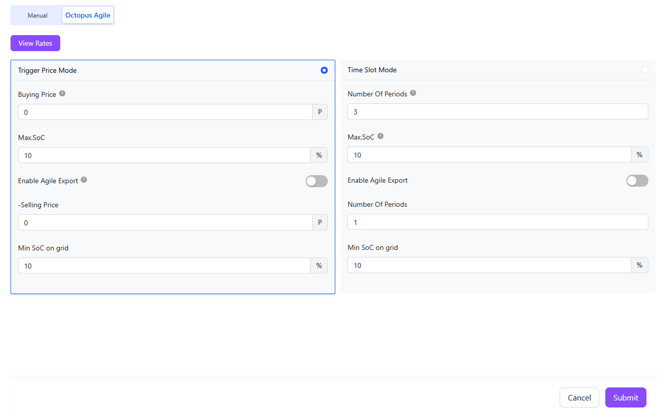

The Octoplus Agile page is shown in attachment ESS-2. The blue box around Trigger Price Mode can never be moved to surround the Time Slot Mode. Now Submitting this page displays error "40257-Parameters do not meet expectations. Please reenter"
