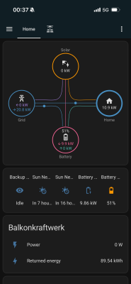

Screenshot Homeassistant charging Car and battery
Great community.
