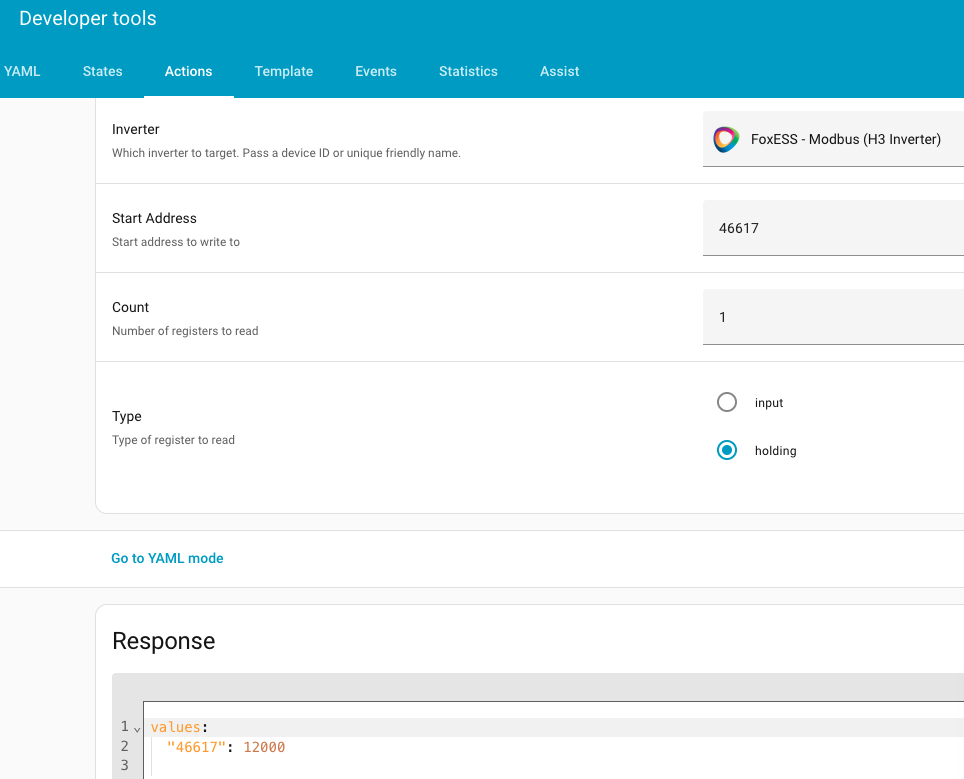

Firstly I was able to read from address 46617 from modbus poll. I used the ip of the ModbusTCP/485 converter 192.168.3.43 and server port 502 under connection settings.
Under the read/write definitions I used slave ID 247, Function 03 Read Holding registers, address:46617 and quantity 1 and rows 10 and read the value 22000 from address 46617. Can confirm this also worked using the fox integratoin by "nathanmarlor".

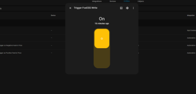

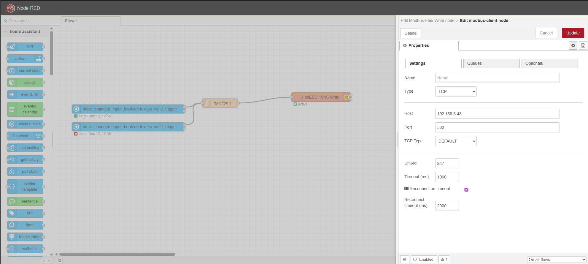

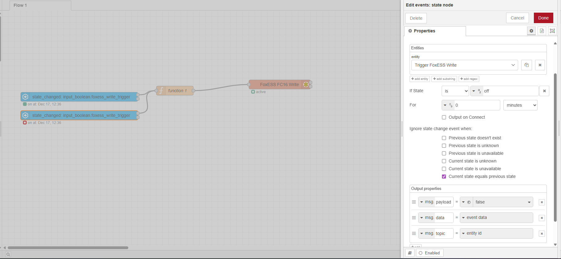

Anyways I ended up using nodeRed, both the addon and Hac's Node-RED Companion.

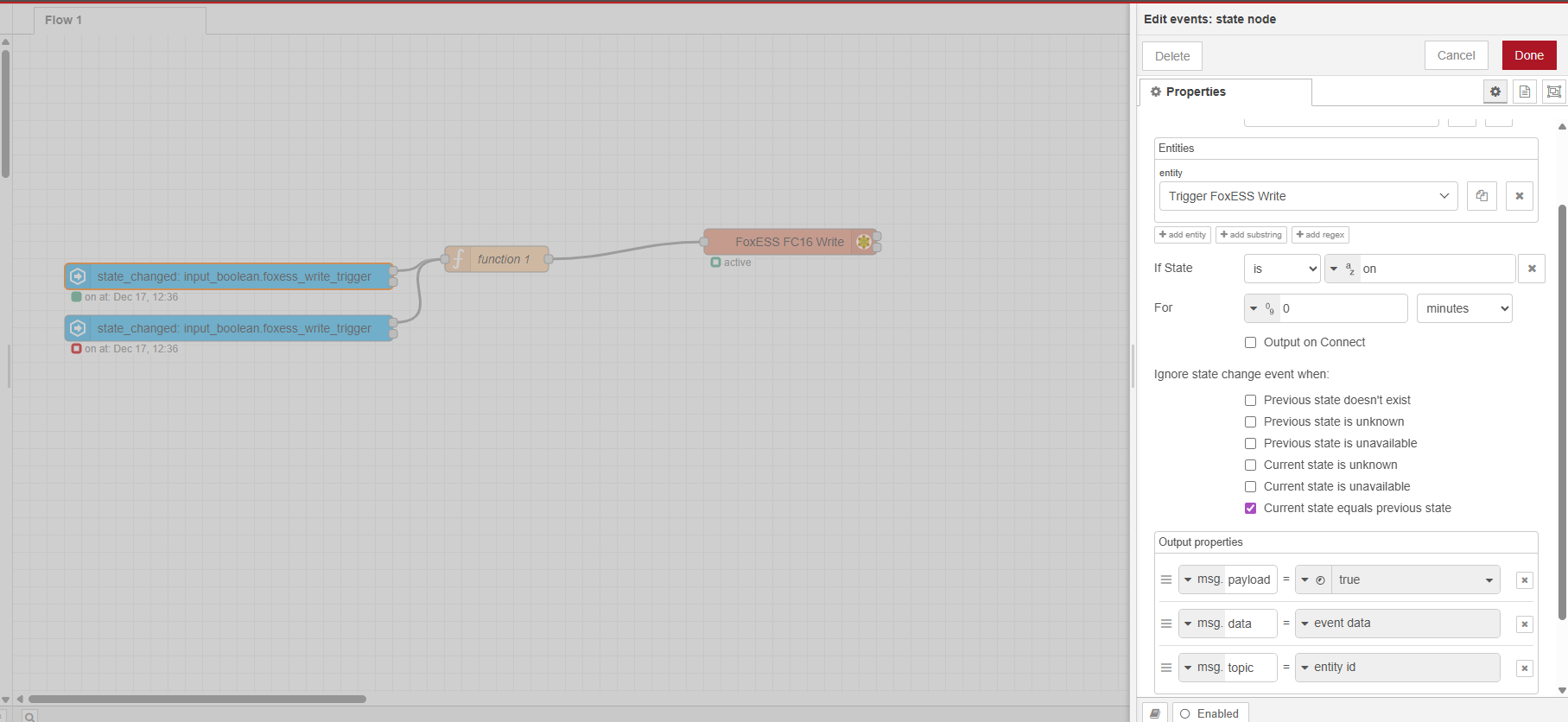

I used the home assistant node "events:state" at the start, this is used to trigger the nodered function from a home assistant integration. I actual used two of them, one gets turned on to write 22000W to the address and when the other gets turned on it writes 0W to the address.

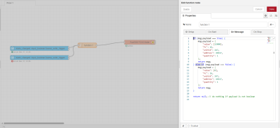

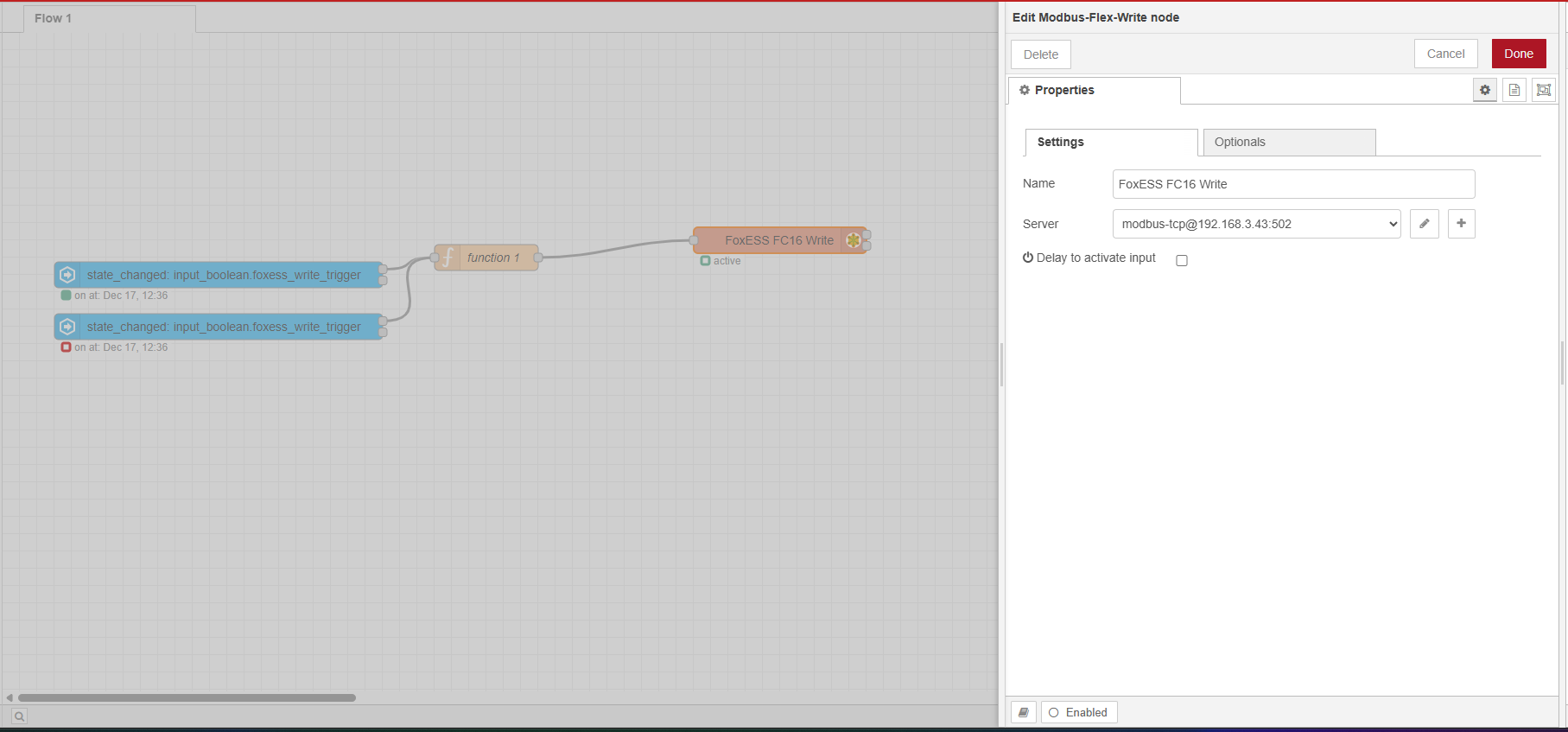

These two then feed a function block which passes the address information, function code, slave id, and qantity to a node called "Modbus-Flex-Write Node"
The code in the function block is:
if (msg.payload === true) {
msg.payload = {
"value": [22000],
"fc": 16,
"unitid": 247,
"address": 46617,
"quantity": 1
return msg;
} else if (msg.payload === false) {
msg.payload = {
"value": [0],
"fc": 16,
"unitid": 247,
"address": 46617,
"quantity": 1
return msg;
return null; // do nothing if payload is not boolean
And I have attached some pictures, hopfull this is helpfull to someone
