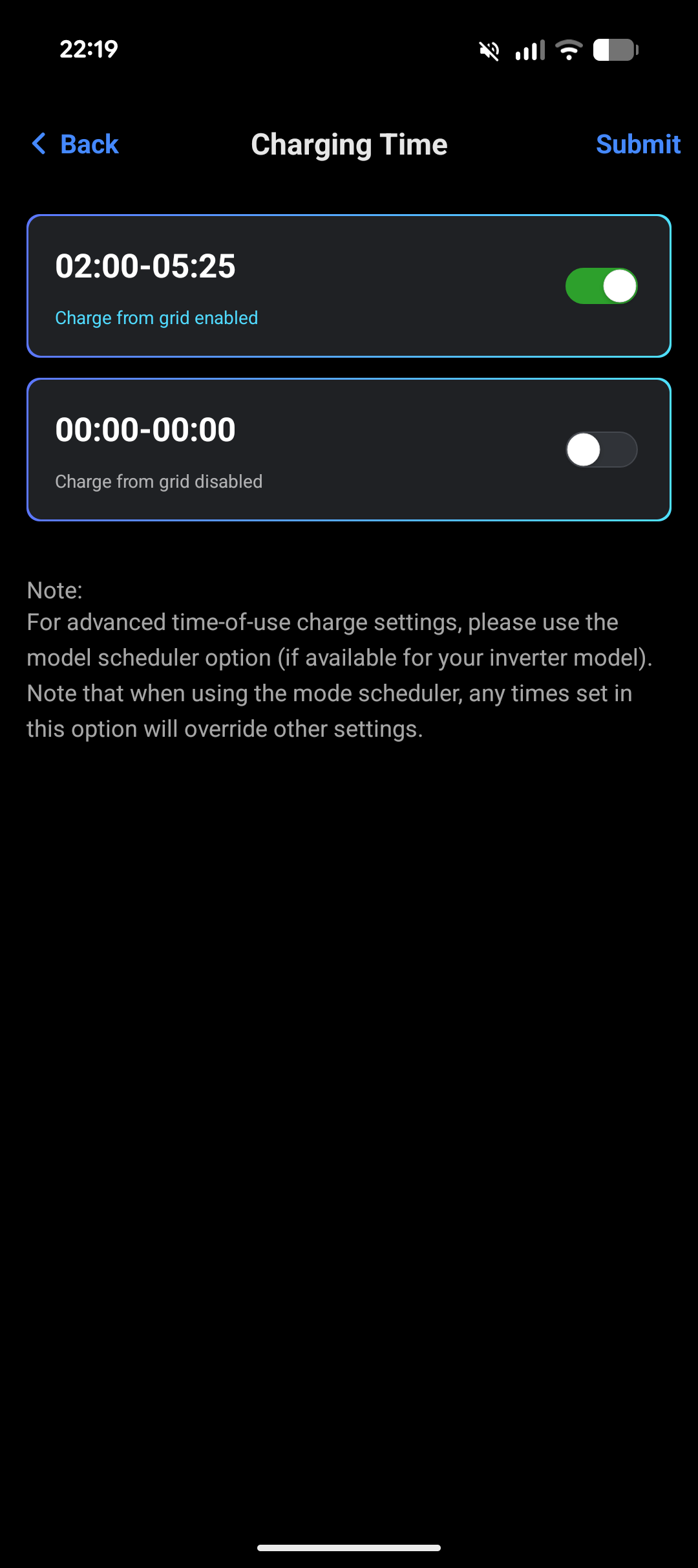

Hi, when I use mode scheduler as below force discharge works but force charge doesn't.
The only way I can get it to work is to use force charge via charging time window, and force discharge via mode scheduler, turning one on and the other off.
How do I get both to work via mode scheduler?

Your first picture is for Grid Charge, so this only has brute force of charging the battery... so turn that off and use the manual scheduler options so you take more control of your system.
