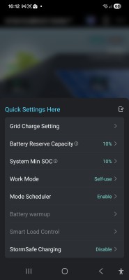

Manual Mode Scheduler started off indicating "Disable".
Was experimenting with Manual Mode Scheduler and put in some time frames. Now have deleted the schedules, but Manual Mode Scheduler still indicates "Enable".

This was a PITA to fix. Essentially you cannot fix it on the mobile app.
Here is how I fixed it.
1. Had to do it using the online web app > Go to Quick Settings > Mode Scheduler
2. Remove all schedules then create a new blank one from 00:00-23:59
3. Disable this schedule
4. Submit
5. Mode Scheduler is "Disabled"
6. Now I can use Grid Charge Settings again without error.

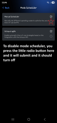

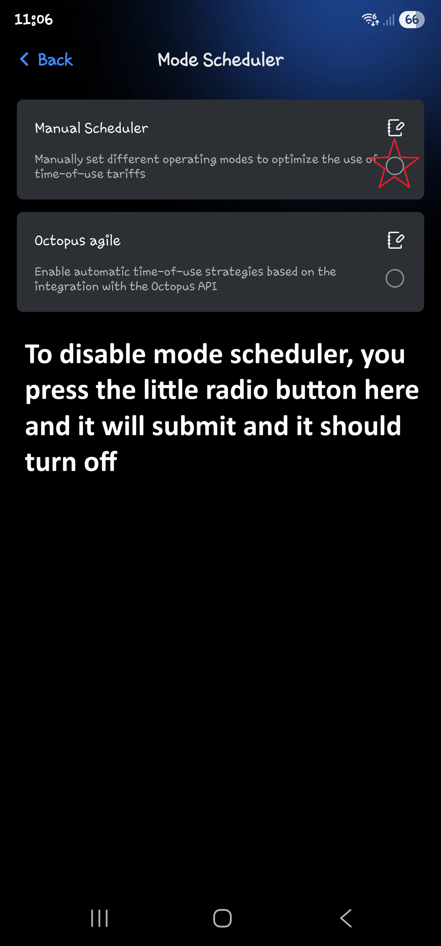

Here is a shorter method to disable the Manual Mode Scheduler.

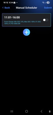

Materialbaracuda48. Thanks for your input. That setting might only apply to UK. I am in Aus and don't have that setting.
Here is what I see. Even when you toggle off and Submit, the Mode Schedule stays on.
Re: FIXED: Cannot disable Manual Mode Scheduler
What does your page before this show?
I guess we have an extra screen as we have Octopus Agile as an extra choice in the UK.
So your work around, does the trick for Aus users, so a good find and write up for others to find.
