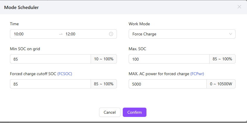

Hi Community. Can someone help me understand the settings in the Mode Scheduler. Here is what I am trying to achieve....
Between 11am-4pm I want the battery to always remain above 60%SOC. If the battery drops below 60% I want to force charge from the mains until it gets to 80%SOC. When it reaches 80%SOC, it should revert back to normal (Self-Use mode). What are the settings to make this happen?

Re: Mode Scheduler
Posted: Sun Dec 21, 2025 10:00 am
by Dave Foster
The mode scheduler doesn't quite give you that ability, but, you can set a work mode of Backup with minSoC of 60% and it will hold the battery at 60% top charging if needed, or you can set your inverter to Self-Use with a minSoC of 60% which it will maintain that and any excess solar will go into the battery, or you can set your inverter to Feed-in with a minSoC of 60% and it will maintain that with excess solar going to the grid.
You could add into that mix setting MaxSoC to 80% but the results can be a bit random depending on your firmware versions, and sometimes it results in your PV production being shut down when it reaches maxsoc... not what you want.
To get that granular ability you would need to setup a home assistant which allows you to control most inverter functions even complex ones.

I am on the web version 2. It will not allow me to place 60% in the "Min SOC on grid" field.
I get an error.
