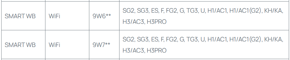

Would I be correct in assuming my 'W6' datalogger is not compatible? The chart in the linked article lists the integrated Wilan, the Wifi 5.0/smart WB, and Wifi+lan/Wlan-WW.
Re: 5 second updates in app / compatible firmware and inverters
https://fox-ess.tech/datalogger-wifi-la ... atibility/
It will depend on your serial number, my W6 starts 609W6*********
So it is a W6 aka Smart WB

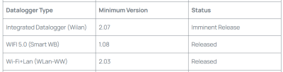

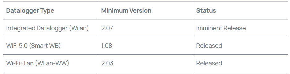

Looking at the list on your link, I just need a FW upgrade from 1.04 to 1.08 for this to work (Inverter is ready to go)

I can confirm that my W6 aka Smart WB WiFi dongle has just had the v1.08 FW applied, and it is giving me 5sec data snapshots in the Fox Cloud 2.0 App.
FYI: Information for anyone that reads this
Fox Cloud Website v1 = Does not update in realtime (5s)
Fox Cloud Website v2 = Does update in realtime (5s)
Fox Cloud App 2.0 = Does update in realtime (5s)
